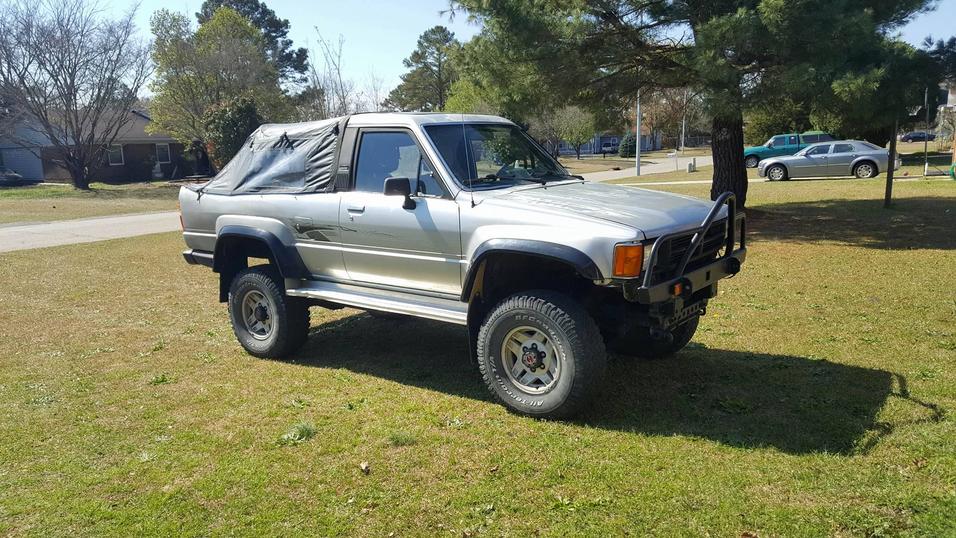

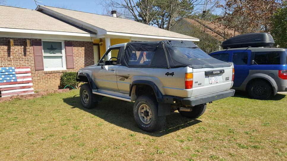

3rd gen rear coils for "Zuk mod". 1.5" BJ spacer and torsions adjusted accordingly. 2012 4runner trail edition rims with Yokohama Geolander AT 265/70/17
It looks perfect. Grey with black cover top and red with black cover top, my favorites, I can't decide the color I'm going to paint mine. For sure the cover top'll be black :)
Cut or no cut zuk mod?
Thank you! No cut ZUK with 3rd gen coils. I actually want to take it back to factory color of silver. I do like the gunmetal but i have these chameleon graphics on it i'm not too fond of.
Full OME kit with 3/4" BJ spacers up front. Still rub slightly so I need to crank the torsion bars up for another 1"

Here is my 87 with 3" Body lift and 32x11.50r15s on stock wheels. Slightly cranked torsion bars and zuk mod rear. I despise the body lift and would really like a way to hide it. or make it more presentable. Removing the lift seems like a huge pain in the ass. I have a set of 305/70r16s on 16x8 steelies with 4.25" Back spacing. I removing the side steps in the morning. Any help with hiding or making the body lift less noticeable or more presentable would be awesome. Also are there any bumpers out there that cater to body lifted yotas? Hope the pics come through.

Lift is in, omega all the way around with a differential drop. Still working on new wheels but one step at a time.

Finally got it an alignment. Cranked another 1" of torsion along with the previously installed 3/4" BJ spacers to level the front. No more rubbing. ~15 1/4" from top of the front wheel's edge vertically straight up to the fender, if someone is curious to know.
ball joint spacer lift up front with torsion crank and 1" diff drop spacers. rear lift is OME rear leafs ( ride is rough as shit!!)
tires are 32" no rub at all
NEW TIRES. KUMHO ROAD VENTURE M/T 32X11.50X15
Original paint? Or did you find someone to replicate the decals? Thanks
original paint on all panels. has dings that im thinking of having ding doctor fix so i dont have to repaint. the paint is in very good shape even on roof. the guy who had it prior to me had it 21 years and garaged it most time.
the decals are little aged and faded considering the age but still in good shape. i was going to buy new decals from james dean creations that makes all the classic toyota decals, but decided to wait till i figure out what im going to do with the dings and such. click below on the link if you are interested in any classic toyota decals.
