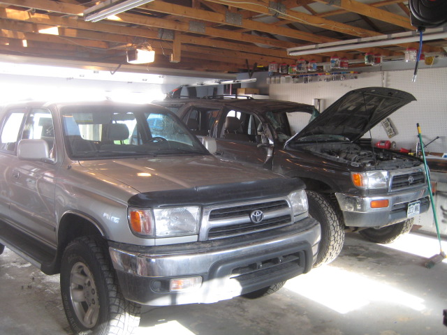

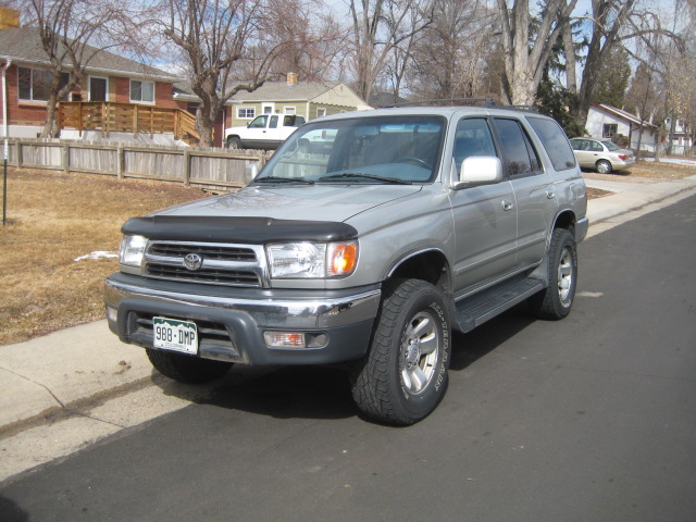

Anyhoo, here's the '99:

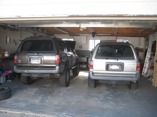

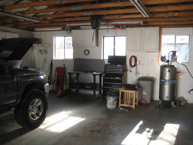

The first step in this project was to clean out the garage. This may not look too clean to you, but you should have seen it a month ago!
The second step was to convince my wife to park on the street.

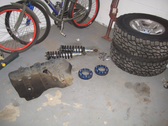

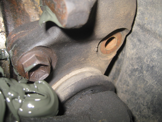

Much to my surprise, apparently rolling a 4runner at 45mph is not good for the LBJ's. One of my bolts sheared off.

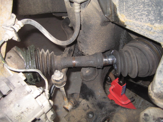

I also had a torn boot on one of my CV's. I bought a re-boot kit thinking I would use it as a spare, but I guess the roll shredded the other boot as well.

I was really looking forward to having air tools to make this job go quicker, but my air compressor crapped out on me this morning. I spent about 2 hours looking at it, scratching my head and electrocuting myself trying to re-wire it before I gave up. A couple more hours of wrenching and cursing, and some parts fell off the truck.

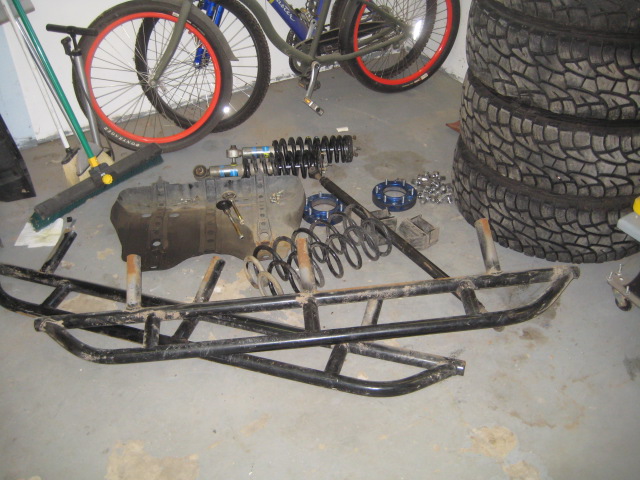

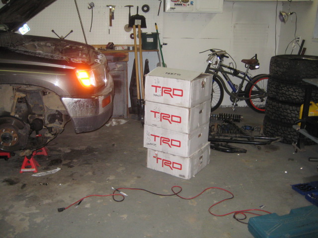

Well I went ahead and set the Tundra struts to the 3rd notch. Hopefully it works out OK. I can feel there was a lot of tension in the springs :/
I was also unable to get my LC shocks off the rear. I really want to shoot whoever designed the rear upper shock mount on these trucks. Holy crap, what a shit-show. So unless by some miracle, they fall off the truck on their own, I think I'm going to send these perfectly good LC shocks to the scrap yard with my old truck :(

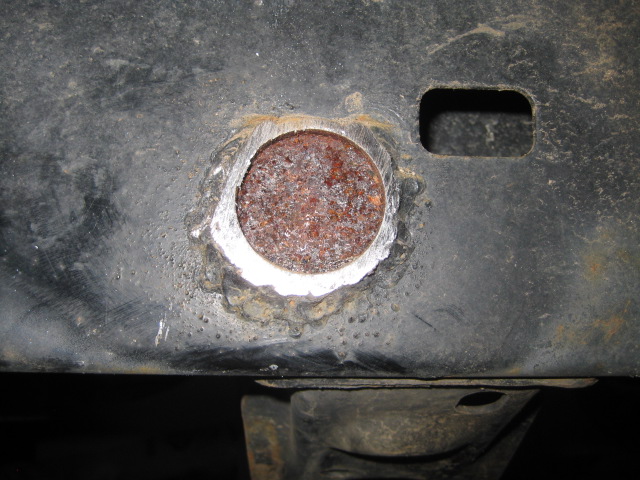

I was also surprised to find a fair amount of rust inside my sliders where I welded them to the frame. I'm not sure how that is possible since I'm pretty sure there was no moisture in there. Oh well. You can see what a crappy job I did painting them. :/ I would also just like to say, the sawzall is a god among tools.
Aside from that, today was semi-productive. Mainly just pulling parts off the old truck. My pile got a little bigger :o

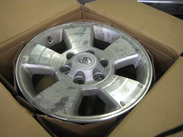

Just teasing with the TRD boxes :o They're just 4th Gen/Tacoma wheels. I've got my eyes on a set of 315 duratracs. Hopefully they're still available this weekend :)

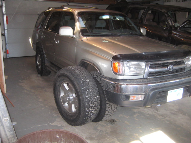

Just a word of wisdom. I saw you have spacers on the stock 16's. I'd assume you're running them again with these but the taco wheels have a higher offset. You might need to compensate with a larger spacer if going up to 315's. I'm not a pro but just words for consideration.
The offset (15mm) change means you're adding just under 2/3rds of an inch backspace.
Thanks for the pointer. I wasn't sure about the offset, but I will definitely do some test-fitting before I mount them up. I may put my current spacers in the rear and get bigger ones up front if necessary. On the plus side, the wheels were cheap!
Well, the duratracs I had my eye on ended up selling before I could get my hands on them. But thanks to all the Todds driving Hummers, I was able to find multiple sets of used BFG's, so I picked some up yesterday. I was looking forward to trying out the duratracs, but I ran BFG's on two of my previous rigs and they worked out great for me, so no worries. 315/70-17. I think it will fit :o
