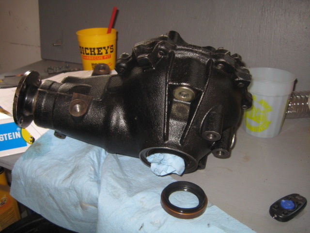

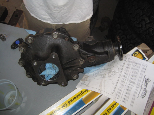

Just a quick photo update. :) New front diff with Yukon ring and pinion

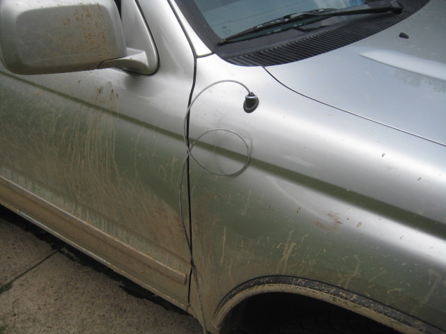

Not really much of an update, but I went to my buddy's cabin and did some night wheeling in the rain. My power antenna was mortally wounded in the car wash about a month ago. And after this trip, it was dealt it's death blow. :o
