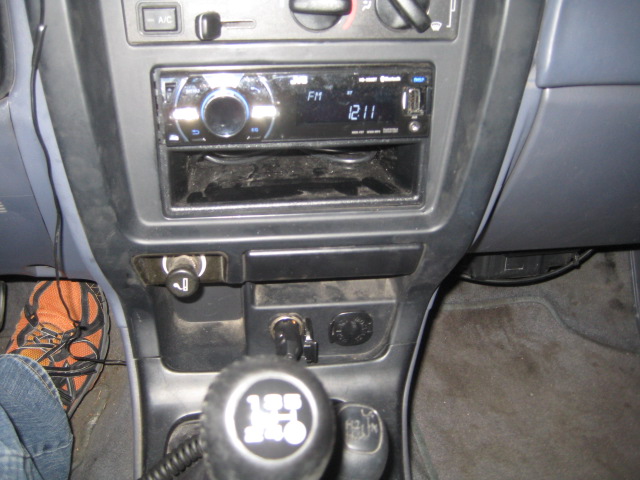

In other news, we're taking a trip to Salida for my buddy's wedding this weekend, so my wife insisted I swap the stereo over. I had to bust out what was left of the windshield and pry the dash away from the A-pillar to get my bluetooth microphone out. :/

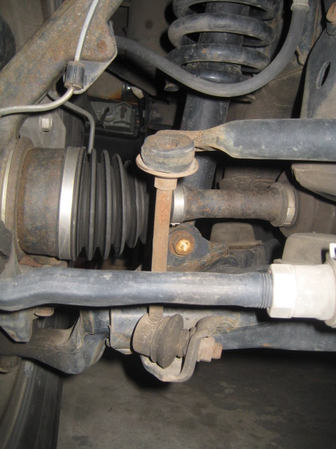

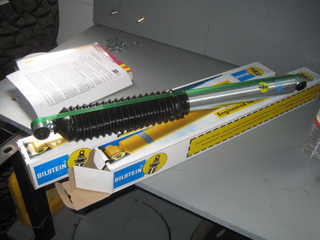

Apparently I'm too busy to work on the truck. Today I just did an oil change and took off the running boards. I also discovered a little surprise - busted front sway bar endlink (thankfully I had a spare on hand). I thought the handling was a little sloppy lately. :/ I also got my rear shocks in the mail last week.

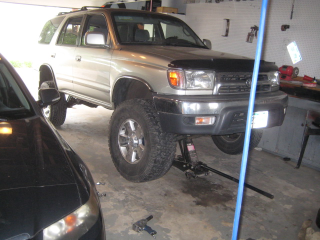

Well I was supposed to go to the Great Sand Dunes this weekend with my parents, but our photo shoot location is still snowed in (my stepdad is a semi-pro landscape photographer). So I actually had some time to work on the truck this weekend. I had a few friends over to help out.

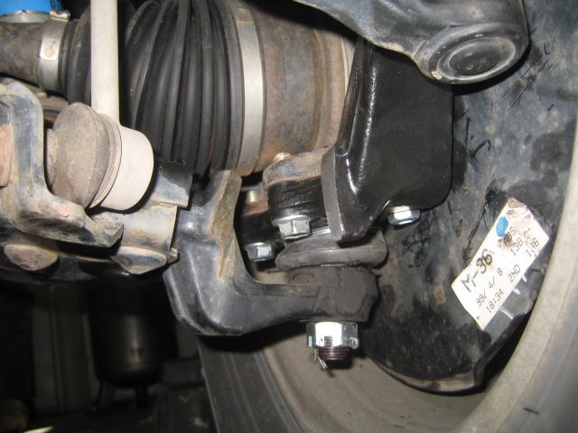

Installed my lift (third perch on the tundra bilsteins) and new LBJ's that I had sitting in the garage for nearly a year. That includes $18 worth of genuine Toyota LBJ bolts :o

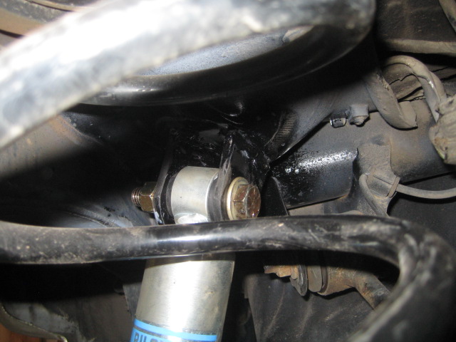

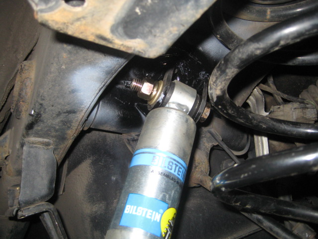

This is what I came up with for the rear shocks. I will never touch a stock toyota upper shock mount again. In your face, Toyota engineers! Plus it was free. :D
Yes my welds are ugly. My buddy's welds were a little better :o I think I'm just going to let the 80-series tokicos go to the junk yard. :/

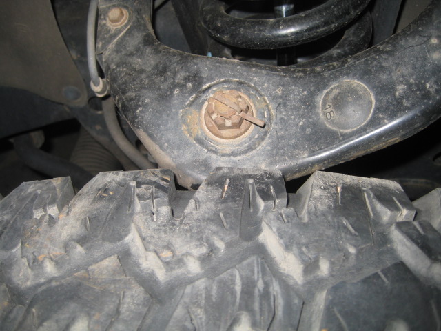

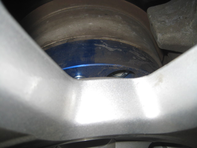

Well, it turns out Robb1887 was right to warn me about the offset on these wheels. I tried a test-fit today and as you can see, the tire contacts the UCA, and there is still a good 1/4" to 1/2" before the wheel will bolt up to the spacer. I have not gotten an alignment yet, but I imagine this will be even worse once they fix the positive camber I have going right now. So I'll probably need a 2" spacer to make these wheels fit with the 315's. That on top of the cost to re-gear, and I'm considering running my Coopers for a while longer :(
I like being right.... But I don't like that I am right about that. Get some trail editions like I did... The fit nice :)
So to be clear, you have full Tundra TRD assemblies up front, LC coils and bilsteins in the rear, right? I'd love to see better pictures of the old vs. new rear upper shock mounts, too, if you have them. Interested in going this way myself.
