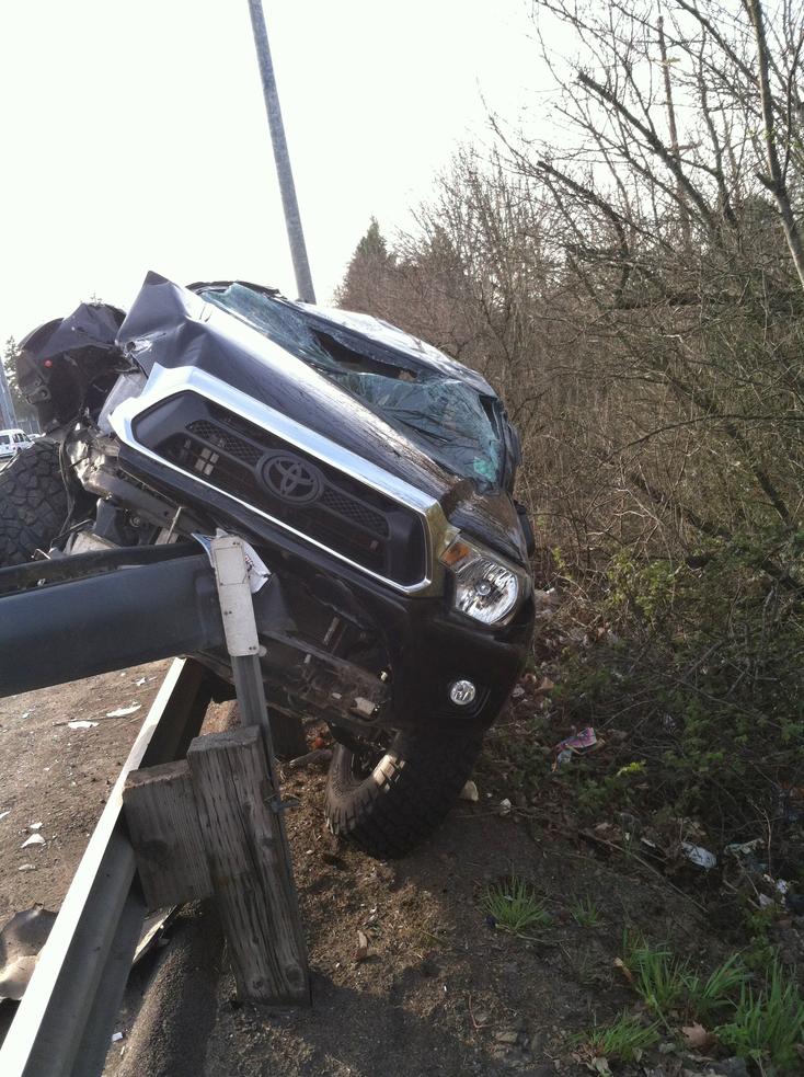

My wife does crash injury potential work for a consulting firm and she tells me stories about car accidents where loose cargo is the cause for injuries and deaths as opposed to the actual car accident itself...........vy cargo.
I always feel the need to comment when I read these because of what I experienced with my son at the age of 4. I just got off work, did my physical therapy and had my bags just sitting in the front seat. Picked up my son and strapped him into the booster seat. As we merged onto the freeway a vehicle didn't speed up, i was trying to get over and ended up flipping the truck 4-6 times along the freeway at 60mph. Long story short we walked away, still had him closely examined by the hospital for safety but my bag went flying during the accident and actually hit me, cutting/bruising me up pretty good. Just wanted to chime in that it is a common issue unfortunately :(
But we walked away from this......

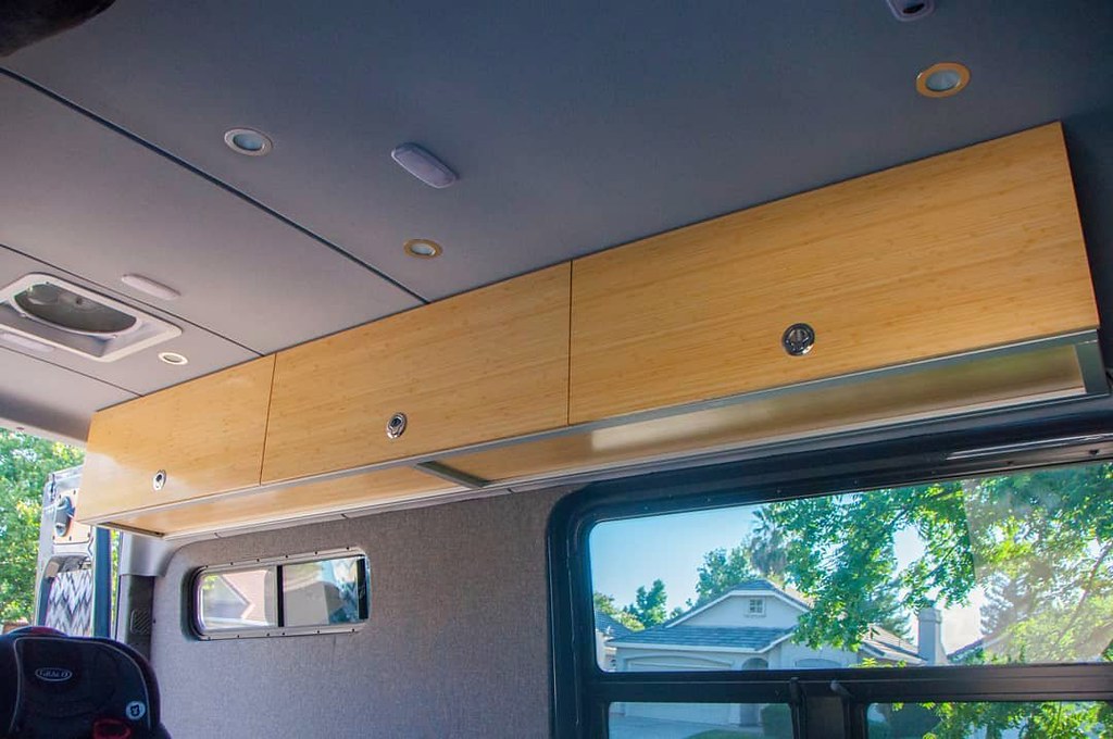

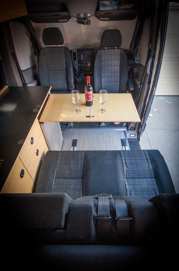

Look who's back. I've been focusing on another project the past two years, building a Sprinter van for taking long summer trips.
If you're not sure what a Sprinter is, it's likely FedEx is driving one to your house everytime you order a fun mod for your 4Runner.

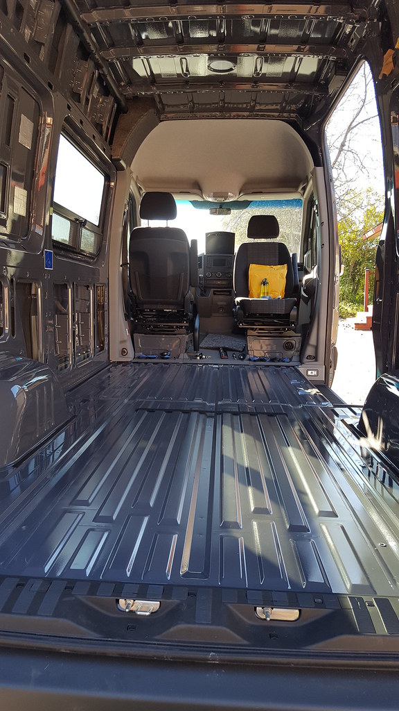

This is how it looked inside the day I bought it:

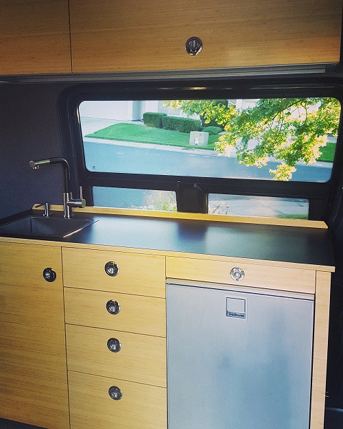

And after a few mods:
But you guys don't care about vans, so next post will include 4Runner content.

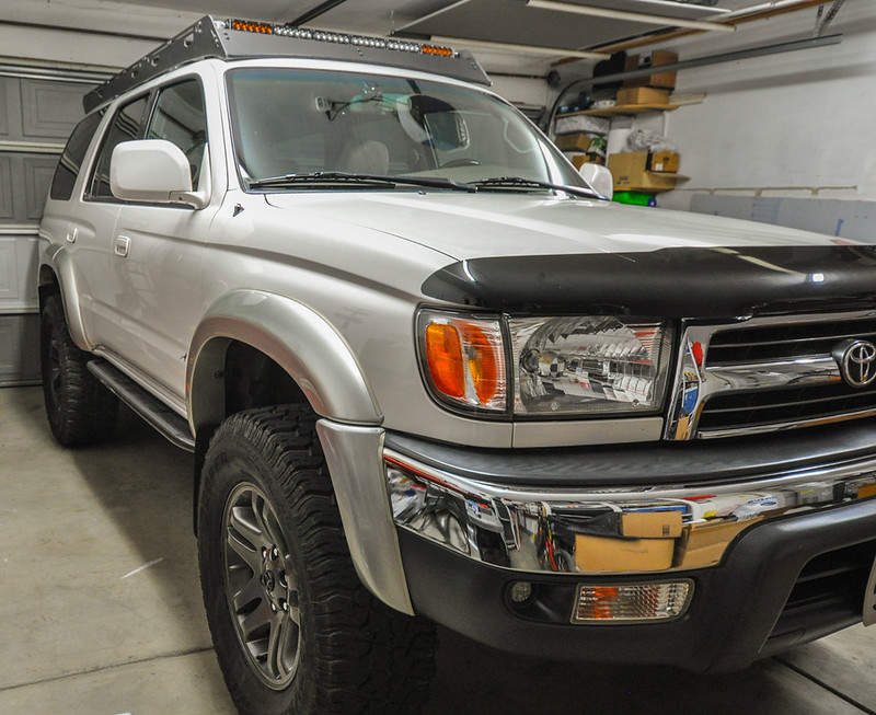

Here's how she looks these days. Exactly the same as in 2005 when I did all my initial modifications:

Paddlenbike, glad to see you back on here. Nice Sprinter. Did you build cabinets and storage or pay someone? Either way it turned out great.

Thanks Durwin! I built them myself. I used 80/20 extruded aluminum to frame them, then used bamboo drawers and cabinet doors to cover the aluminum. I have more info on my website if you're interested. https://ourkaravan.com

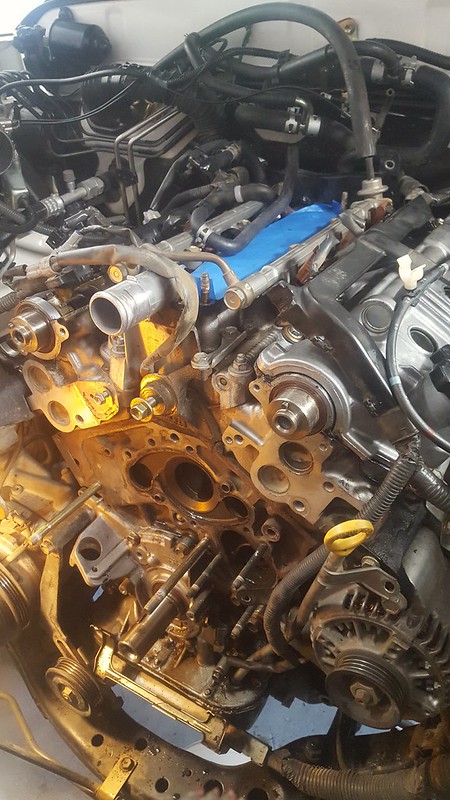

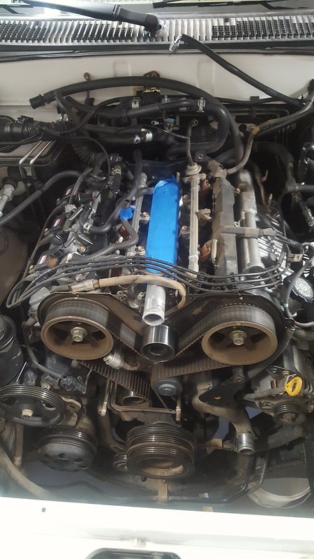

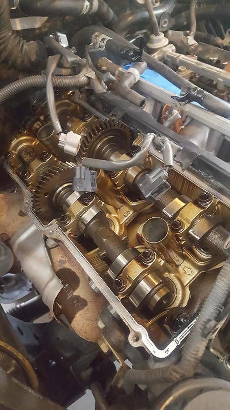

Current Status: 160,000 miles and the most everything on the engine is original. It's time for a complete timing belt and valve cover job.
It took me nearly a month to get all the parts together and find time to get this big project started. There are a lot of parts that should be replaced, and ones you wouldn't even think of such as the crankshaft pulley bolt. I am not known to be the fastest worker but it took me about 2.5 hours to get the skid plates off, the coolant drained and the supercharger off the top of the engine.
You can see that the starting point was pretty clean. For being an original 160,000 mile engine there really wasn't much in the way of an oily mess. I found some oil near the bottom of the engine in the vicinity of the oil dipstick tube, otherwise it looked pretty good.

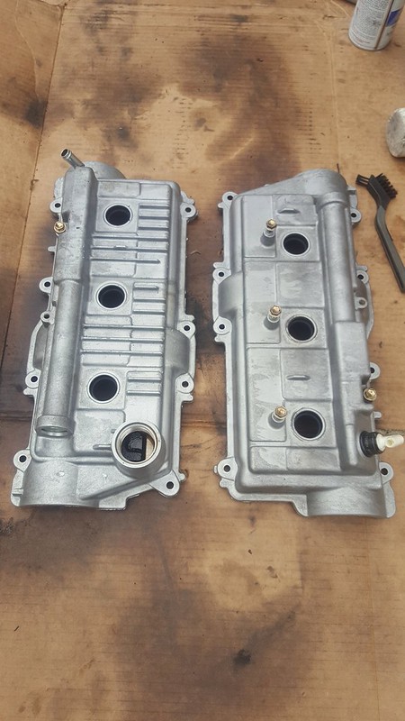

I am finding that the valve cover gasket job is nearly as time consuming as the timing belt job. Most of that is taking the time to clean up the valve covers, install the spark plug grommets and mostly cleaning up and re-sealing the half-moon washers and the rear cam plugs.
Other than some initial confusion about where to place the FIPG on the half-moons and the cam plugs, the valve cover gasket job was fairly straight-forward. I simply followed Toyota's recommendation on where to put the FIPG, although I know some people add it in other places too.
Beyond the items I mentioned above and the valve cover gaskets, I also did a new PCV valve and grommet, new spark plug tube gaskets, new valve cover rubber washers, new Denso Iridium IK22 plugs and new Toyota plug wires. I will be cleaning the throttle body on reassembly. I'll leave the IAC alone because it's working fine and is reasonably accessible if it does foul up.
Everything internally looked really good.
As for the timing belt job, removing the crank pulley bolt (217 ft lbs) is often something people struggle with. I had no issue. I borrowed my buddy cool tool he made to align with the pins in the crank and allows you to wedge it under the frame rail while you reef on the breaker bar. Worked perfect. All the timing covers, idler bearings, hydraulic tensioners, water pumps, etc removed relatively easily. I did fight the cam sprockets a bit. Even with a friend's help, we didn't have the right tool to lock the cam sprockets into position while we loosened the bolt. He ran home and grabbed his impact wrench and it did the trick almost immediately. I don't own air tools but it goes to show that the impact action is invaluable at times.
I got the cam seals replaced as well as the crankshaft seal. I used an inexpensive tool that proved invaluable. The new water pump went back on. It's amazing, the internals of the original water pump look so new that I was afraid I would confuse the parts with the brand new one, it looked that good. Same with the thermostat--it was dated 2000, so it was original but looked completely fresh like the new one. Amazing.
I don't have the full day to work tomorrow but hope to get the idlers and hydraulic tensioner on, timing belt set with everything at TDC and start getting the front covers reinstalled. I plan to change the oil in the supercharger and may have to button up the front and the top of the engine another day.
Successful first day of my "maintenance sweep!"
I got the job done, but not without doing the timing belt job twice. More on that later. I watched a bunch of youtube videos and read some write-ups on getting the timing belt aligned on the cam and crank pulleys, and it seems as though everyone struggles with this step, and now I see why. Essentially you get the cam and crank pulleys all lined up at Top Dead Center (TDC). Put the belt on, aligning the marks on the belt labeled left and right cam with the marks on their respective pulleys. When you attempt to stretch the timing belt on to the crank pulley, you can't pull it tight enough to get it on the proper teeth. It often goes wrong here. From the moment the crank spins the first time it takes up the slack on the non-tensioner side and now you're off a tooth. After three tries I finally decided to spin the crankshaft and purposely have the crank timing set almost 1-full tooth before TDC. That means you can easily get the belt on and by the time the slack is taken up, the timing is correct. I spun the engine over by hand several times and triple-checked the alignment of cam and crank timing remained correct.
Everything else went back together smoothly. I left the radiator out to make sure the engine fired up and ran normally. Except it didn't. It would idle very rough and touching the throttle would kill it. There was no check engine light but it showed a pending code P1300 for ignition igniter circuit 1. Because I had replaced the spark plugs and wires I thought I'd check that first. I swapped ignition coils around and after several tries it wouldn't run as well on the backup coil. Swap it back and it would at least idle. I thought I was on to something.

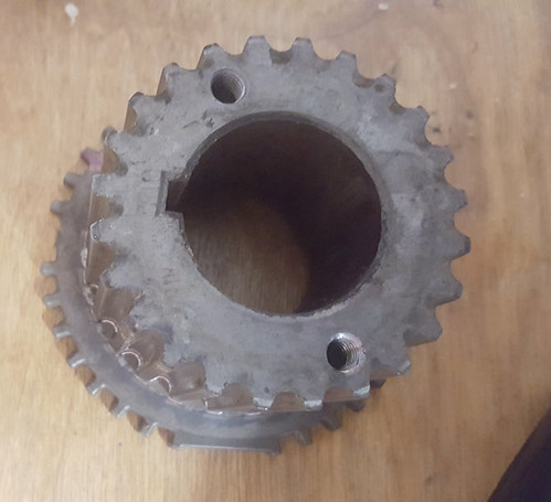

One thing I have left out of this discussion...when attempting to remove the crankshaft timing sprocket (photo below), one of the small teeth broke off. The crank position sensor is pointed right at the teeth. I googled how a CPS sensor works and most of them work by the sensor counting a reluctor (magnet) embedded in the sprocket. There's a spot cast into the sprocket where there are no teeth, so I came to the conclusion that was the location of the reluctor and that's where the counting occurs. I put it back on with 100% confidence it was okay.
After the rough idle thing happened, I walked away from it for the night. The next morning I did a google search on the crank sprocket and it didn't take me long to find a couple of threads where something similar happened to others. Replacing the broken sprocket with a new one resolved the problem. Toyota had it in stock, picked it up and proceeded to dismantle the front of the engine again. With my newly discovered trick of purposely setting the crank timing back one tooth, I was able to diassemble and reassemble the engine, get the radiator reinstalled and coolant flushed over the next 5 hours.
I learned a lesson here. If you're this deep into an engine and there's any question at all about a part, replace it.
Overall, the job was pretty straight forward. I watched some videos on youtube to see what I was getting myself in to, took notes so I would have an order and torque specs, and after a lot of research ordered all my parts. Just take your time and be sure everything is clean and properly torqued. Overall, not bad.

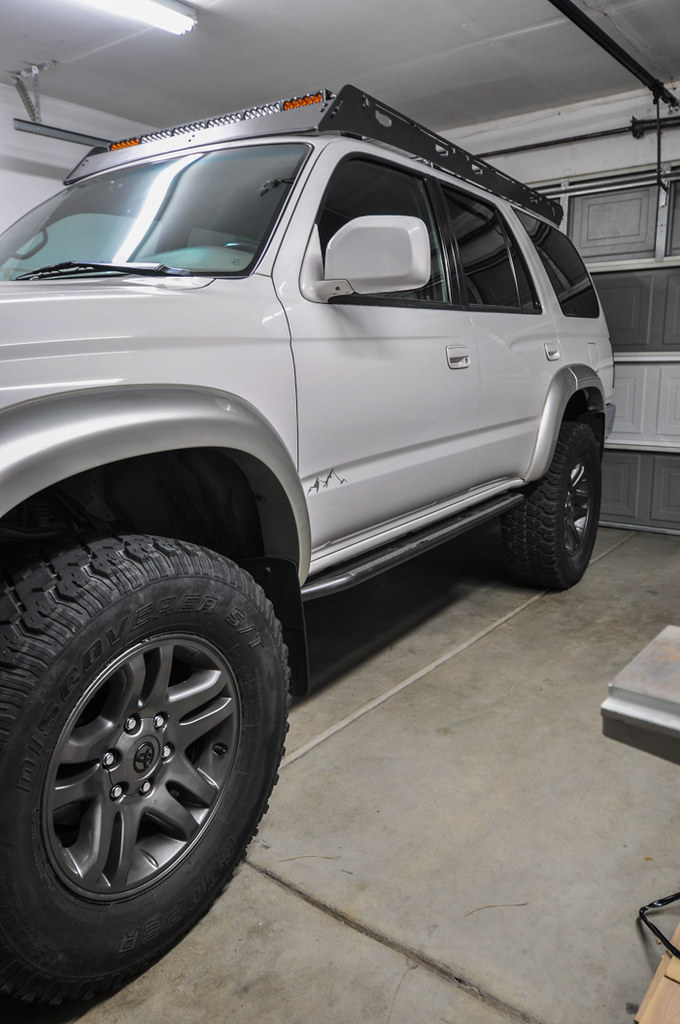

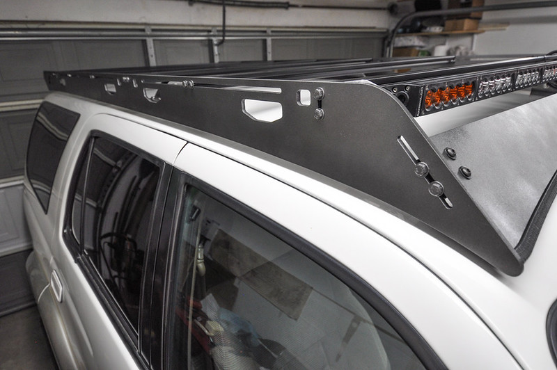

The whip gets a new Sherpa rack.
I love that this rack is based on 80/20 extrusions. I have worked with the stuff extensively in my Sprinter van build and knew I wanted the flexibility with my rack too. I'm looking forward to making various brackets and attachments to make loading up for a trip much easier than in the past.
I'm also happy to report that it is quieter than I was expecting going down the road. :thumb:
This is the first modification I have made since 2005 that changes the look of the vehicle. :violin:
