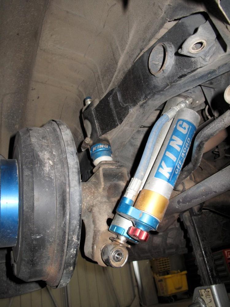

Here are some close up pics of the rear Kings, they will soon have a part# and be available from King. Talk to Brian Groves there, super knowledgeable and easy to deal with plus they are willing to do custom stuff that most other shock companies don't want to deal with. One of the (many) cool things about them was the attention to detail that went into the upper mounting. Most companies just have a stud with a couple of bushings, a washer, and a nut. These have all of that, plus a plastic coated innersleeve that fits nicely into the mounting hole on the chassis and a machined billet aluminum dished-plate that goes between the washer and the bushing.

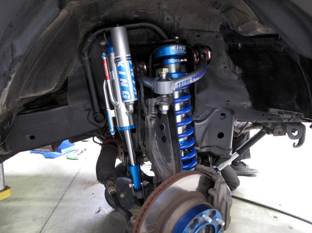

Crazydubman,
They are a 6" travel, with the correct length rod end and top cap to work with the TC Hoops and stock lower arms. King has a specific part # for this setup. Here is a pic that shows the front secondary shock installed:

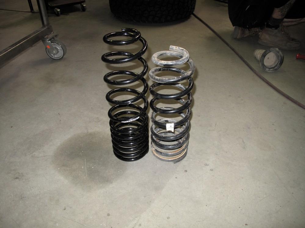

Here is a pic at full bump during my Toytec Superflex rear coil install:
Got the new Toytec Superflex rear springs installed (huge thanks to Miles at Toytec Lifts for getting them out to me quickly!). What a night and day ride difference vs the OME 891's. Even with the amount of weight I have in the back (one of these days I will pull everything out and weigh it all) they netted me an additional 1/4" of lift. They are so soft in the back I will finally get to play with the King's Compression Adjuster Knob, where as previously I had it set all the way to soft. I also like the Driver Side and Passenger Side specific coils to help with the 4runner lean.

Awesome build. Do you have any pics of how you mounted the 2nd shock on the lower??

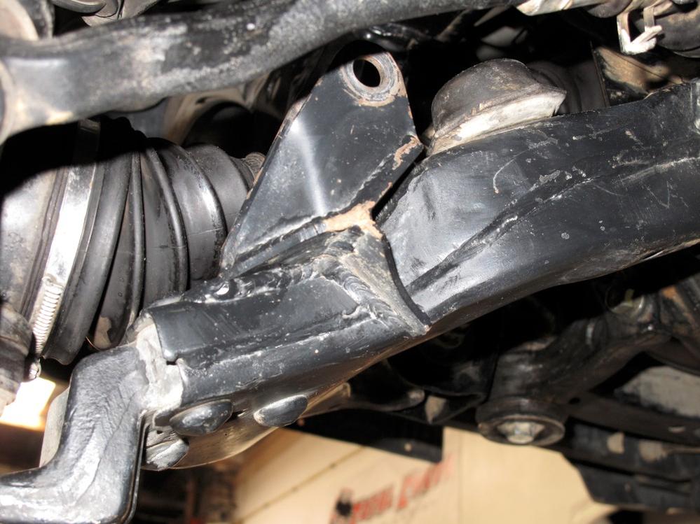

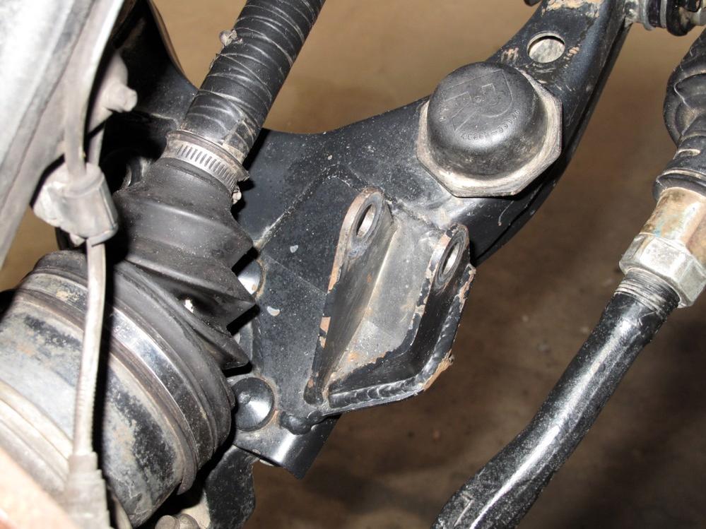

[MENTION=9631]twitchee2[/MENTION]
Here are a couple of pics, this pre-fabbed lower shock mount comes in the secondary shock hoop kit from TOTAL CHAOS (part#96602). You cut/grind off the swaybar mount from your lower arm and weld-on the new shock mount. It indexes around the big rivets in the end of the stock lower arm so placement is a breeze.
