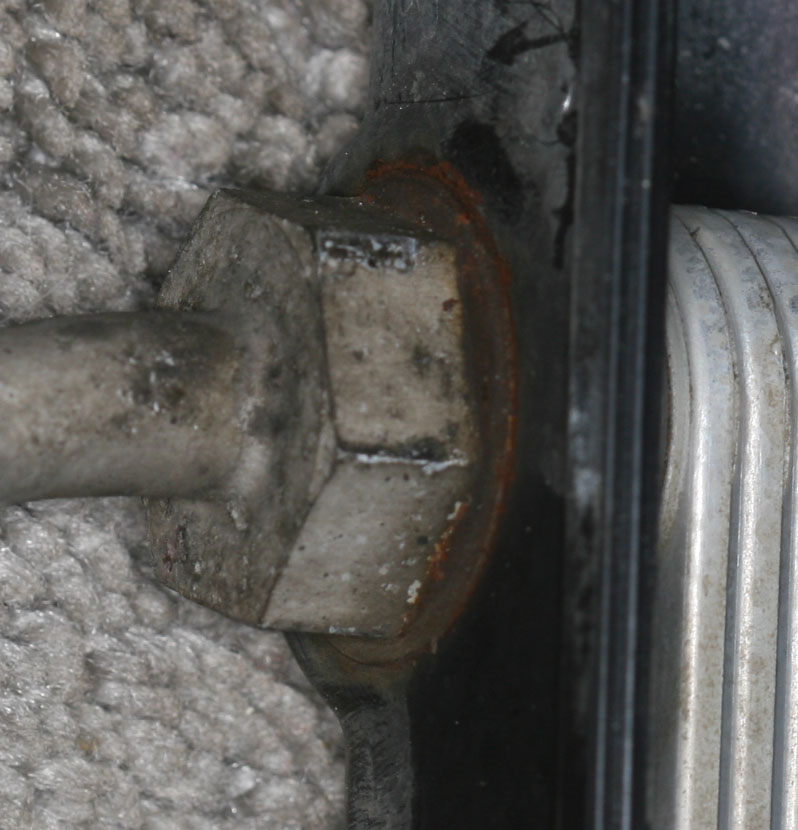

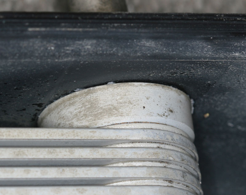

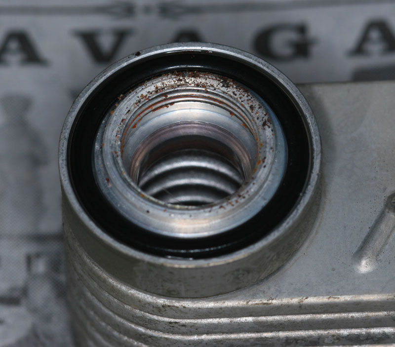

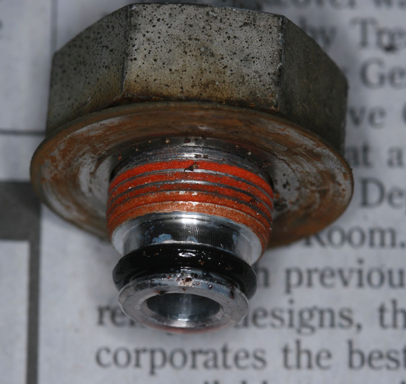

I changed it almost immediately after that old post with a Koyorad #1998. I dissected the old radiator and found signs of seal degradation between the tranny cooler and radiator. There was no evidence of mixing in either the tranny or coolant on this truck.
The seal that was failing was on the outlet with the bent nipple. It appears they bend the nipple _after_ they put it on the lower radiator assembly. (That way it's pointing the right way after tightening.) That stresses and deforms slightly seal junction.

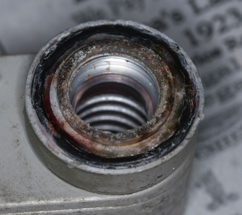

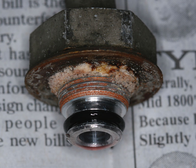

By comparison here's the inlet. I'm satisfied this was a good time to change the radiator. The previous owner worked at a Toyota dealership and had service records of fluids changed at recommended intervals.
