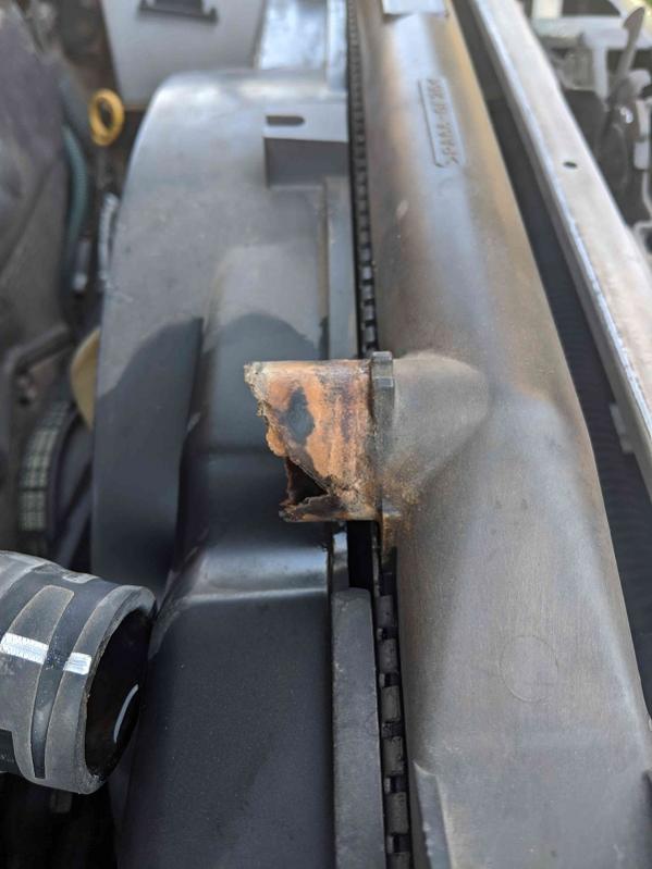

Bought a radiator from Camelback. Terrible packaging, but luckily all the important bits seem okay (have not installed yet). Really, can you please add a bit more material for packing? It's not rocket science and would save you on returns. I have ordered radiators from CSF for another car and been very impressed. Could have punted that box from another state and it would be fine.
Anyways, radiator was fine before I removed it, original, 335K miles, very well maintained (I know the rigs history). This happened when I gently pulled the upper hose:

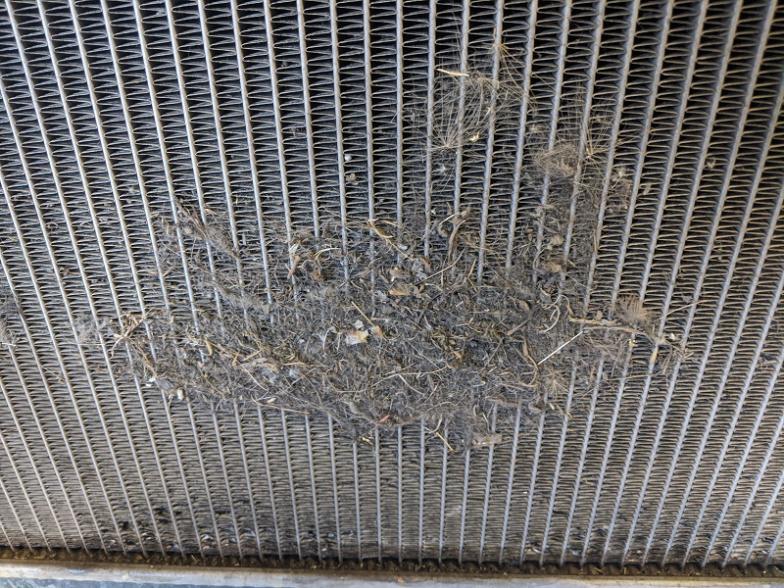

And here's a few more pics. Lots of duff collected over time. I will be cleaning the ac condensor? too.
