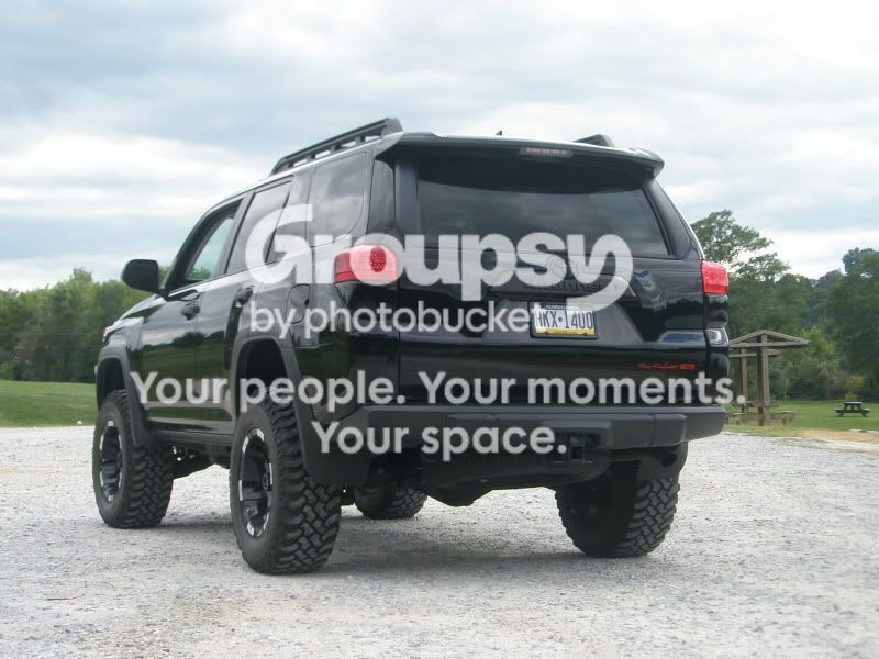

I did mine. You can't take tails apart like you can headlights.
P9090021.jpg~original
Yeah, I've seen yours before Jesse and it looks great. Just always thought yours was tinted vs painting the inside housing black like others did to their headlights.
yeah, mine is tinted. but like I said you can't open up the tails like you can with the headlights. so for tails you either have regular ones, trail version, or tinted.
Yes, it can. It acts just like spray paint until it dries. Essentially it's a latex paint in a can. It needs to be applied a bit thicker than regular spray paint. It should be applied thick enough so it looks like a smooth surface, but not too thick that it runs. One can says 5 sq ft. I used 2 cans on all the chrome except for the door handles. I will need another can to finish that up.
I'm confused... thread subject mentions plastidip, put I see a can of Krylon fusion... so which did you do?
Krylon for the headlights.
Plastidip for the door handles, lower chrome, front grille, and rear chrome. Be very careful on driver's side door handle.
eBay vinyl (BMW shadowline ripoff) for the roof rack.
