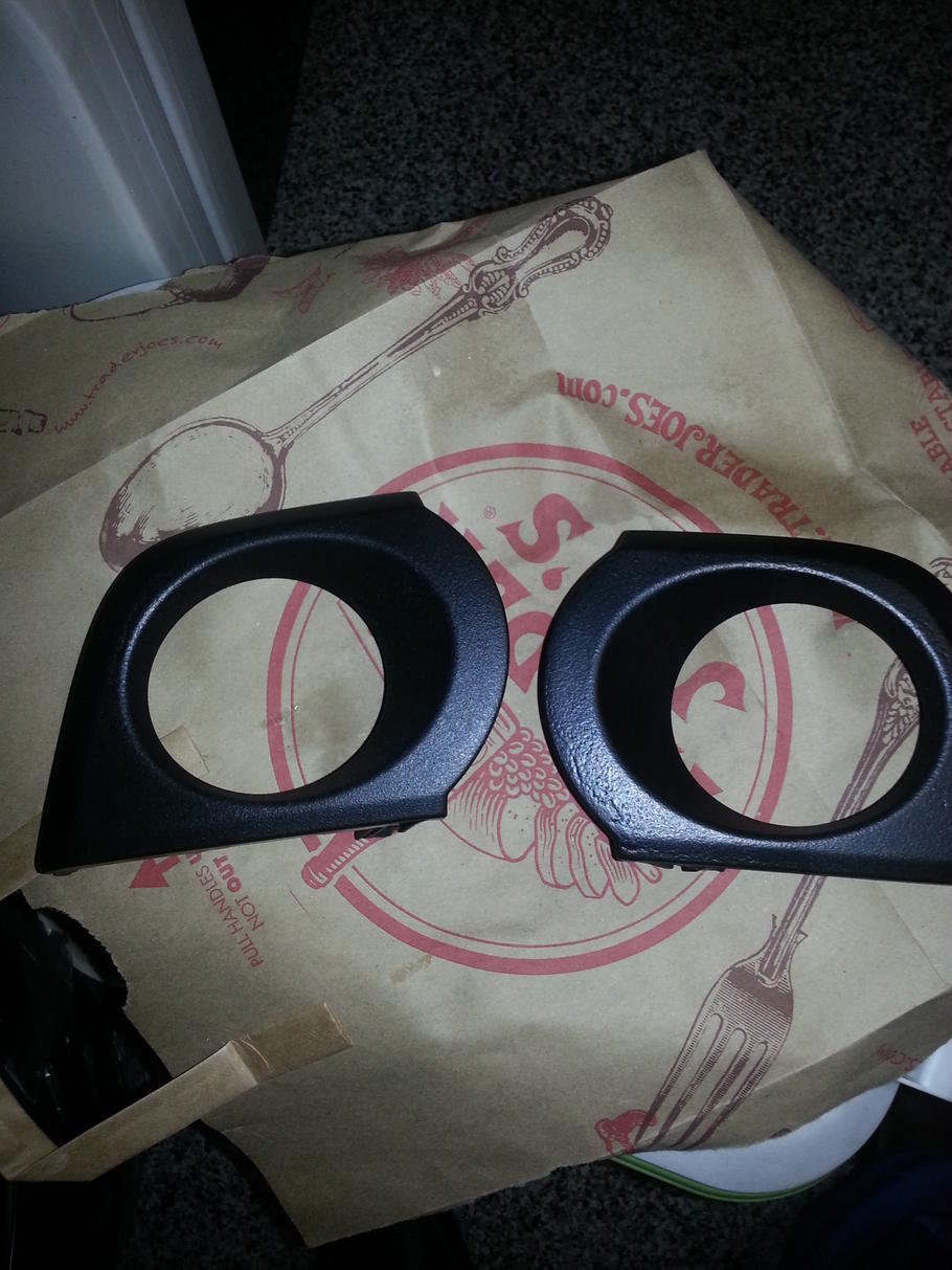

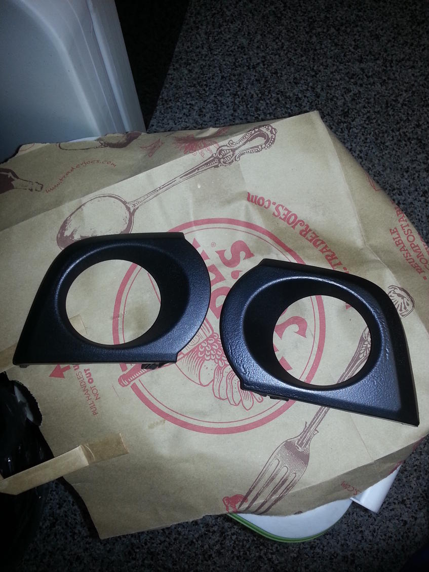

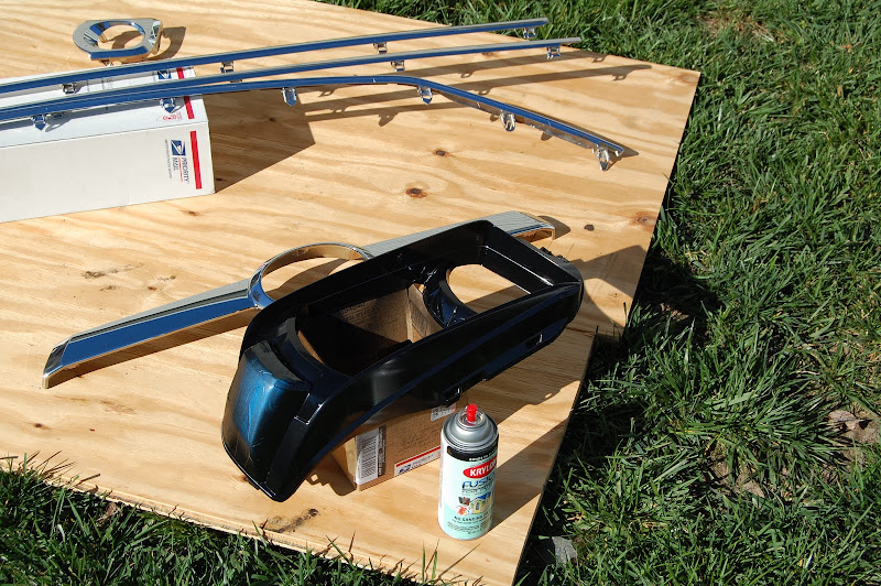

Here's my first attempt at plasti dip
Not sure if the pictures will show but the molding on the right shows more texture than the left. I might have to start from fresh, only I dont know how to avoid that.

Ahhh, that's good to know. I did hold the can 12-14 inches away per the instructions. I'll try 6 inches on the chrome strips and see if it comes out smoother. The nice thing about plastidip is, if you mess up or don't like the results, yo can just peel it off and try again.
BTW JayG, check your PM.
Temperature is also a factor in how smooth the finish turns out. Colder paint=more texture, warmer paint=smooth surface.
I usually warm the spay can in a sink full of hot water or place it over a heat vent for a little bit before I spray.

Antman is correct on this. I have only had that happen when the product is cold.
I will try that..
What i dont get is why one is smoother than the other?
I washed both and dried them before spraying first coat
Antman saves the day :trophy:

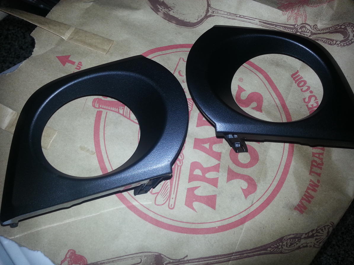

I can't believe how easy it is to take off this stuff and remove.. It was as simple as chipping the "rubber" and getting a small hole to peel it off.

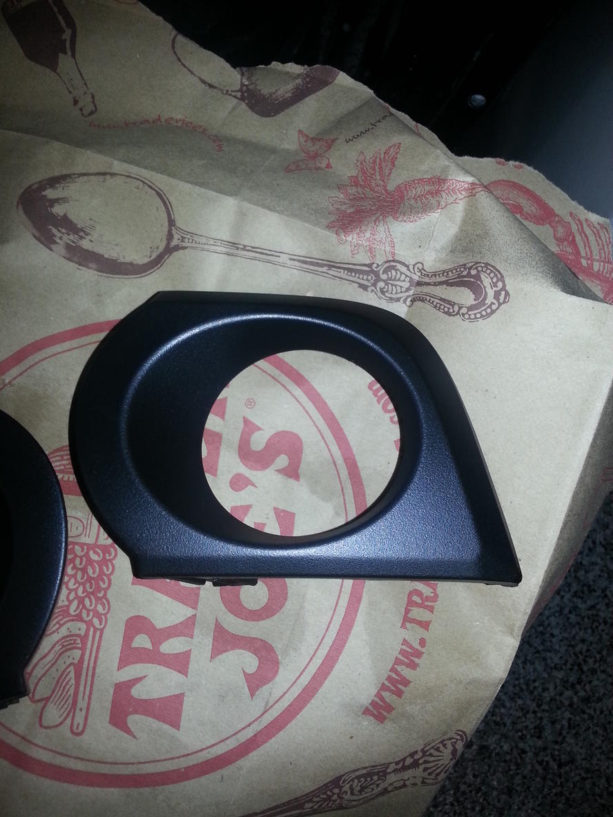

I started from fresh and used Jay G's advise to start the first and second coat light + Antman's advise and ran the can under hot water for a minute each time before coating
I love this forum!

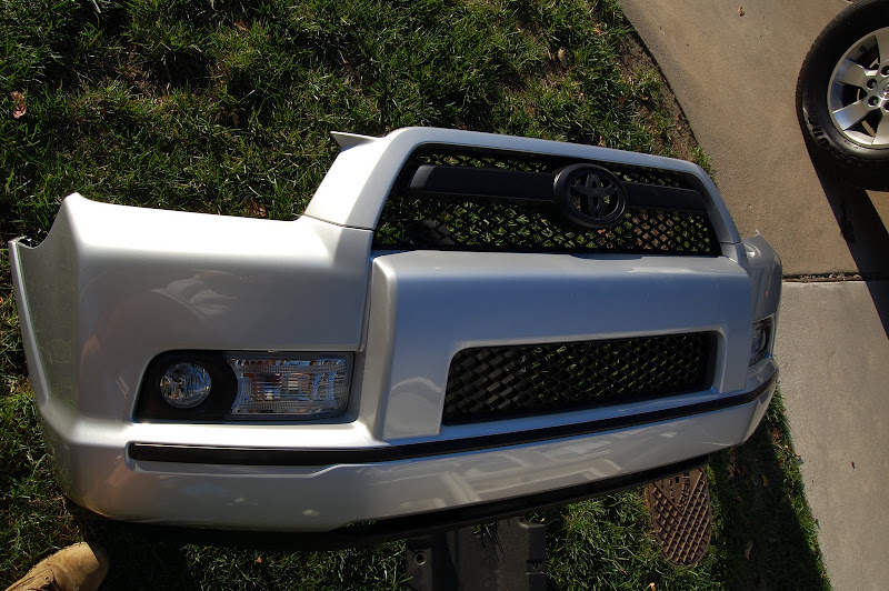

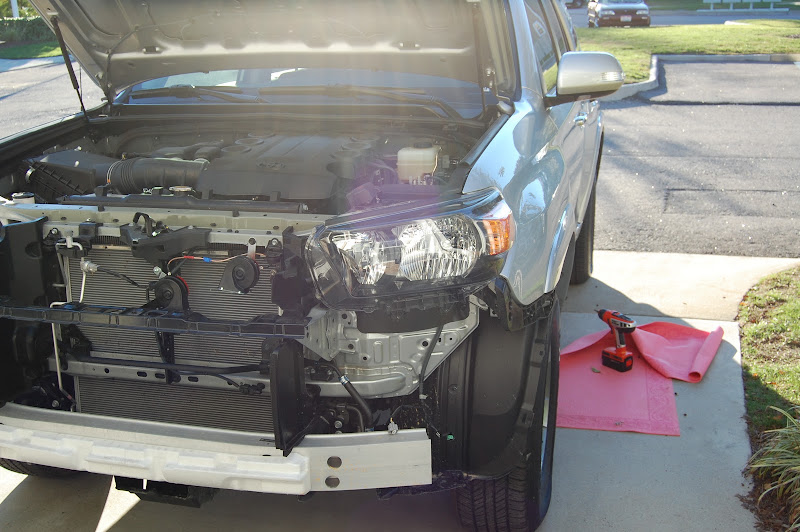

Do you have to take the whole front bumper assembly off in order to get the stock chrome fog light covers off, or is there a slick way to just "pop" them off? Definitely want to plasti-dip these to match the grille cross bar piece
you need to pull back the inner fender liner (search the manual for how to replace the fog light bulbs). this will give you access to the back of the lights. there are four tabs that you gently squeeze while pushing the trim piece out towards the front of the truck.
here's a write-up:
http://www.toyota-4runner.org/5th-gen-t4rs/66759-those-who-want-know-5.html#post647147 by snow&surf

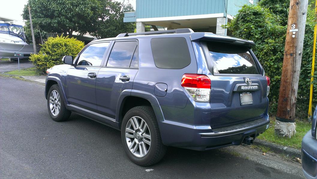

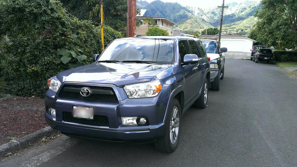

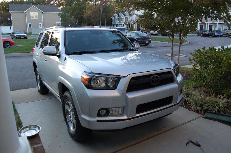

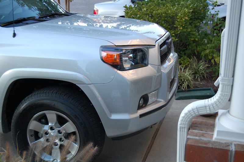

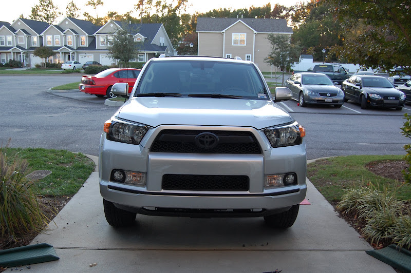

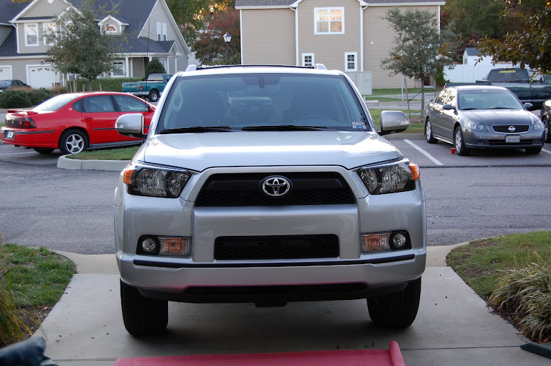

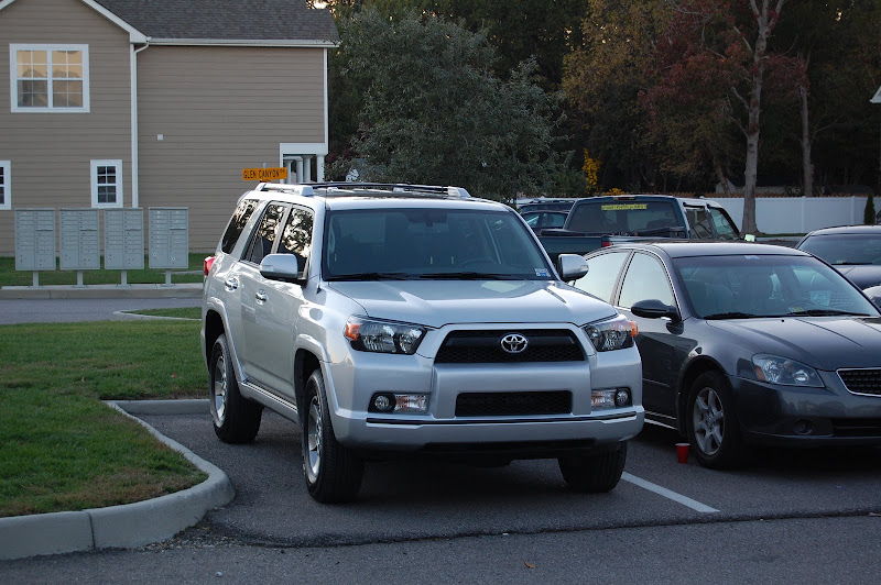

Just finished platidipping all the chrome...and I dont see many shorelines on here so I wanted to share :)4runner1.jpg

Nice work, especially with the headlights! I covered the entire side of the truck when I painted the door handles, pretty brave of you to only cover a small section.
Be forewarned, the front strip chips easily. I repainted it after 6 months which is why I opted to purchcase the TE fog lamp covers (which should arrive this week) so I don't have to repaint those too.
I dipped my front chrome trim band, chrome logo bar, and chrome fog bezels on my old 2010 SR5 and was not really impressed with its longevity. Too much of a high impact area IMO. I guess if someone is happy to recoat them often, it's no big deal.
Did you clear coat on top of the PD?
