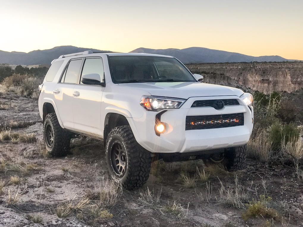

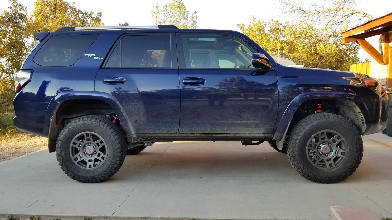

2017 sr5
Top of ridge at on the east side of Los Alamos.

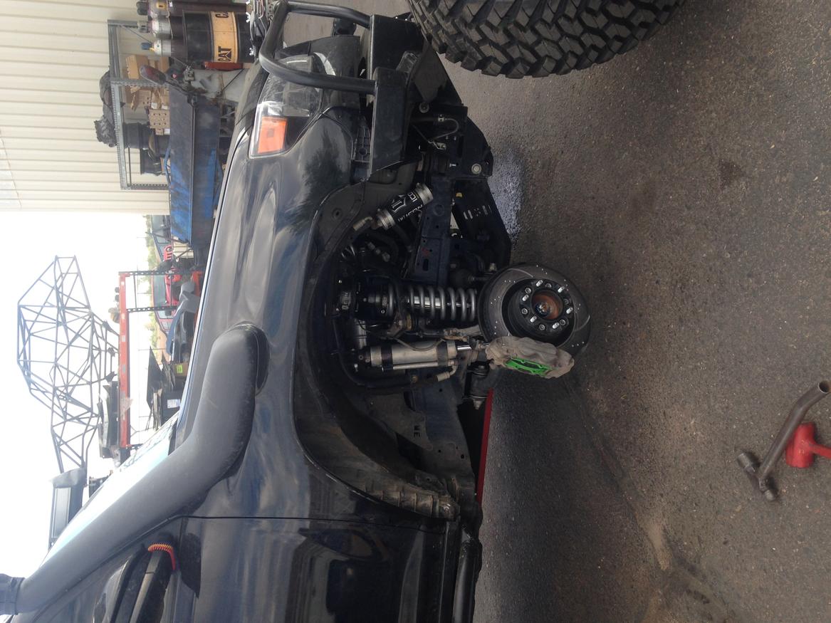

285's and Boss 2.5 coil-over kit with Total Chaos UCA'S from Toytec.

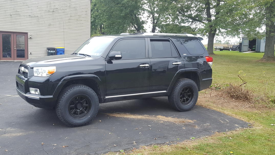

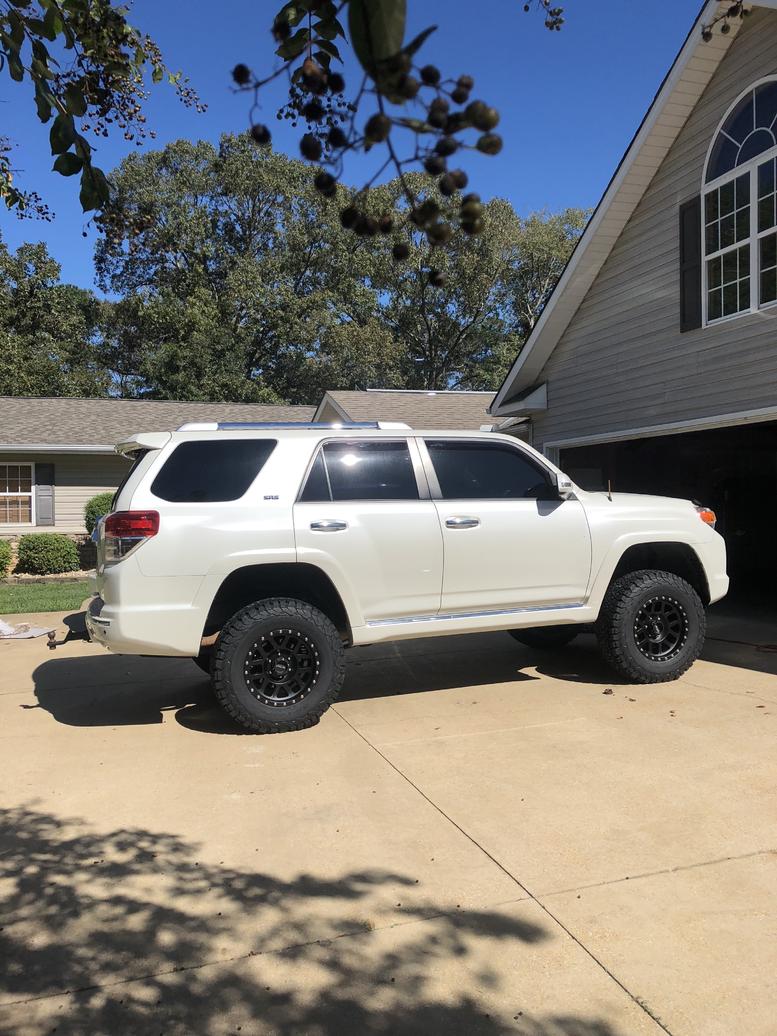

Here's my wife's. I did 2 1/2" springs in the front and 1 1/2" springs in the rear. Bilstein 5100 set at zero.

shyuperman: Wow, look bigger than that. How high is the lift?
I think the angle of the pictures might make it look deceiving. But it doesn't look bad in person (which was my fear)
Supposed to be 2.25" and 1," but right now it's sitting 2.5" and 1.5." Expecting it to settle some more.
I second that! Looks awesome! How bad was your MPG hit after this build?
Not bad actually, haven't really put much weight on. There was a hit from going from the stock dunlops to the wildpeaks. But I'm also only have 900 miles on the T4R, so it has since improved with the engine breaking in.
Averaging about 17.7 miles currently mix city/hwy

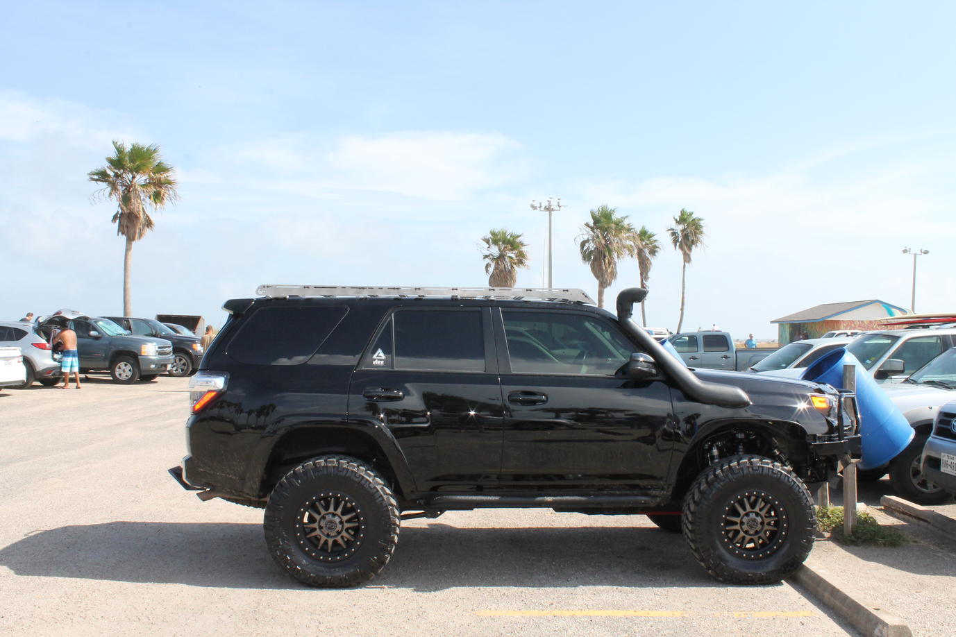

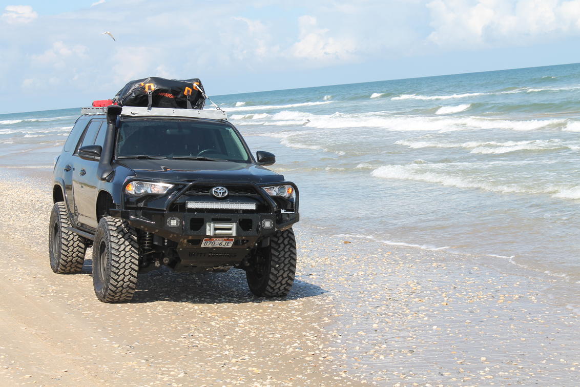

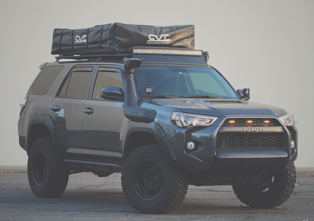

Think I am finally done messing with the suspension....for now. ADS 2.5s front coilovers, Rear ADS 2.5 piggybacks, ICON S2 with OMEGAS. Wheeler superbumps front and rear (custom spacers added for these 35s), 1" body lift, SPC UCA with new model bushings and greasable ball joints. Spacers from 1st pic removed (its a long story).

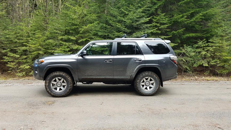

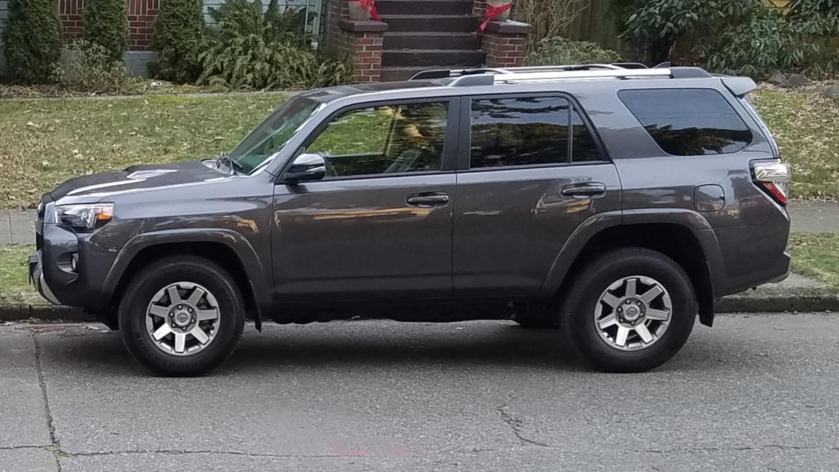

My stock TEP had an awful rake (1st pic) and was super low clearance. Got 285 duratracs first. Next got Bilstein 5100's for front, set at 2.5. Resulted in slight reverse rake after front only lift. Still no rear lift few thousand miles later, but got airlift 1000 airbags right after front 5100s, and set at about 30psi it raises rear enough to make it slightly rear high again (at least at fender wells, probably approx level frame). This really improved mileage too, reverse rake was costing me about 2mpg until I did this. Rough ride though, so looking to do rear coils with 1" lift or a spacer to get original ride back and keep airbags for towing. About $450 all in as of now.
Of note, my 285's didn't rub pre lift except slightly in reverse when fully cranked.
