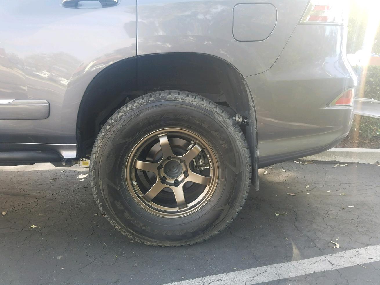

Thanks for the reply. When not compressed, the wheel is still a lot more rear biased, is this normal as well?
IMO, no. It means your arms are too long. Do you have new uppers and lower or just lowers? If just lowers, you can adjust them a little shorter. Shortening the lowers will also clock the pinion "up" which will help your u joint angles and help with vibrations if you happen to have them. What I would do is measure your stock arms from center of eye to center of eye and then measure the new arms the same way. See what you get and post up.
Well that's great, I checked the trailing arms and they are about 3/4" off from center to center (checked holding the original trailing arm up with 1 end in the bolt hole and the other not able to reach. I'll call Icon tomorrow and see how they want to get it fixed.

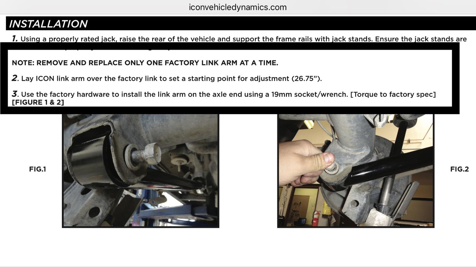

My rear axle is sitting further towards the rear instead of centered in the wheel well. The consensus is this is not the correct setup for the suspension. So I removed the rear trailing arm per Icons instructions and adjusted 1 side. After the trailing arm no longer reached the eyelet hole and I was not able to move the axle further forward since the rear upper control arm does not adjust. Therefore it seems I need to get adjustable rear upper control arms. I need them to be about 3/8" to 1/2" shorter in order for the axle to move forward. Is this what other people have been doing, not able to find a lot of info on this? Also waiting to hear back from Icon if their uppers are adjustable to be made shorter than factory so that it connects. Any help would be greatly appreciated.
http://www.iconvehicledynamics.com/wp-content/uploads/2017/02/I54000T_REVA.pdf
