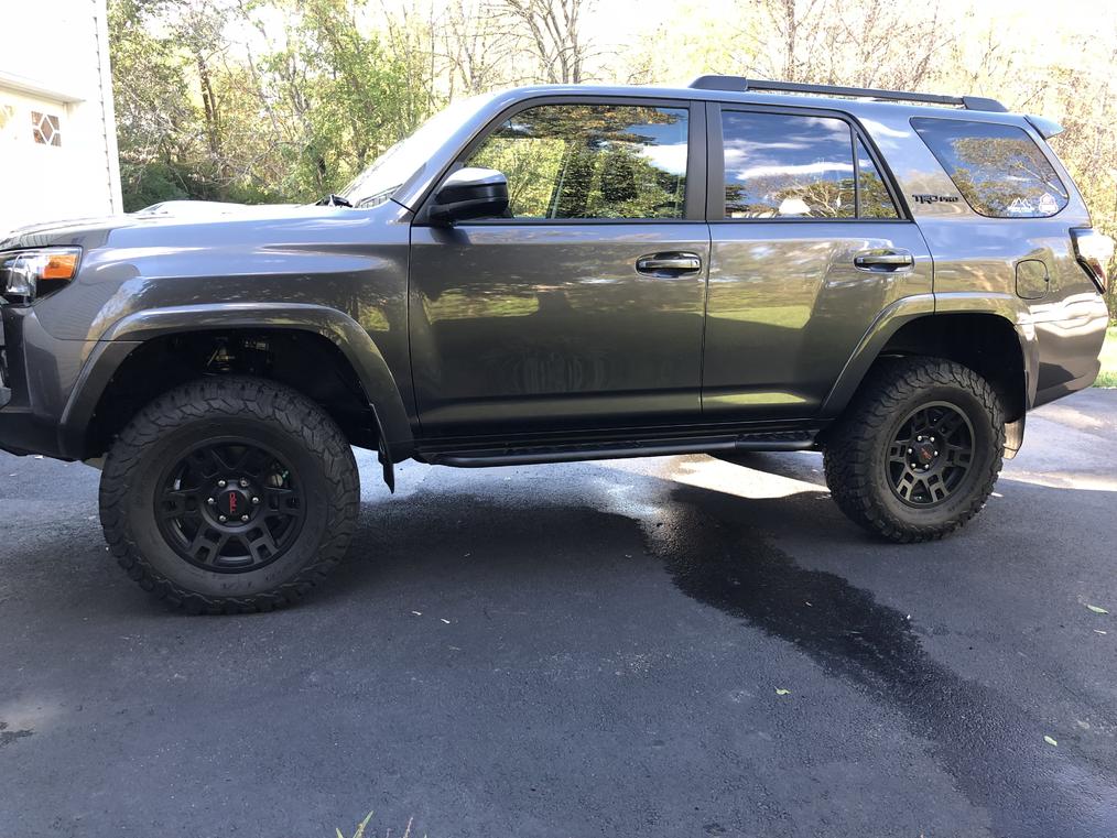

For my clearance needs and off-road use, the Daystar lift did a fine job of really transforming the look of my truck. Really happy with the results.

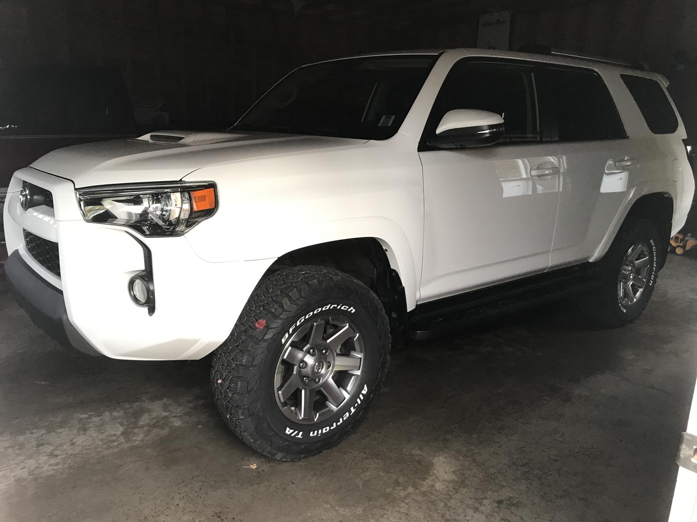

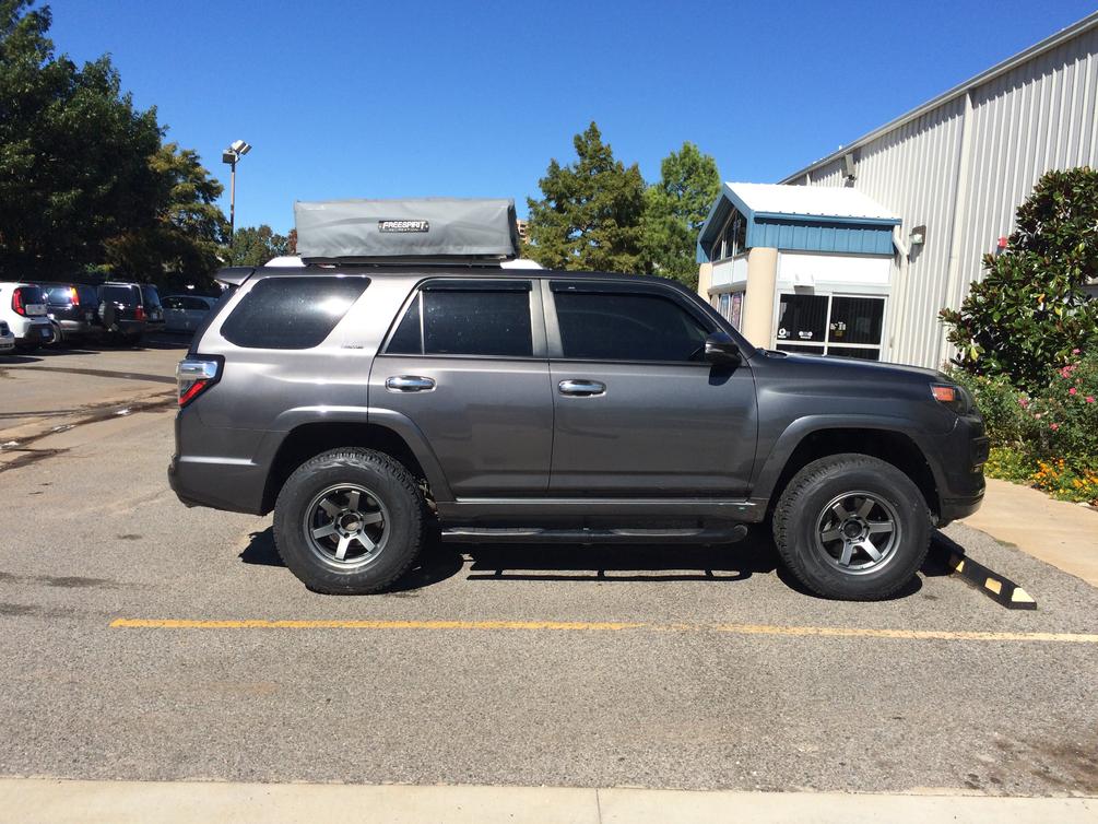

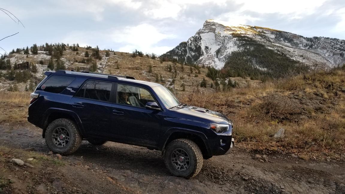

my 2016 TEP has rake like yours did. I am 3" lower on the front.
Its really ridiculous that they can roll a world class off road vehicle off the assembly line looking like that. How hard would it be for them to make the TRD/Trail models with less rake and some tires that will actually get you down a dirt road? Still not even sure if the stock suspension was different than an SR5 in any way.
Waiting to see how it settles with armour coming up soon.

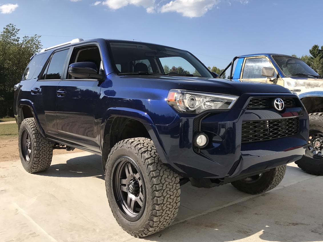

2016 SR5 with 3rd row
Dobinsons suspension
C59-302 frt spring
GS59-574 frt strut
C59-325 rear spring
GS59-705 rear shock
Diff drop
275/60/20 BFG
20x9 fuel Anza
1.25” spidertrax spacers
