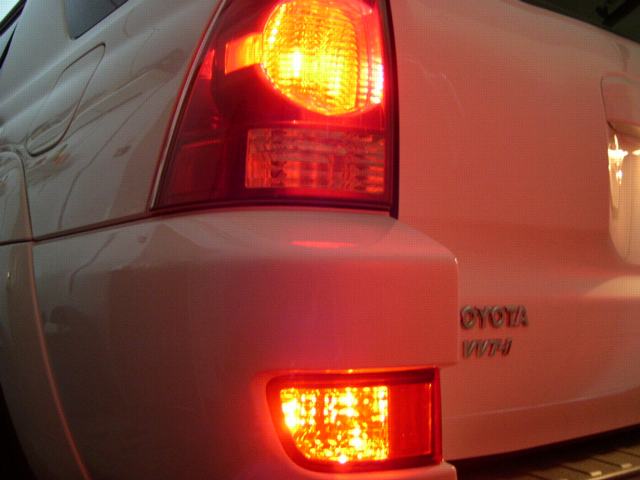

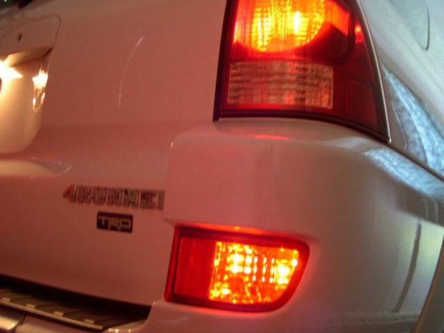

I just wanted to thank you guys. Especially Kmvreter. I ordered all the stuff he did and the job was a snap. I really like the way it looks and turned out.
Thanks, glad it worked out for you.

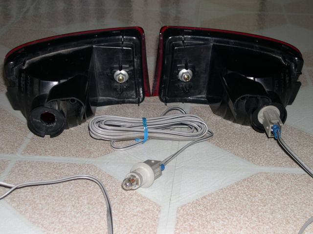

OK I found some wedge bulbs and socket from a Honda i use to have and took out the 4R light and drill the hole to fit the light socket and use the blue speaker connector and gray speaker wire to wirer them . \
I could not have drill the hole any better! The socket fit perfectly and snug without and glue or anything to hold them in place! after I did that I install the light back on and wirer them to the green and white wire on the back trailer plug for parking only. The lower parking light match the top parking light perfectly and these bulbs are only 5w /12v a piece!! The best thing about this mod is that it did not cost me a penny! found everything I needed laying in the garage!:D :artist:

The Honda Part# is 89799 . The wedge sockets is off a 98-02 accord parking light in the front headlight. It the part that light up orange on the headlight.
Click on this link to majestic Honda part catalog. It's #8 in the picture and is $5.10 a piece.
