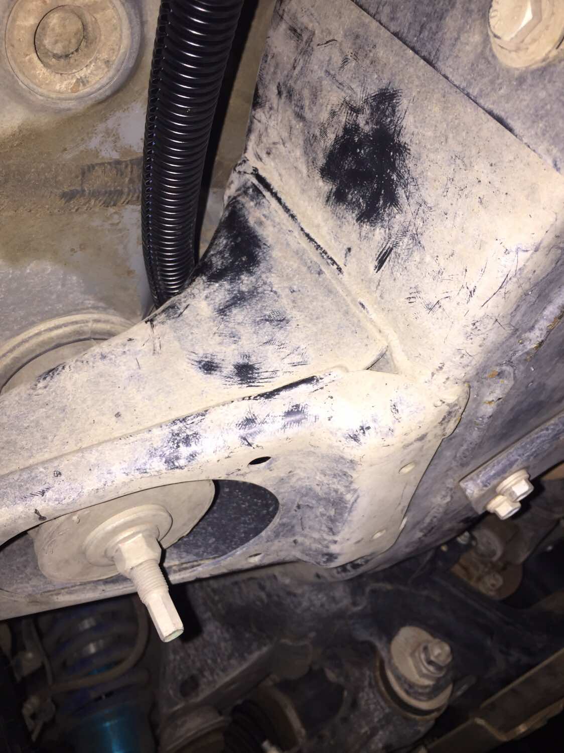

Your thoughts / knowledge needed regarding the route i chose for my ARB breather tubing up front.
In my photo you are looking at two separate runs inside the loom, but my thought was to stay away from the muffler pipe and stay on outside of frame rail. I ran the lines between the frame and body right next to the frame / body mount.
Good? Bad? Is there much flex / movement here that could pinch and or damage the lines?
Thanks
Thanks
[MENTION=126720]mgosts[/MENTION]
I just answered your pm. There are hopefully others that can chime in on how your run of the loom can be affected by frame flex, as I honestly don't have a definitive answer. I ran mine from the engine bay down past the the fender liner and attaching to the other lines in the inside of the frame rail (see pics on first page of this thread). I will try and send more pics when I get a chance.
Thanks for the reply [MENTION=120701]Cymon[/MENTION]. I will do a bit more research.
