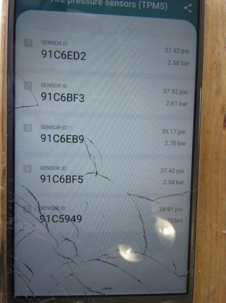

I don't see anything for reset of TPMS in Carista. You can see sensor numbers and pressure (but no temperature). No options to do anything with the TPMS system, other than to share the list of sensors by SMS or email.
Pay no attention to the cracked screen :)

I have had a Carista since I bought this truck and it only reads (no other functions AFAIK) on newer Toyotas. Carista is great for a quick lock or window function change and well worth the price of admission but there are better/faster Bluetooth OBDII readers out, obvisouly for more money.
