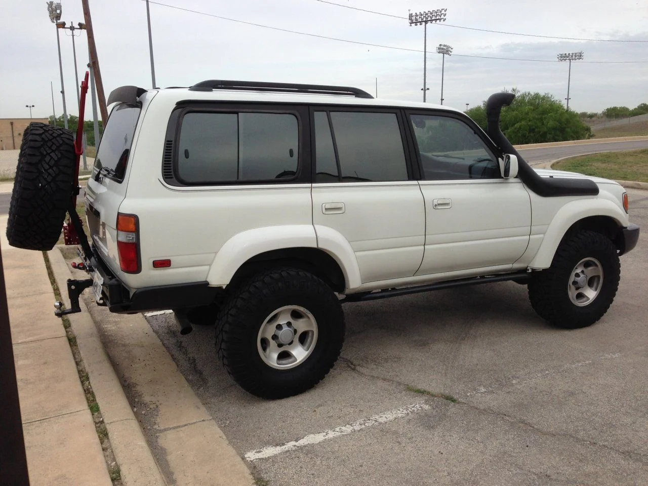

Can you post a photo or other video during daytime showing how the marker lights look installed in the plastic bumper trim/extension?
I have not finalized mounting so now it's just wedged between body and top of bumper end :)
It should look good on bumper end, but need to heat the plastic and bend it slightly so it faces up.
Also considering mounting it on the quarter panel just like it is on the earlier Camry's and Land Cruisers. (I have no problem cutting metal if it improves safety, reliability and/or functionality-LOL!)
