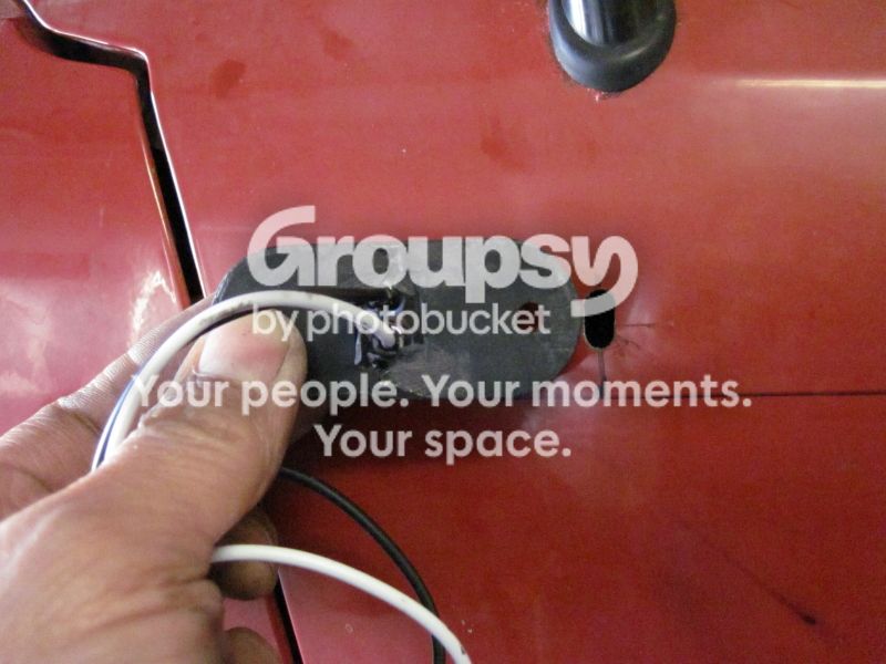

Mounting
Opening for wires.
005.jpg~original

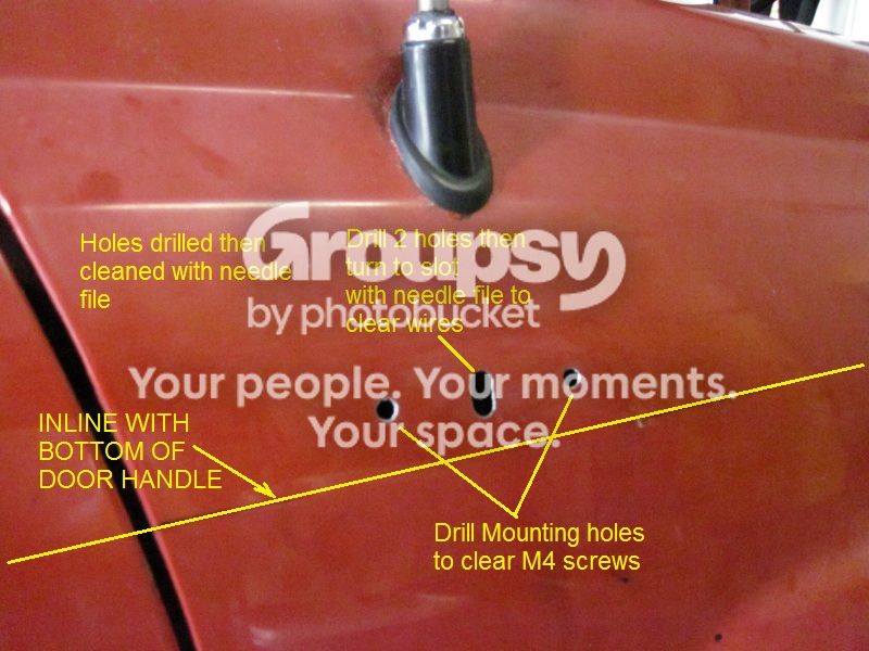

Mounting Holes:
006.jpg~original

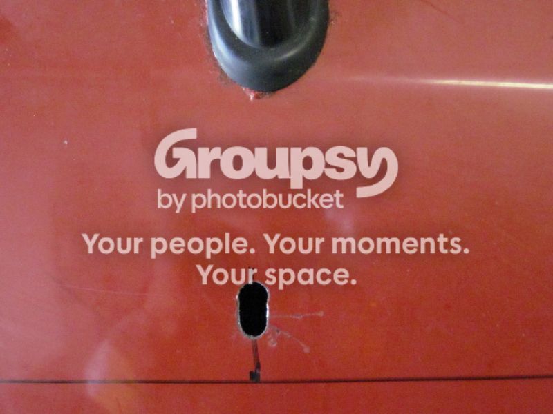

I applied a thin (approx 1/16") layer of RTV, let it harden a little, then apply more to fill up the mounting holes and opening for wires
004.jpg~original

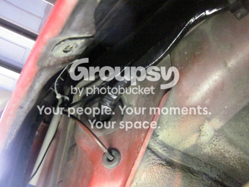

Ran Wires along existing loom under fender:
042.jpg~original

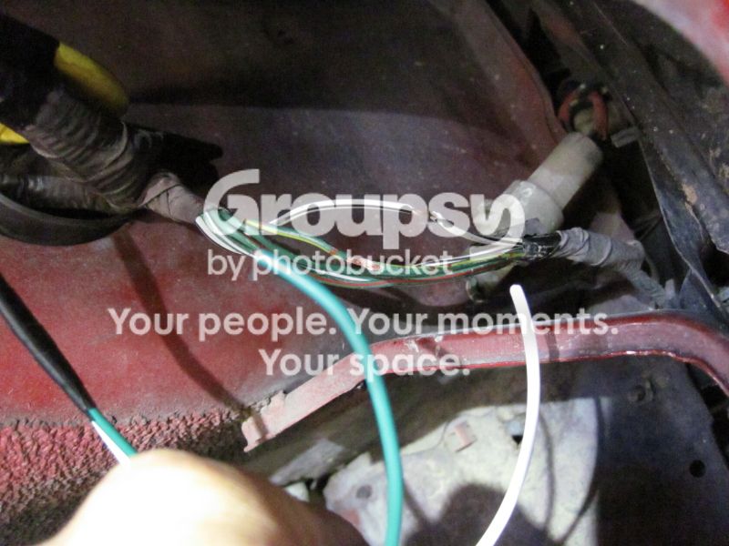

... To front right corner behind and below marker light...
043.jpg~original

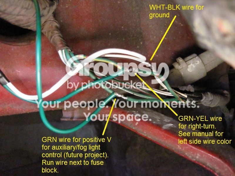

Tapped off (stripped, wire-wrapped-soldered, insulated) green wire with yellow stripe (pos for right turn signal). Please check schematic for left side, white with black stripe (ground). Also tapped off positive for marker light (green wire) and ran other (insulated) end to fuse box for future use.
045.jpg~original
