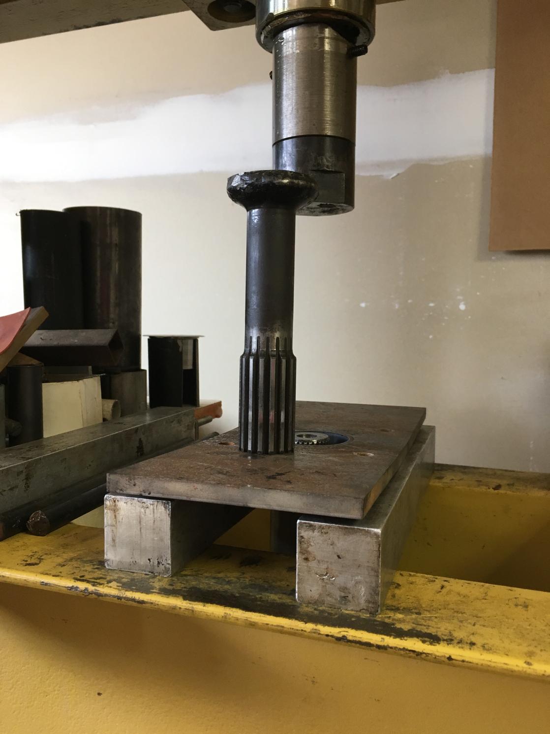

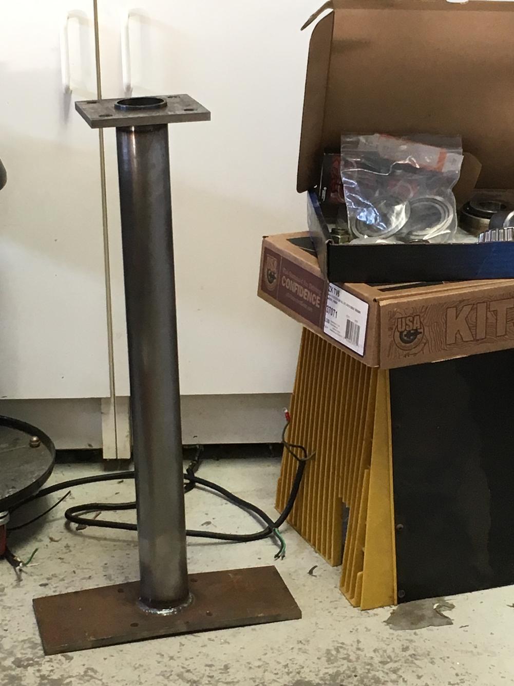

axle bearings
You'l see some folks have cut off the sleeve and then pound the axle on the ground. If your stranded that may be the only way. If you have access to a press and the right tool its a 15 minute bearing R & R.
Thanks, KC.
Yes, Alexman Video shows similar special service tool. And that tool ^^^ is "proper". I'm a McGyverish for emergencies, but not in a rush and am a minimalist (hence, the first-gen) so I don't want to accumulate tools and equipment that I do not plan to use very often, so I'm looking locally for someone with proper press / tool to help me with it.
