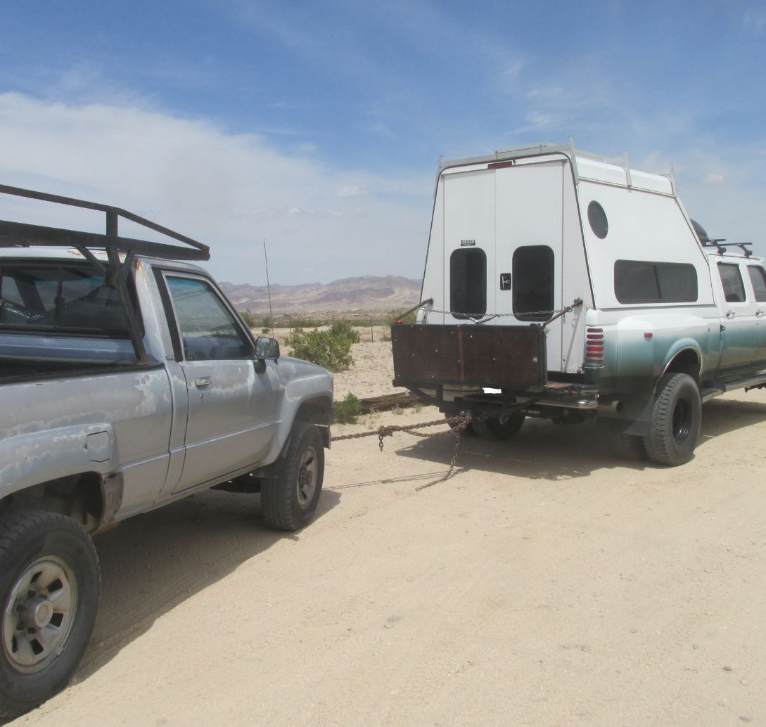

i began searching for some answers to my recent experience with my 1988 22RE....
stock, about 160 miles, suddenly the battery isn't charging, it's a fairly new Optima...less than a year old.
this week, went to the Joshua Tree post office to check my mail...truck was running rough, and wouldn't start after checking my mail. got a jump and came home....got slower and slower, and as i attempted to put on my hazard lights....the draw made it worse..so i knew it was electrical...actually died 1/4 down from the house on dirt road i live on. was able to walk back, grab Ford F350 and fat chain and drag it back.
Sure enough, alternator not charging/output zero.
charged the battery back up and started no issues.
so, i did all the electrical checks and made the decision that the alternator was the culprit.
turns out my brothers got 22RE as well, he's upgraded to a larger/newer motor...so i have every spare part one would ever need:lock1:. I grabbed his alternator (it's supposed to be upgraded/rewound/high capacity). it does have a smaller pulley on it, so i assume it spins faster....thought about trying to put my older/larger pulley on it..but don't have the tools it seems for that.
anyway, after draining coolant and making a mess, i got it changed out...refilled and started...SAME ISSUE...no output from alternator.
i studied/used your posts THANKS AGAIN FOR SHARING THE DETAILS, SCHEMATICS, AND TIME you have dedicated to your truck!
All my fuses check good, and i checked them with volt-meter AND took them out and measured continuity. all the fusible links are good, my exciter voltage is good at the plug to the alternator, even checked at the intermediate plug by the power steering reservoir. Ferrite Box Splice OK...i've done no work to the thing, just drive it, it's stock, no mods, actually has a crate motor i put in 10 years ago, said motor got about 40kmiles on it. AC works, the thing just has been my daily 'beater' take it to the mountains to the TH for hiking, take it to Walmart for groceries, take it to the dump with my garbage. take it to home depot for building supplies.
the other day, my charge light was on with old alternator, but now the charge light is out with the 'new' alternator, but there is no output for both of them.
So, my plan is to take the old alternator to get checked...if it's bad, then both alternators must be bad. If it's good, then both alternators must be good and my problem lies elsewhere......????
Belts are all ok, there is no corrosion, it's been a desert truck in Yucca Valley since 1988. some sand and grit maybe.
It's a problem that's only just happened out of the blue!
I'm not even sure the alternator my brother has is good at this point, but it's new/rewound and he just took it off when he removed his 22RE engine on his 1991.....to put in a 3xxx engine/turbo charged..
my plan is to fix this issue, then start using some of his upgraded parts and slowly build mine up so i can get up/down that hill to/from Palm Springs faster than 50mph in 3rd gear!
