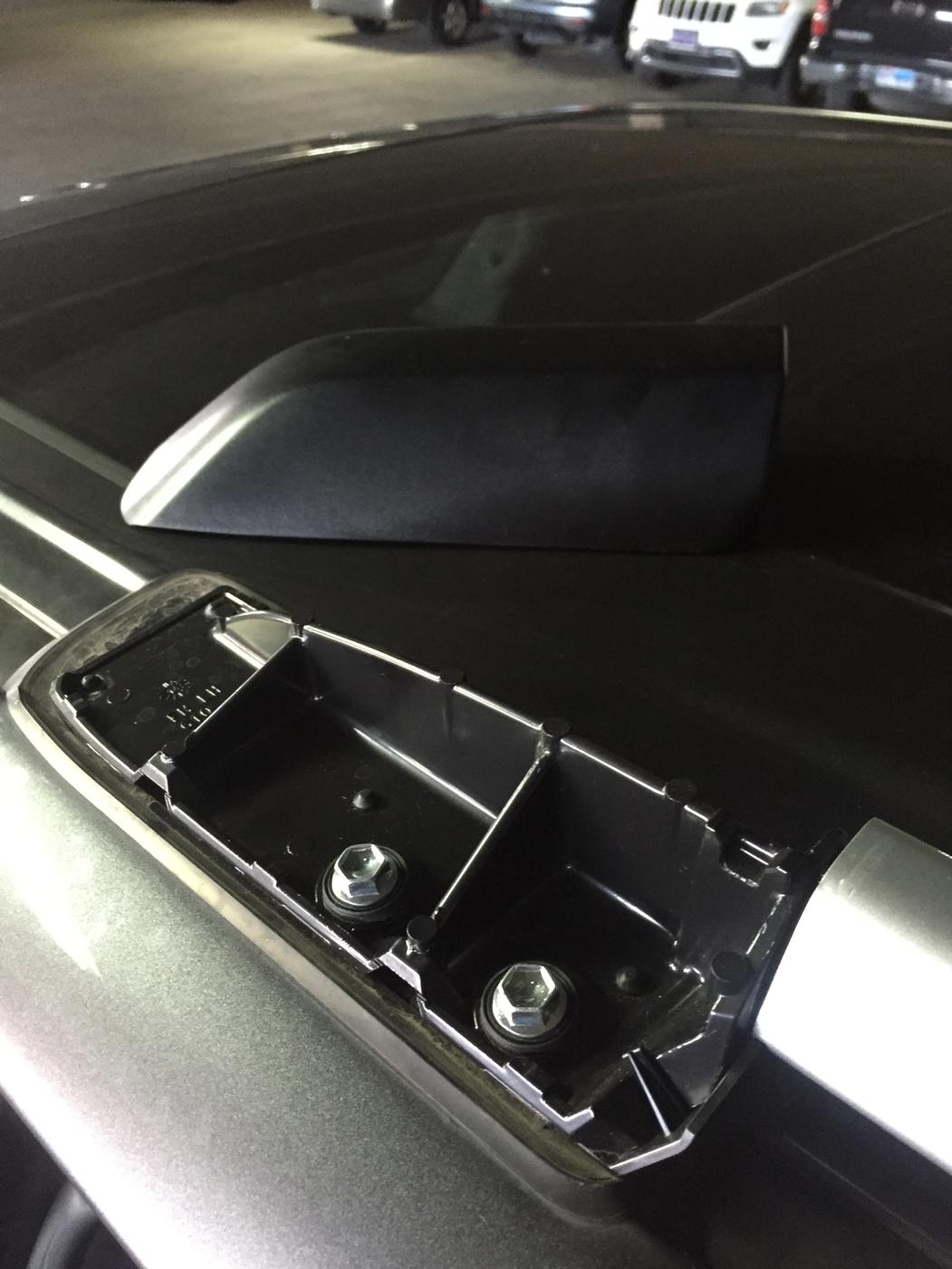

There are 4 mounting points total, the aftermarket racks use the factor 4 and than normally have 2 feet at the front of the rack that just "rest" on the roof. I took off the covers to paint my rails but its been awhile. I don't recall there being any "mounts" to weld to I would assume you will need to make your own brackets for the new rack vs trying to attache a new rack to the factory brackets.
P.S. Crawl on your roof, pop the plastic covers over and take pictures
Yea, that's what I was afraid of. Its just a little more precision than I wanted to ask for on a 100% free favor made by the shop hands down time. I'll look to get up there today or tomorrow and check it out.

Factory bracket photo. Aluminum or steel?
cover is plastic, bar and mount are aluminum. I thought about using the factory mounts but the aluminum shut me down.
