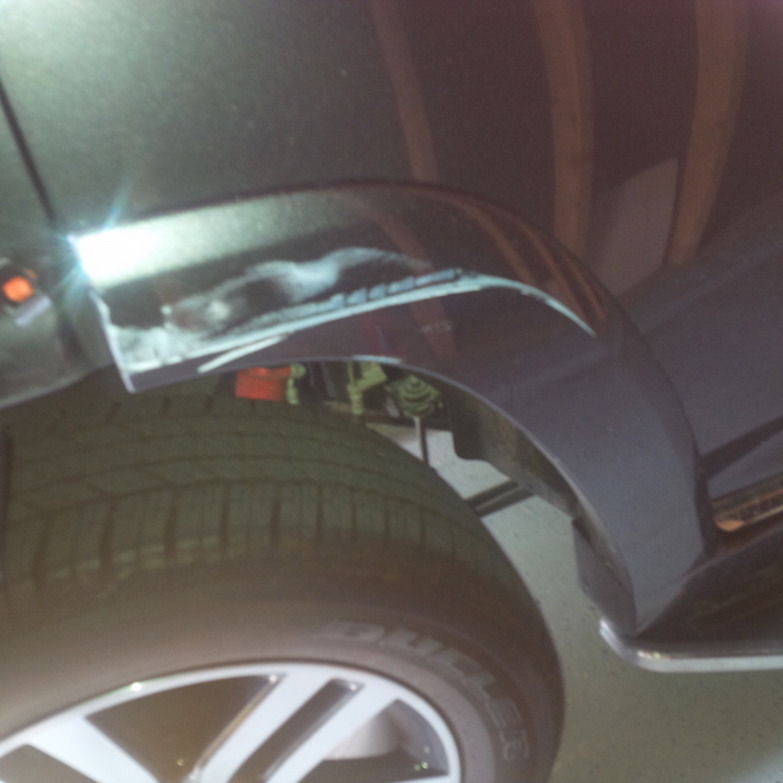

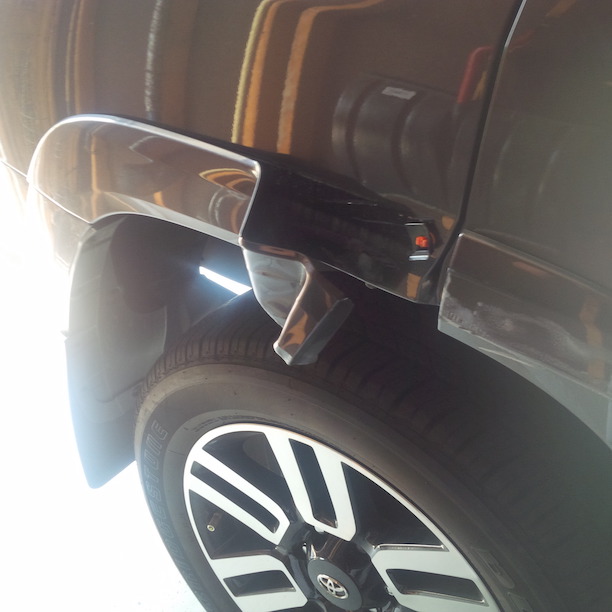

I have a 2014 Limited 4Runner - my first 4Runner! Anyway, I was just parking my car about 10 minutes ago and had trouble because someone decided to park their car in front of my garage. I thought I could maneuver my car in and I was being extremely careful, but unfortunately I still scraped my car for it's very first ding. The scrape is on the Passenger Side Rear Fender.
Anyway, looking at it, it appears the parts that are damaged are plastic and clipped on. I don't think there's any major damage to the car in general. I was actually wondering if anyone on this forum could help me determine if it's something I could simply replace (snap off scraped parts and snap on new parts). I attached a few pictures of the damage.

That looks like the correct part to me. I am not sure if those come color matched, or if you will need to get them painted after the fact.
I don't think they do come painted. But it doesn't look like a special paint so a body shop should be able to source the flares, color match, clear coat, and reinstall.

I would say no you can't fix it properly. Looks like that clip is all but ripped out and deformed. Removing the damaged pieces without damaging the other clips may prove challenging. Plus you have some damage behind that moulding that will require some body work to allow the new pieces to fit correctly. I suggest you bite the bullet and let a reputable body shop do the repair and repaint.
It looks like a shadow to me and a new fender, paint and some clips and he is back in business.
Agreed it's hard to really tell from the pics. However, there are two pieces damaged. If they have to be primed and painted it's going to be tough for the OP to match on his own. I suppose it's worth a shot and use a body shop as a last resort.
Or plasti-dip the fenders on the other three and just use plasti-dip to paint. I think it looks nice with the black matte on the grey. I dipped all 4 of mine and it looks fair and would be cheaper for OP. Or he can drop off the pieces to be painted at a body shop and install himself for probably no more than a few hundred.

Am I the only one seeing the rear quarter panel bashed, bent in?
You won't get the flare to fit unless you go paintless on that shit and pop it out.
I'd get paintless to straighten that out then get a new clip and plastic fender.
Should only take a day or 2 once the body shop has the parts in hand. Go directly to a body shop and not through the dealer. Look them up online and check reviews and have them do it all from ordering the part to paint and install. Then you only have one place to go if something is wrong.
