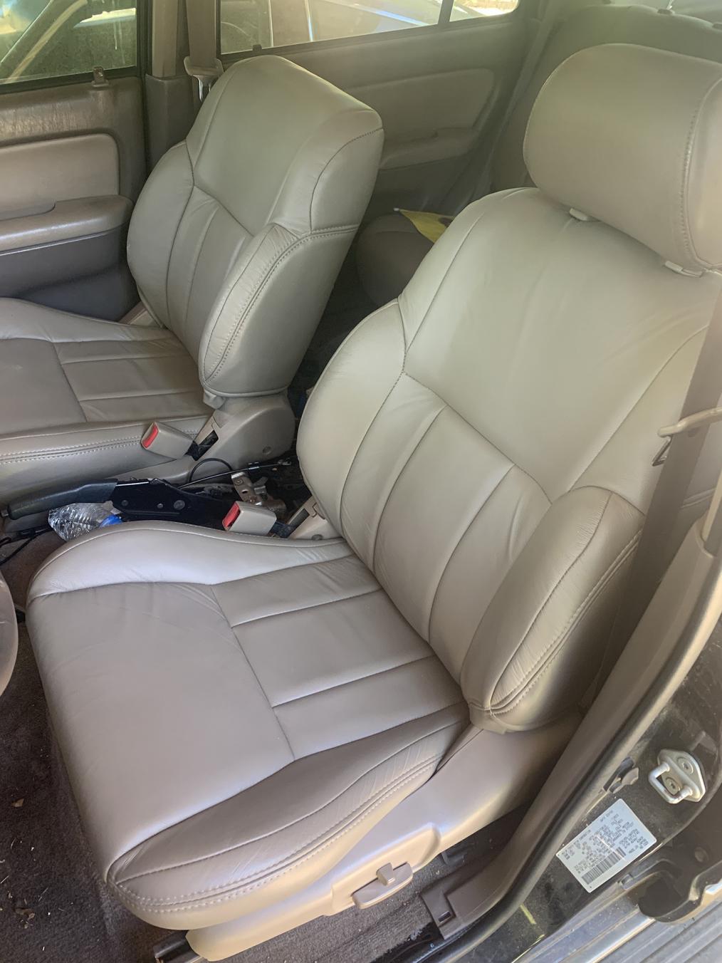

This is a horrible shot, and I haven't put the passenger headrest in, but you can see the color match between the original driver headrest and the new leather.

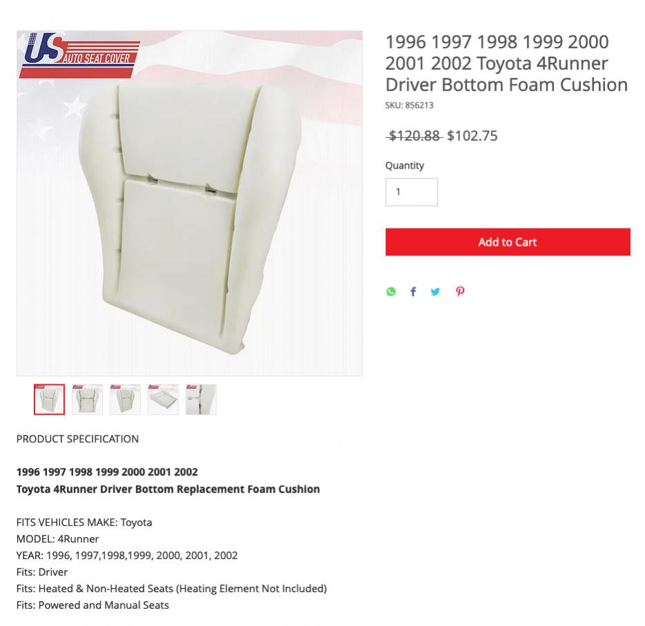

I put new foam in both front seats plus seat heaters. The only thing that would make this product better is if they would start offering a foam upper. Maybe if enough of us start requesting they would make it a priority.
This option is just about as close as you can get to being able to go down to the Toyota parts counter and clunk down a couple grand for brand new OEM seats.

Dang at $219 this is the most cost effective move out there. I may actually just buy the foam itself for $109 and see how that goes. How do they feel now that you've had them in? How was the process with the heated seat? Easy swap?

Holy heck, I swore I looked for these backs when I first did this. Thanks badluck! It makes such a big difference to have new foam, I may at least tear the driver seat back down and put one of these in.

I haven't put very many miles on my rig since the new seats went in, but they've setting down nicely. At first it felt like I was sitting on top of the sit instead of in it. They seem like really high quality material that will hold up.
As far as the heaters, mine didn't come them originally (2000) so I went with some aftermarkets. They were pretty easy to do. I did have to remove the passenger occupancy sensor from the old foam, but if you are careful with it and clean all the old foam off, it's easy enough to use contact cement and attach it to the new foam. So on that side I've got new foam, the old sensor and new seat heater.
So far it all works perfectly.
Will this pad work for a non sport seat?
According to the online parts catalog non-sport/cloth seats require 71551-35040, but that part number is discontinued. I don't know for sure what the difference is between the two, but it's probably a slightly different pad profile on the bolsters. It could also be a different foam. I can't say for sure if they interchange or not. I'm sorry I couldn't be more help.
