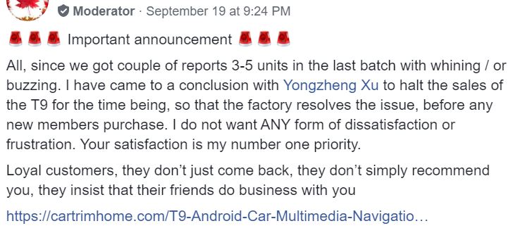

Was considering an order through Car Home Trim due to their FB support but they posted on their FB page that they just put a hold on any more T9's shipping out due to a high pitched whine from the HU when installed. Good news is that it appears that the company is quick to replace as needed - not sure about Rhino. Either way, I think I'll hold until I hear more success stories than problems.
In the computer world, we refer to it as "coil whine". Unless you crack it open and replace the component making the noise, you'd have to replace it. Good idea to hold off till this production issue is resolved.
Well damn.... mine will be delivered on Tuesday.....fingers crossed I don't hear the whine!
The only time I ever heard coil whine on my PC is when I'm working in the Unreal Engine. It's so loud it's, scary. Sounds like my PC is about to explode. Apparently it's normally for a lot of people using Unreal. There is no way I could EVER stand hearing that noise in my truck when I'm driving.
