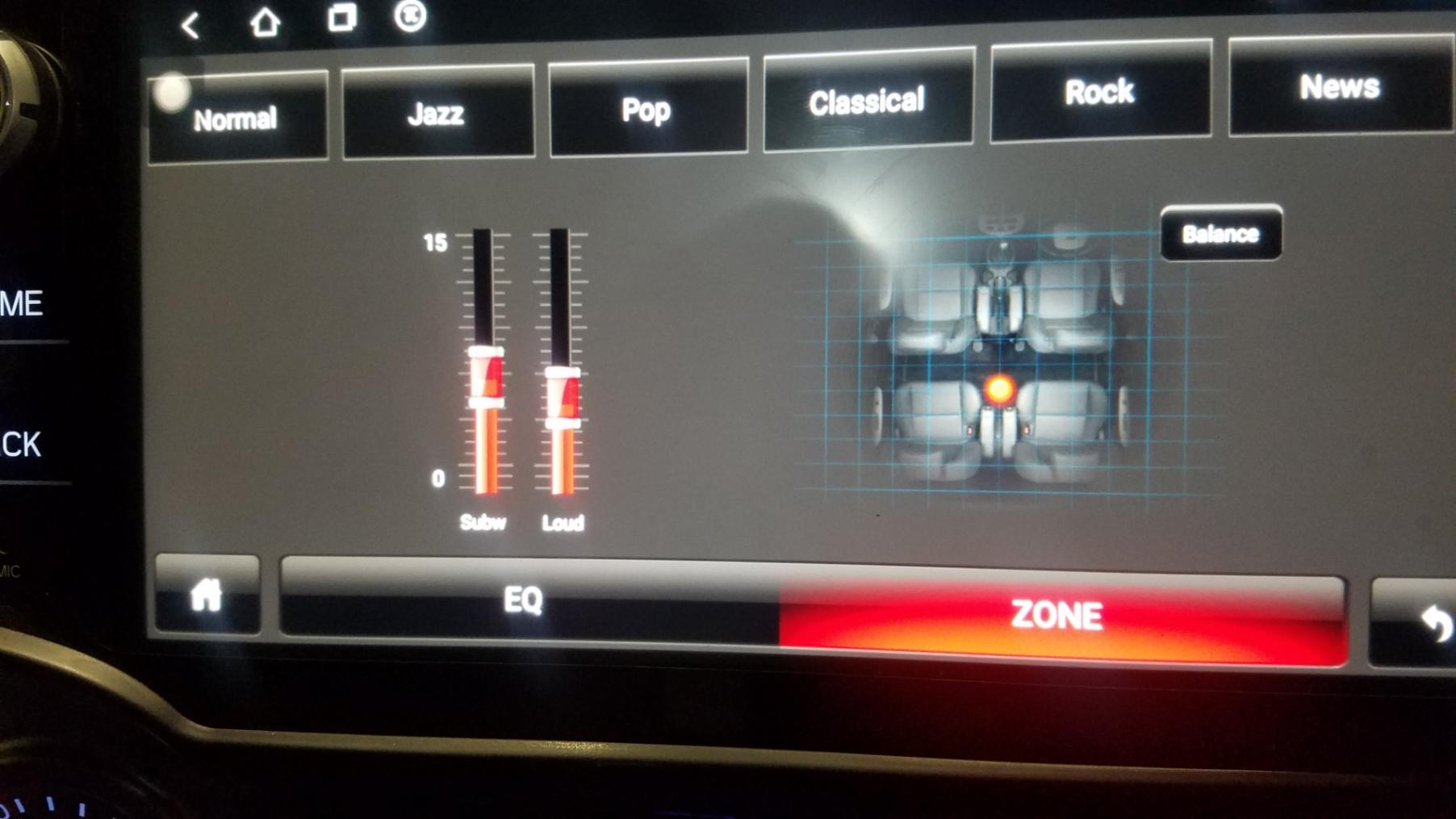

Hey gang, I have a T8 headunit and, despite others with issues, I love mine. I just built a subwoofer enclosure and got my amp wired up only to find out the I dont seem to have any signal coming from the preamp sub out (GREEN) to the rcas. I checked the voltage and don't see any. Is there some software setting I have to click to enable the preamp out for the subwoofer of am I doing something incorrectly? The EQ app nor the Aux app seem to have anything indicating activation of the sub out line.
Guidance please!

The T8 and T9 are not similar units. You might have better luck checking at XDA but no guarantees on support. I believe the unit is based on a Allwinner T8.
Some android units did not support a sub out line even though they were equipped with one. Not saying that's the case here but I would verify that first. Could be as simple as enabling something in factory settings menu but I'm not sure.

Thanks man! I thought the software might be comparable (albeit upgraded) and therefore a setting someone may have encountered. Its annoying to think that the Sub Out may not even be functional despite being part of the hardware. I guess I may have to tap a high level signal and install an LOC. UGH, more wiring!
Yeah they do weird things with these units sometimes. Try contacting the vendor you bought it from to verify sub function on your unit. Or maybe try to pm someone who has a T8 to verify with them. Good luck.
