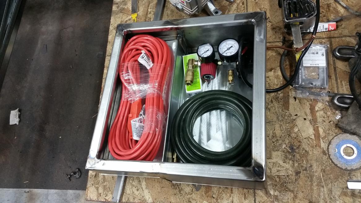

Rough case assembly and placement. Had to turn a 90 with the air chuck. I'll make up something to roll the hose and cord on. Probably going to mount those to the door for rolling them up. I'll be able to organize air chucks and adapters on the inside that way.

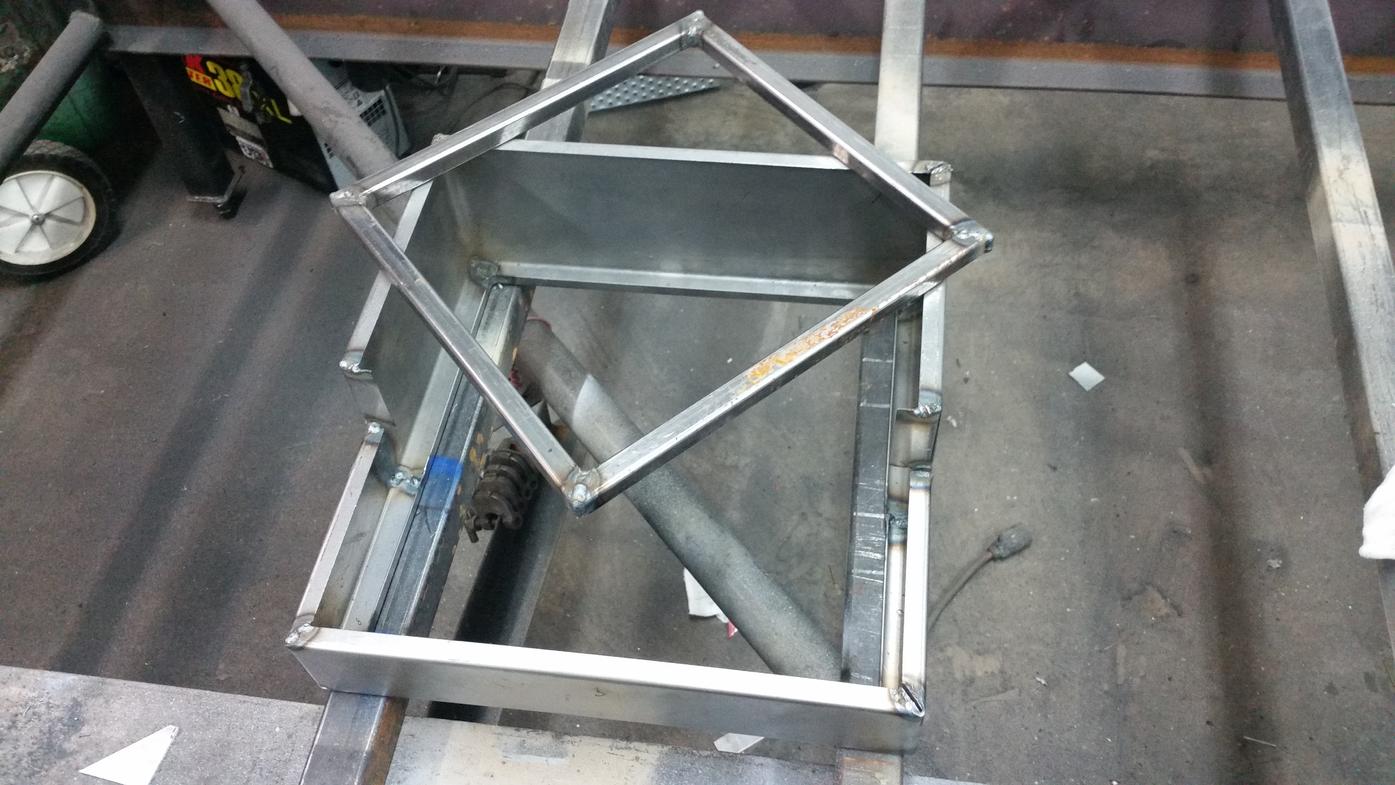

Started the frame for the access door. Next is coming up with a frame for the gasket and a way to lock it from the inside.

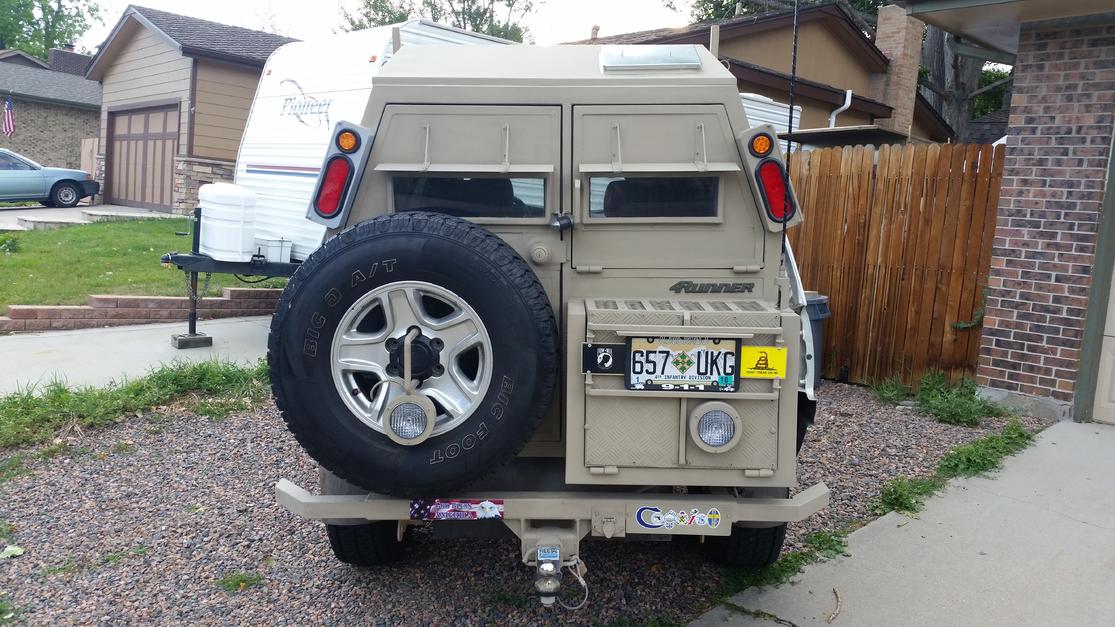

I've been missing the flat brown paint, so I found a darker shade and started painting. It looks better with the silver I think.

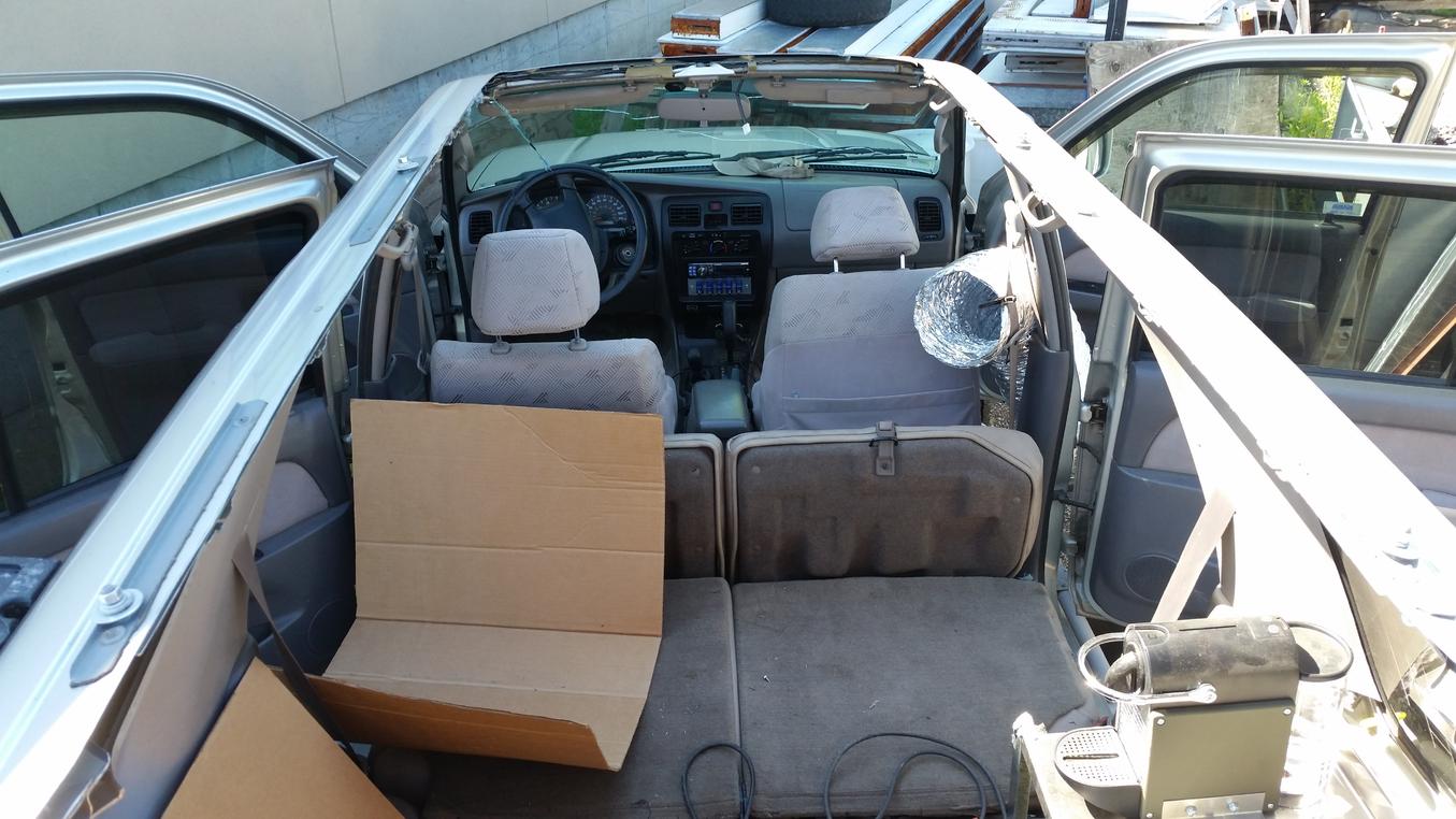

Here ya go. Everything on top is temporary to keep the rain out. It'll be nice when I get the top made.

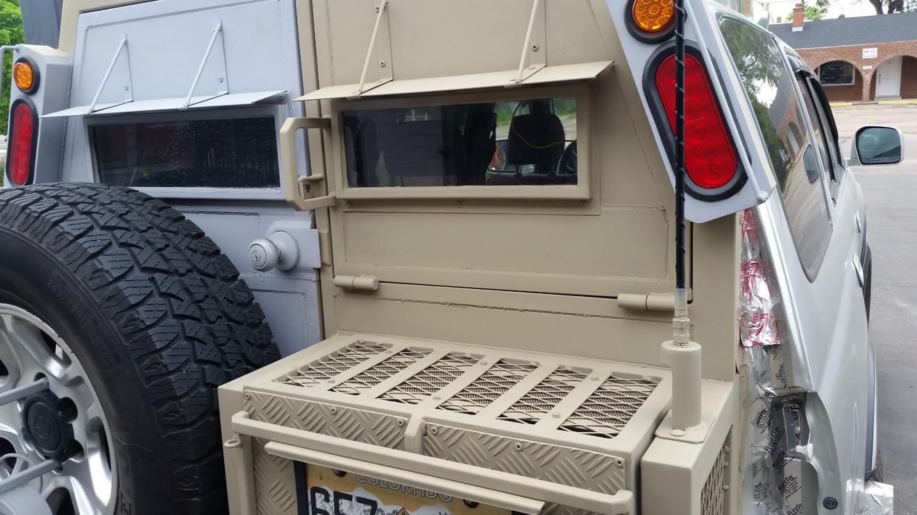

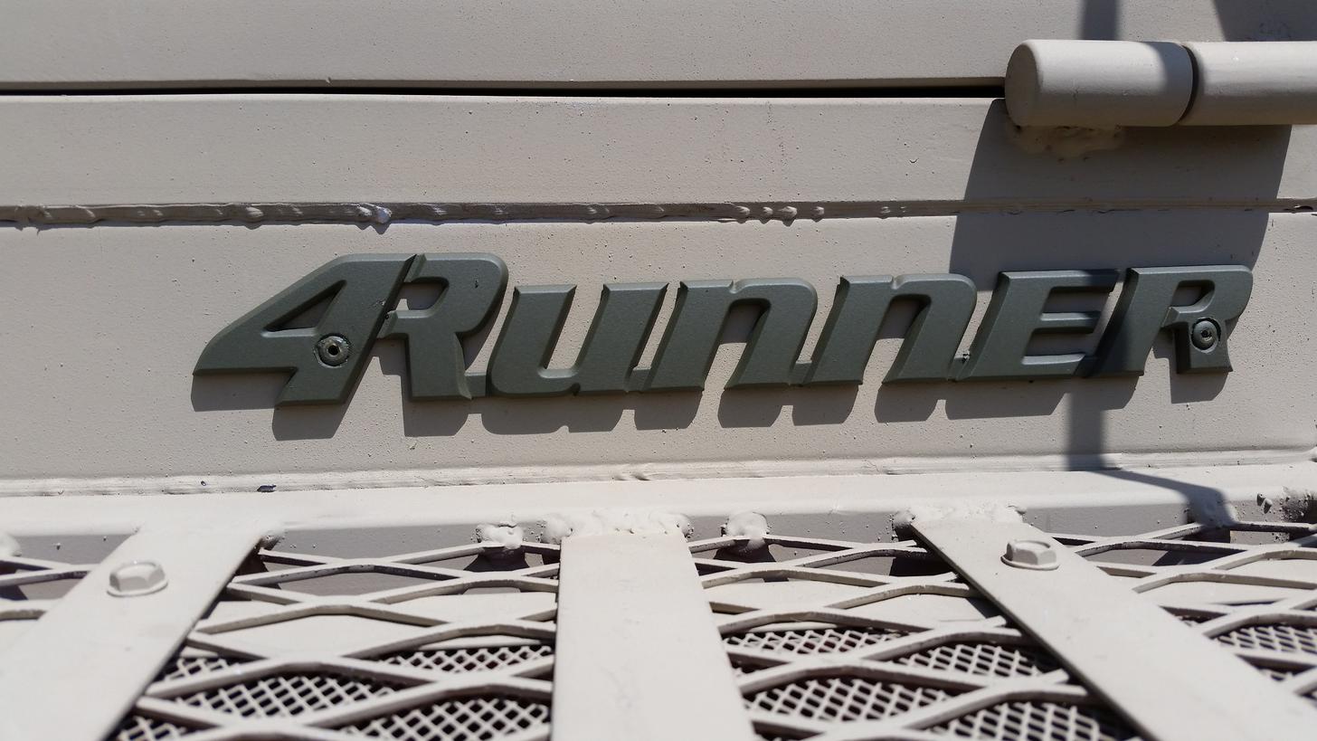

Put an OD green 4runner badge on the back. Got it off one of my tailgates and drilled for the rivets.

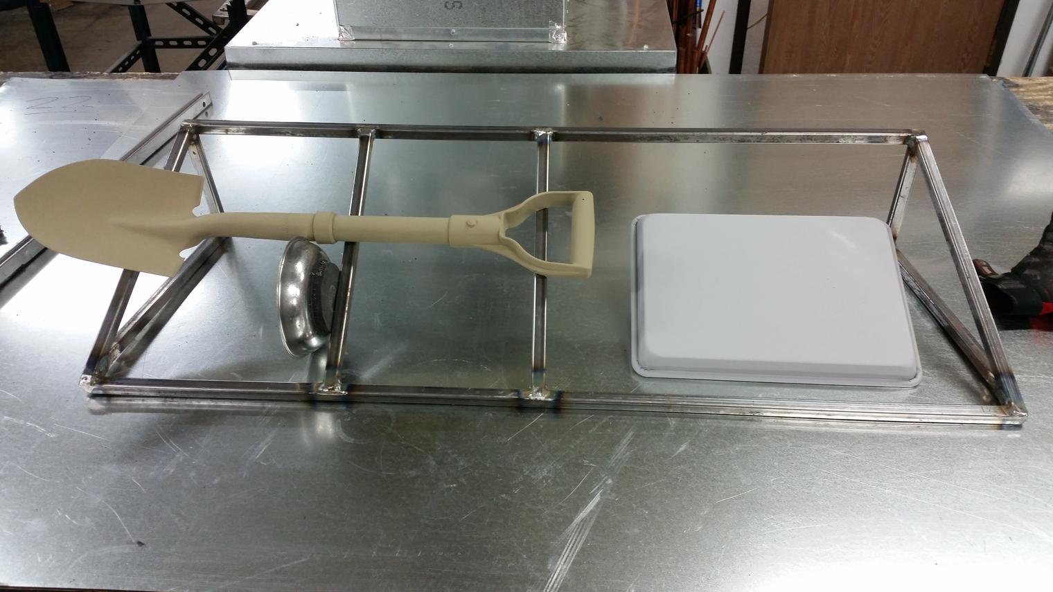

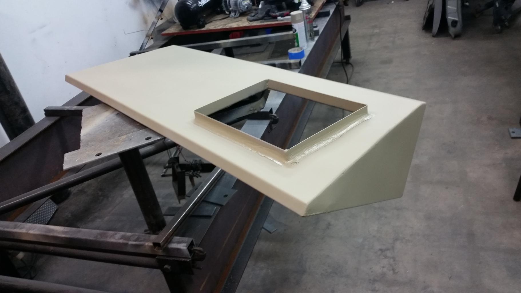

I have a frame for the back roof. I'm making a lockable mount for the shovel and an open able door for an evaporative cooler. I'll start to skin it with metal monday.

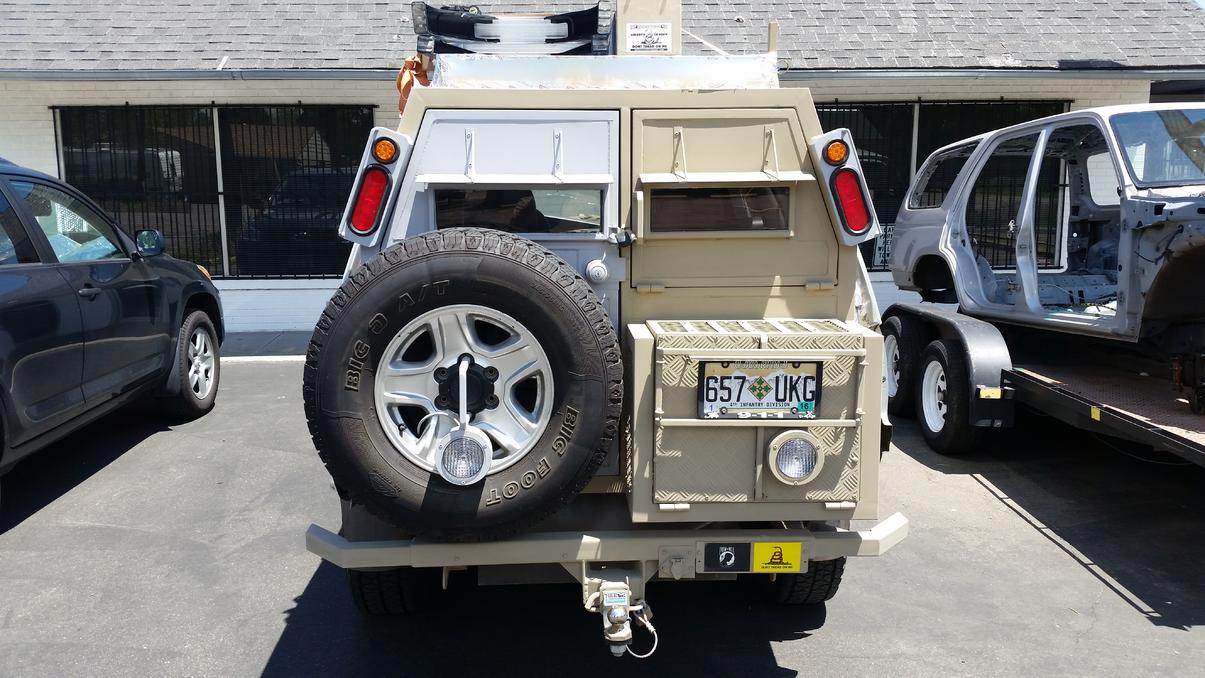

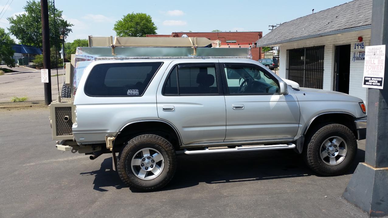

Finally, no more galvanized top visible from the back. I'm going to work on hinges for the cap and a shovel mount next.
