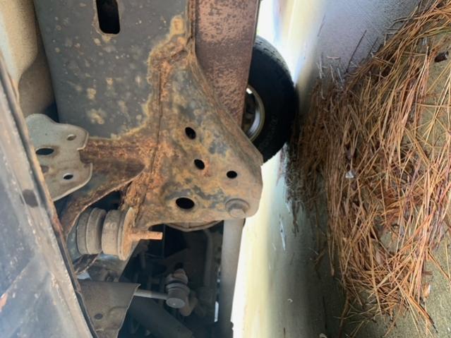

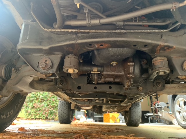

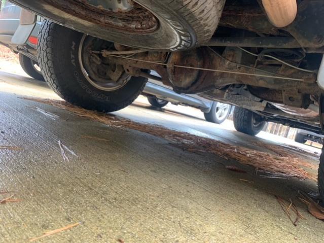

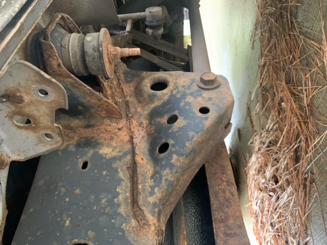

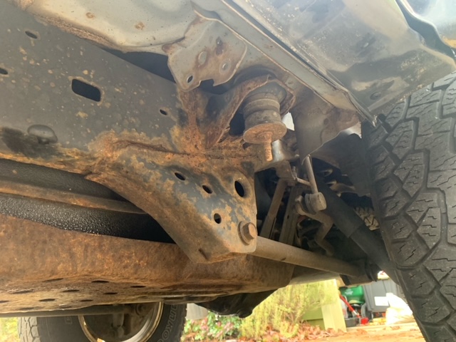

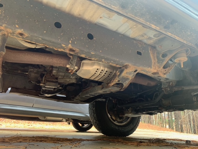

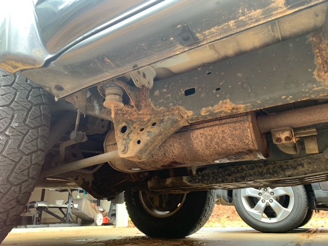

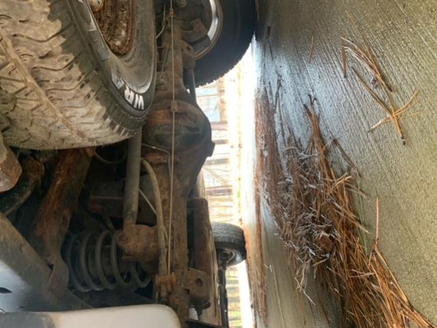

I emailed a guy about a 3rd gen today. He sent the attached pictures. A couple of quick questions:
1. Is this a southern car, or does it look like it's been up north in the salt?
2. Is there enough rust to be worried about it?
Thanks!

Not a ton of visible rust, but more than my TN 4runner. Sadly, it's the inside parts that tend to be the worst, and those aren't pictured. And especially the one that's right next to the exhaust (pass side), the heat makes that the single worst place.
Thanks!
I'd be hesitant to say it lived in salt, but I'd also be hesitant to say it's a southern car, they typically hold up pretty well. Could be very coastal I suppose, salt from the sea air will rust cars as well. Either way I am but a simple yank and a good ol boy will have to chime in for a definitive answer
Definitely not too much rust, rust will almost always start on weld seams before spreading out so realistically it's in a fairly good place to try and save. But like Brian said the inside of the frame can be way worse than the outside so I would definitely take a peek. However I think many of the salt belters here would agree in so far so good
Looks mostly surface. But I’d still want to bang on things with a hammer and see if you can push a screwdriver through any of the weld seams.
IMO you really need to get eyes (and hammer or screwdriver) on the INBOARD side of those lower trailing arm mounts.
Best of luck!
