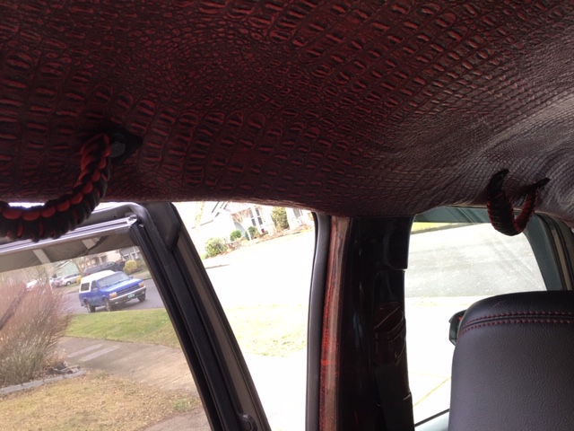

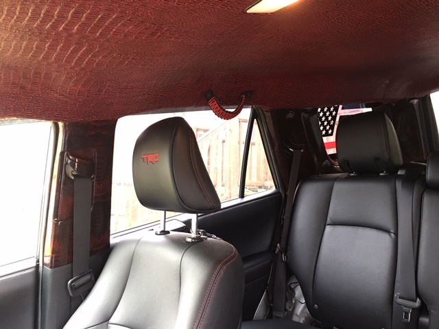

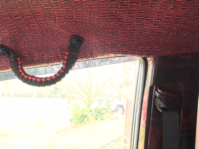

Interior is starting to come together, got some of the plastics back from hydro dipping and I installed paracord grab handles in place of the factory plastic ones. Love the handles they are so comfortable to grab onto.

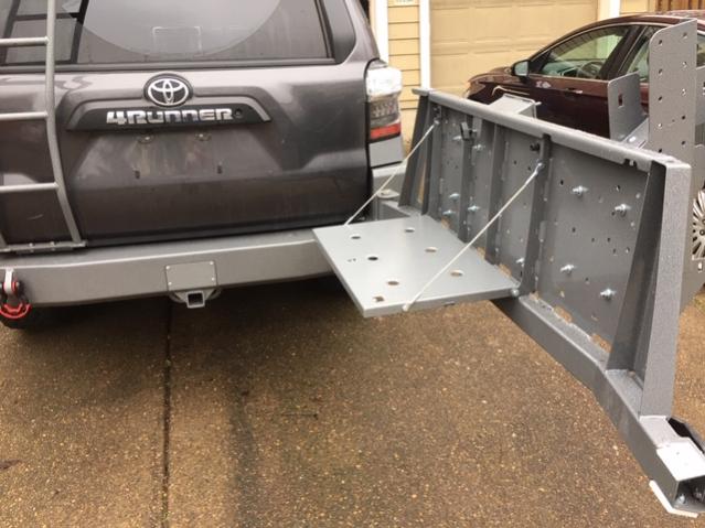

So got my bumper back from powder coating. Didi it over a couple days a little each night after work.
Looking better once I started getting accessories mounted. The C4 bumper is a bit heavy at 250 pounds but it is also the most bullet proof one made on the market I think. The details of how its built and reinforced impressed me.
I love the camp table that folds down that will be handy. Still need to get some maxtrax which will mount next to the rotopax containers.

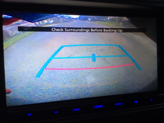

I relocated my factory camera and C4 includes a bracket for relocating the camera and the view is great.

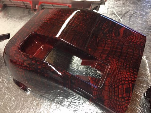

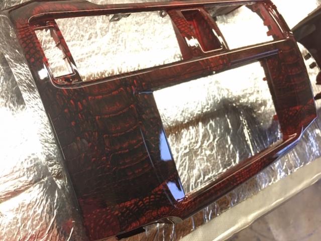

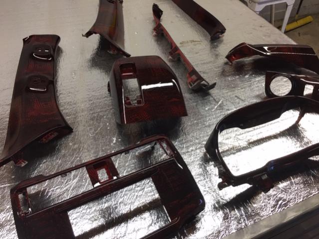

And I also got the rest of my interior pieces back from getting hydro dipped. Let the online haters ranting begin lol
I think it looks great and will not look like every other 4runner on the road. And it's not the typical rice burners carbon fiber. So they can piss off lol

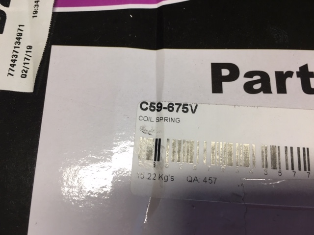

Ordered some Dobinsons 3 " lift rear springs to replace the spacers I have now in back. I just ordered the soft ride ones
C59-675V Rear Variable Rate Coil Springs

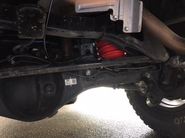

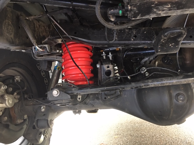

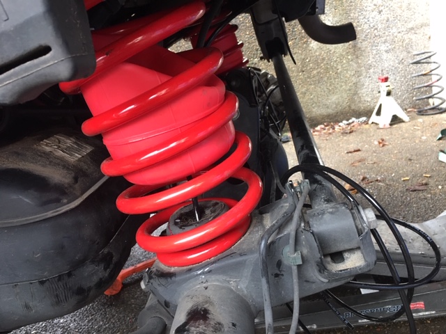

Today I installed the Dobinsons 3 inch lift springs and airlift bags. I got the 3 inch for stock weight 4runner because I wanted a soft ride so they sag a little with the weight of the bumper but with the airbags in too I should be able to adjust the height. We will see how this goes. I might find out I should have gotten slightly heavier rated springs.

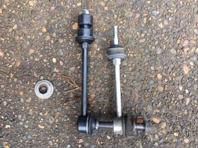

While I was doing the springs it was easy to replace the sway bar links with longer ones. I can't remember for sure but I think these were for a 4th gen 4runner? which are one inch longer so it levels out the sway bar closer to factory spec so it works like its supposed too.
Anyway they are an exact fit and went right on easily, could have swapped these out in 10 minutes a long time ago. Either way best and easiest $25 I've spent on Amazon lol
Just a few more pics of them installed. The longer sway bar links just make the sway bar sit parallel to the ground like its supposed too.
You'll probably notice too I still have the bilstein shocks on the rear even though I have the KINGS up front. Doing all this in stages so havn't ordered the rear Kings yet. But soon
