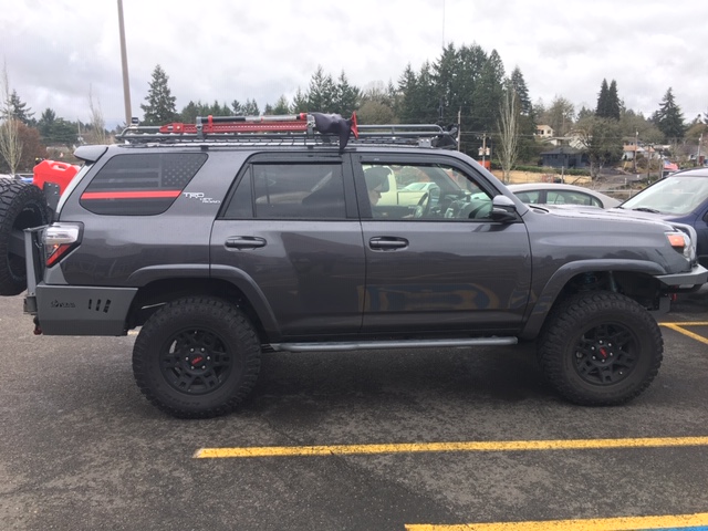

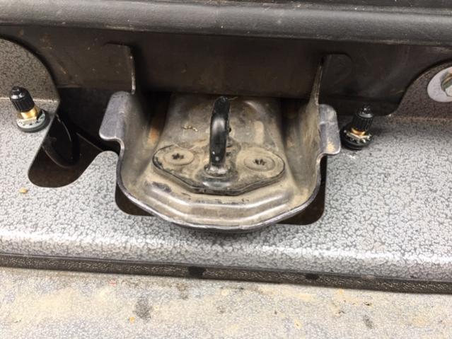

Here is where I put the fill valves next to the rear hatch latch and a quick side shot after driving to the store to settle the springs

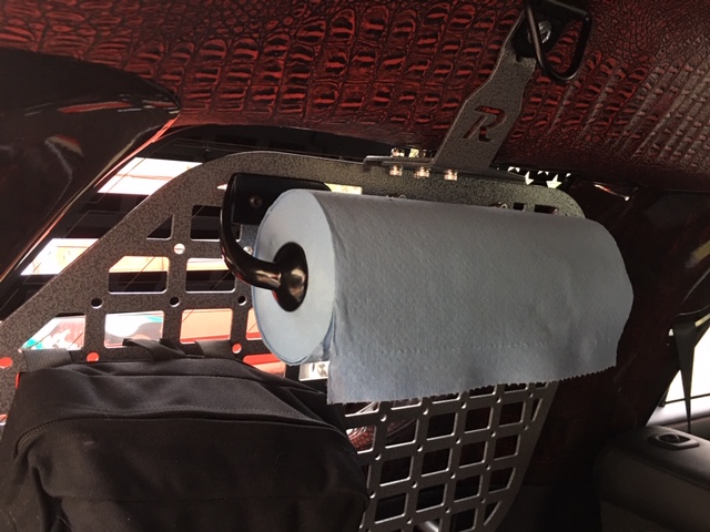

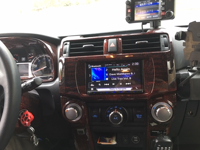

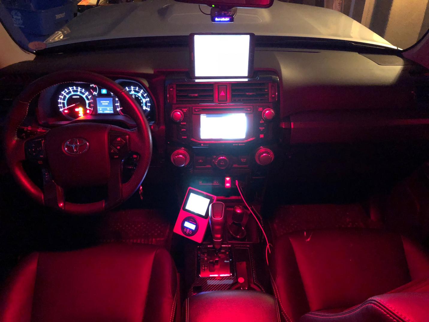

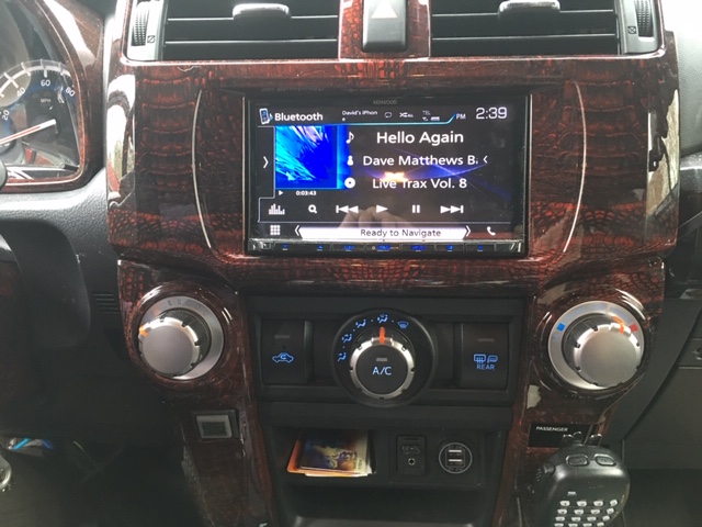

And I've been getting more of the interior finished today. Got the radio bezel installed. I really like how it came out.

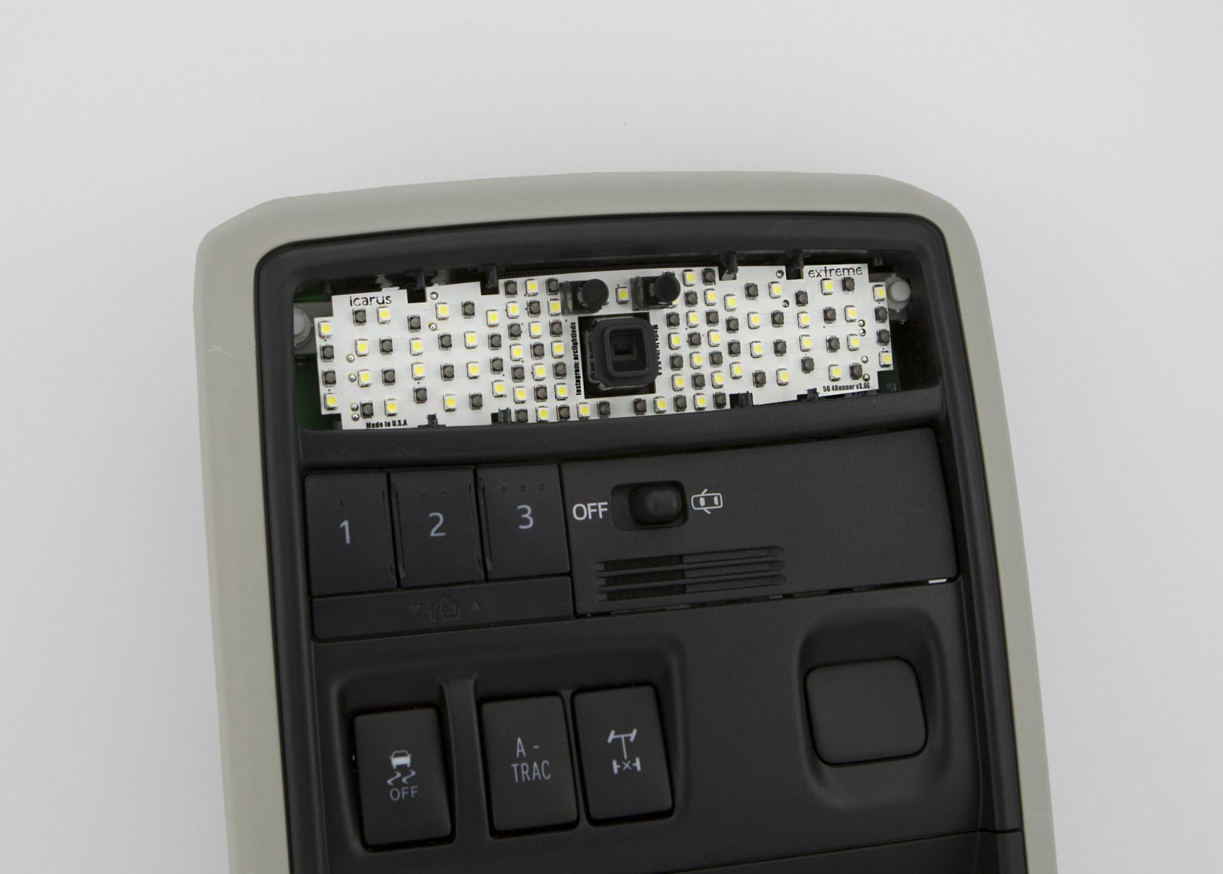

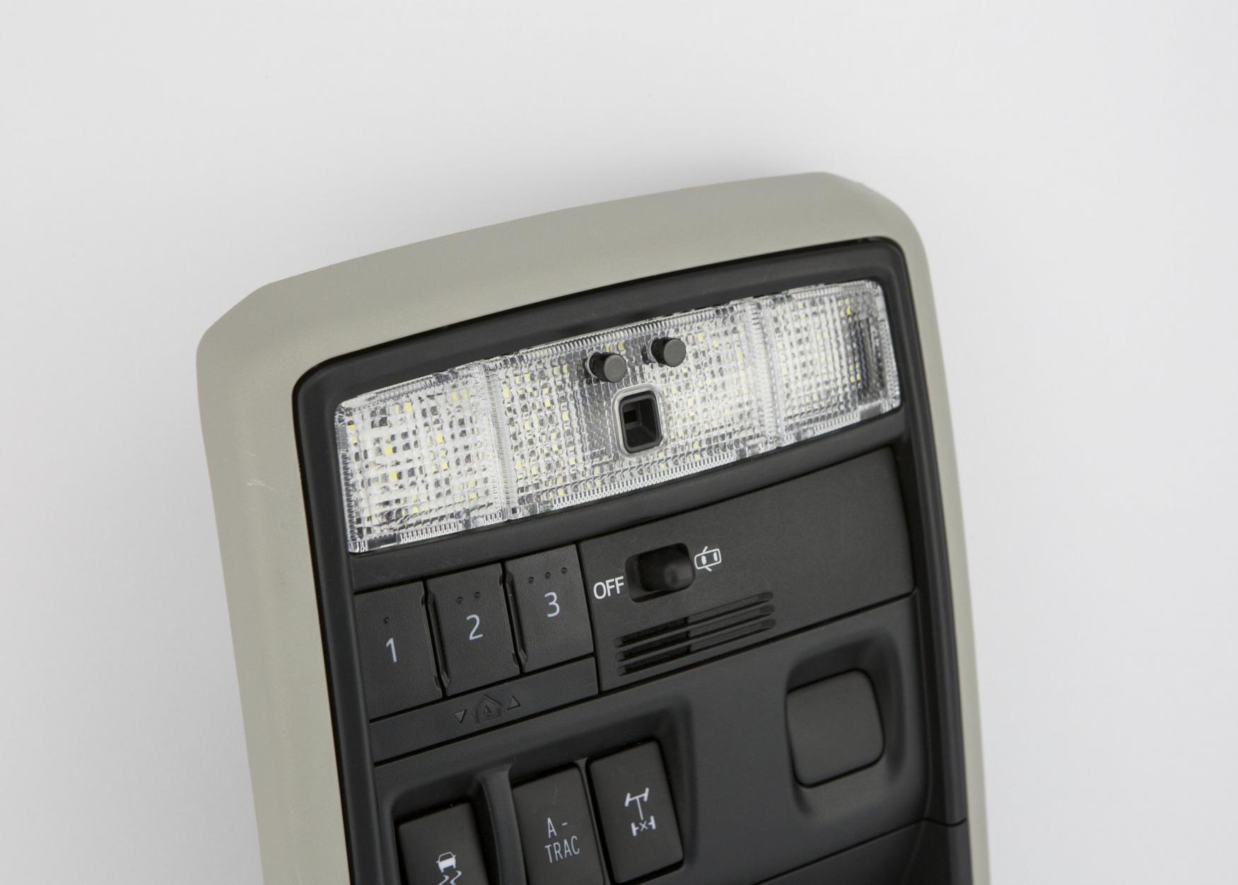

a little updating on the interior lighting. I replaced the front MAP light with the ARCLIGHT with red and white leds. you push the button for red or white. red to save your night vision. Spendy but awesome

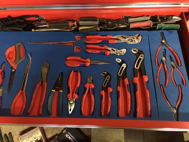

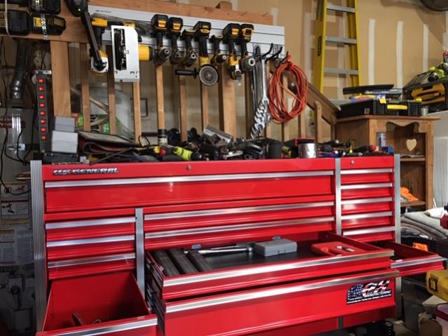

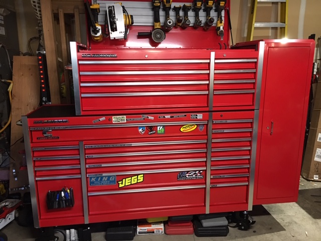

Just upgrading my tool box today, just got the bottom box for now, will get the top one later. Trying to get better organized.
Cutting foam for tools is tedious!!

Still needed more room so went ahead and got the top box and side cabinet. Should have plenty of room now lol
Started putting my various stickers on it to make it mine. I need some 4runner or toyota stickers

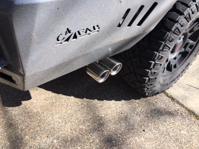

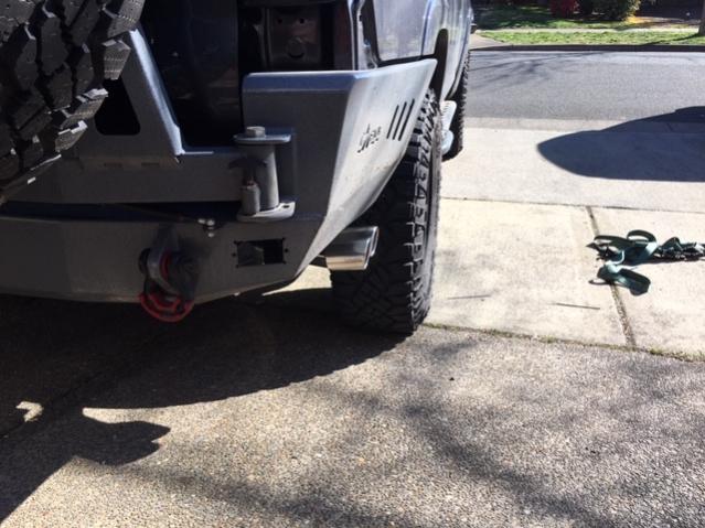

When I installed the C4 rear bumper I cut off the exhaust tip to get it out of the way, the instructions said you could just pry it down a little but I idn't like it. So I bought this stainless dual exhaust tip welded on a 90 degree pipe and mounted it. I think it looks pretty good and with the side exit less prone to getting crushed and no more issue of exhaust coming in the back window when its down

Yes, insane! but in a good way. that rear setup has got to add a tremendous amount of weight to your rig. i had something similiar on my jeep tj and when all the bumpers, sliders were added, that baby was heavy.

yes the bumper is 250 pounds so its heavy but I knew it would be, any over landing vehicle is gonna be heavy. Just have to build the suspension and drivetrain to match the weight

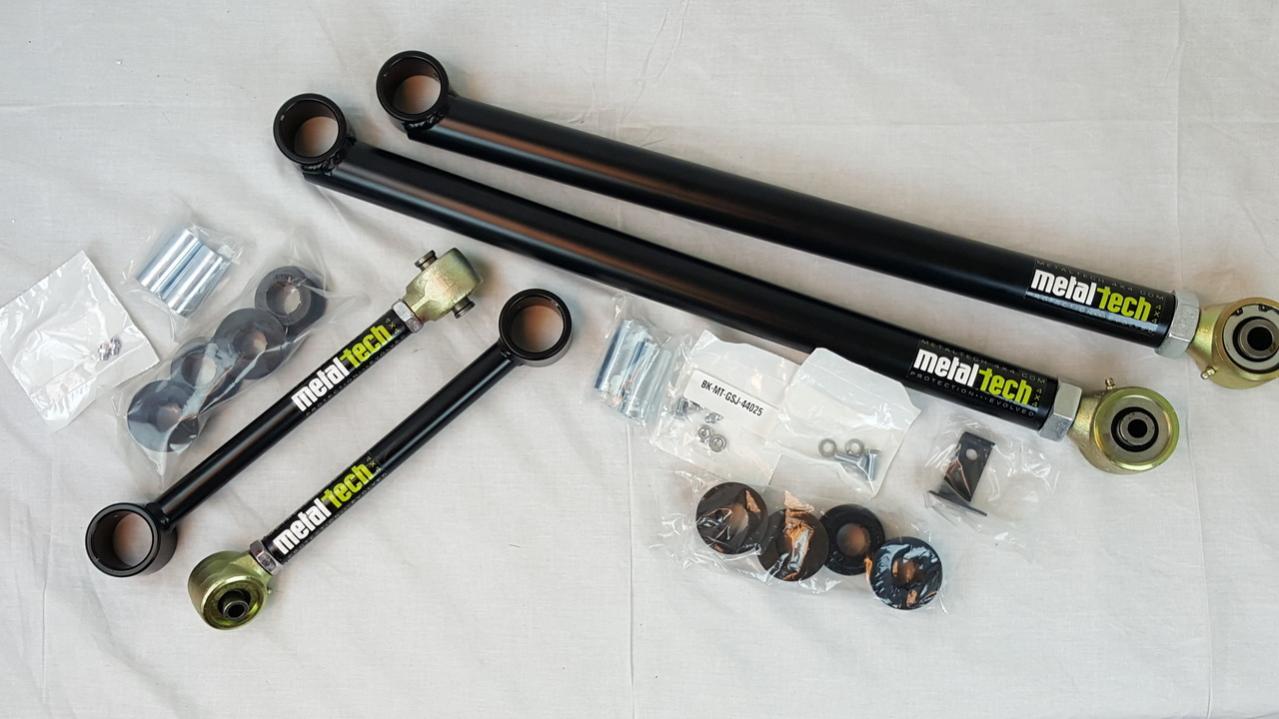

Ordered some metaltech 4x4 rear link arms today to get my pinion angle corrected again and center my rear end

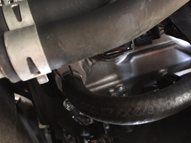

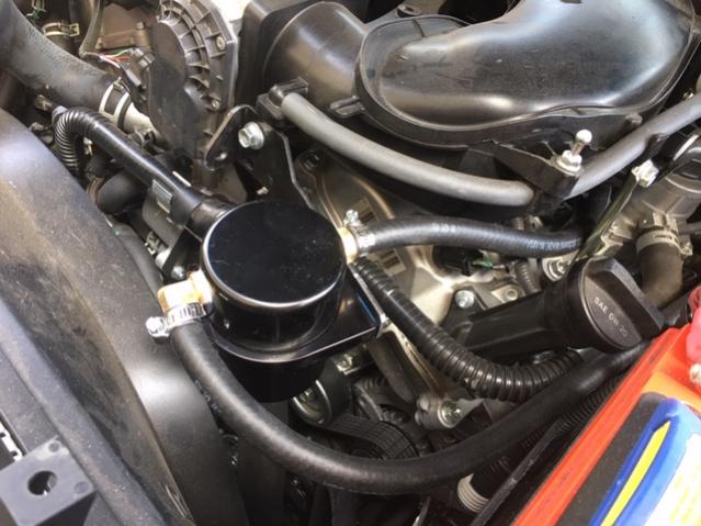

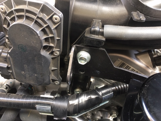

Today I installed an oil catch can, good thing to do on any engine. Ran it off the PCV valve into the catch can then back to the intake where the PCV originally went back in.
I used an existing bolt on the front of the engine to mount it here, as a pretty easy mod only taking half hour of sorting out where to run things and mounting.

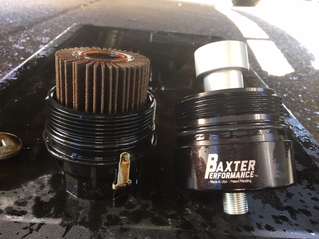

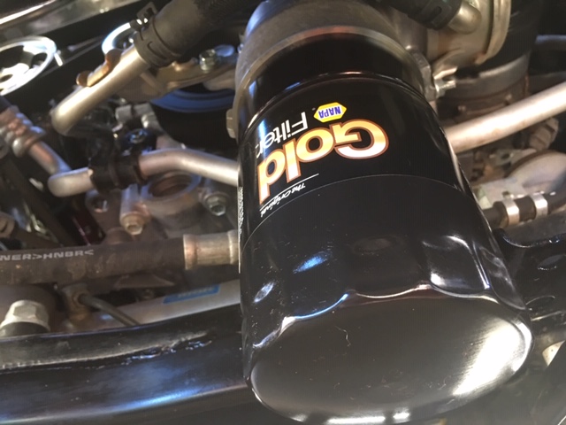

Changing my oil today and finally get rid of that STUPID toyota cartridge filter!

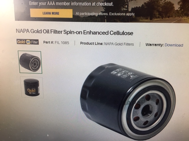

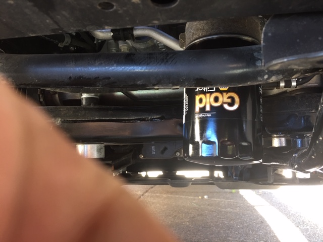

I bought the Baxter performance aluminum adapter that bolts in place of the factory cartridge then you just spin on a regular filter. I used a NAPA gold 1068 filter but it did hit the skid plate slightly so I researched and found the NAPA gold 1085 filter is the way to go, it is just an inch shorter than the one I used and would clear the skid plate fine.
For now I just cut a little off the factory skid and will change it next time. Im planning on getting proper skids later anyway. But if you are keeping the factory skid the 1085 filter should be the ticket

I should have read the red print on their webpage and I would have know ahead of time lol. SOunds like the TRD skid or equivilant would clear fine. But its also a matter of which filter you get because they come in all different lengths
Quote from their webpage "Spin-On adapter does not offer sufficient oil filter clearance due to stock skid plate venting profile beneath the filter housing. We recommend TRD or other aftermarket skid plate to achieve required clearance."
you might need some skid plate spacers.
