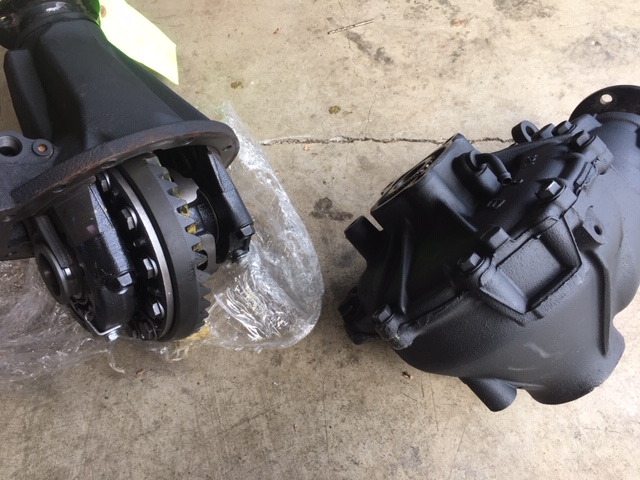

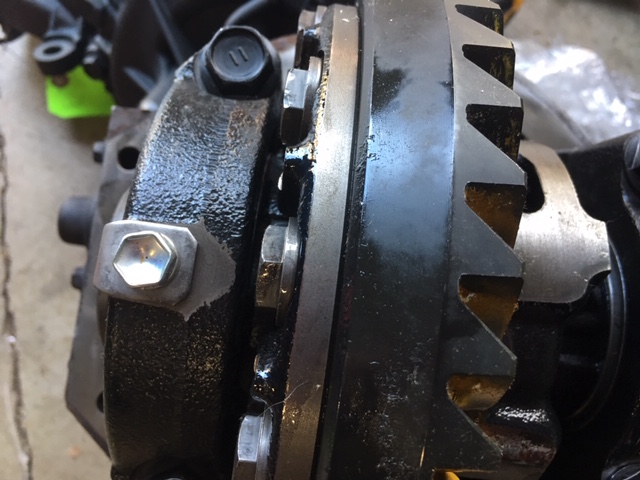

4.88 gears arrived today! What I like about East Coast Gear Supply is they build the diffs for you and you just swap them and return the old ones to get your core back, quick and simple that way.
Hopefully Ill get this done next weekend

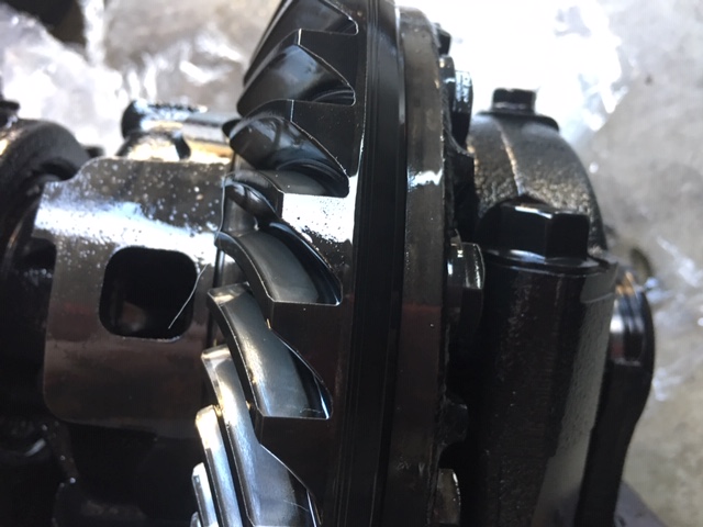

Look at the difference in thickness of the 4.88 gear from the stock gear, almost twice as thick lol Had a hell of a time getting new diff to go in because the gears didnt seem like they would fit. they scraped a bit on the outside of the case going in and had to wiggle the pinion back and forth but the rear is finally in
Front and Rear Gears are in finally, had an issue with the rear being locked and a bunch of lights flashing on the dash, turned out I had installed the rear locking motor with the internal gear in the wrong positon. Had to drain most of the oil and flip the little gear in the hole to the opposite position and reassemble. Whew! Finally done and successful test drive

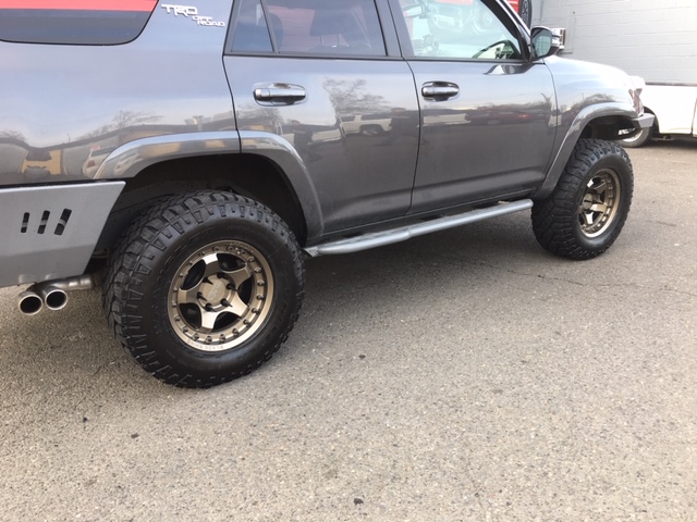

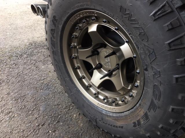

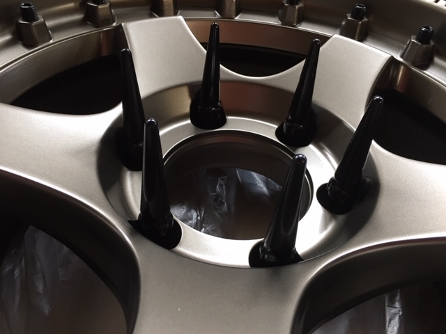

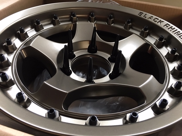

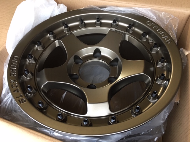

I got some Black Rhino Bantam bronze wheels and some steel black spiked lugnuts, gonna look badass once I get them mounted. I was gonna wait for the 35" tires but I can't wait lol Gonna mount them now

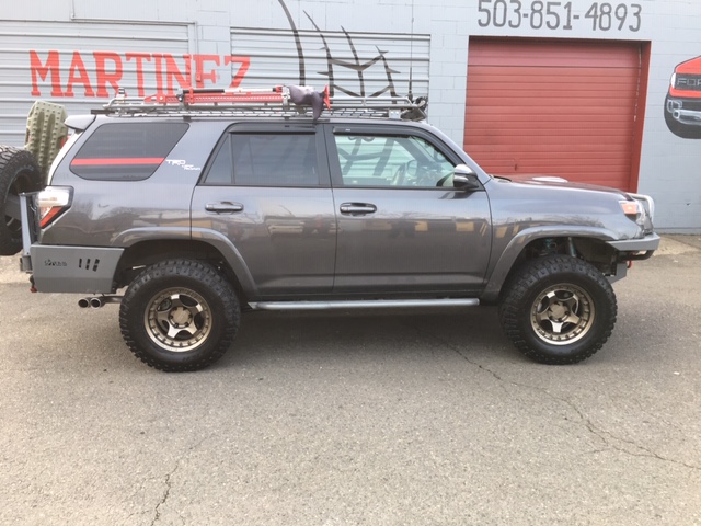

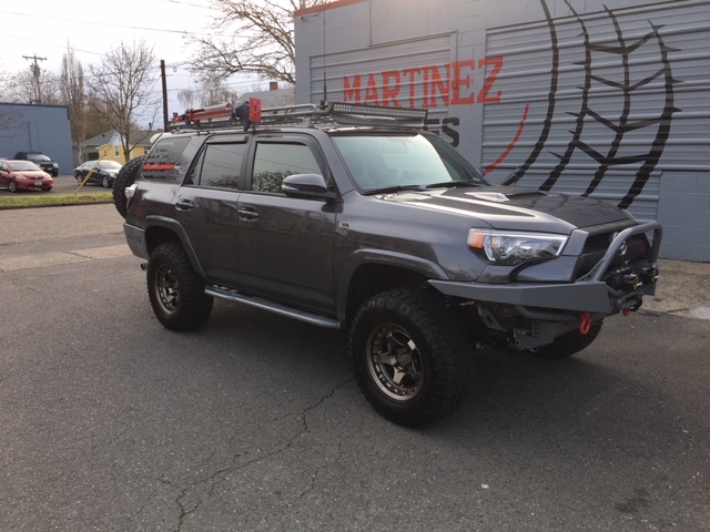

Mounted! I don't care what the haters say it looks bad ass lol some people just have different tastes though. But it definitely looks mean

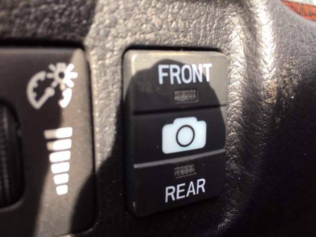

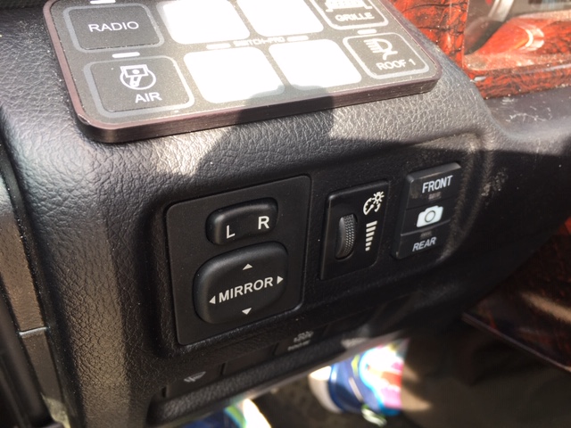

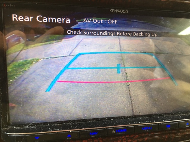

Today I installed the wiring and switch from anytimebackupcamera.com so that i can utilize my rcok camera and with the flip of a switch can view the front or rear camera at any time while driving.
I realize its not the best placement for the front camera as it will get hit. Later I will move it up into one of the holes on the bottom of my bumper to better protect it.
But the idea of being able to see over a drop off im going over or see a potentially dangerous rock underneath will be useful I think.

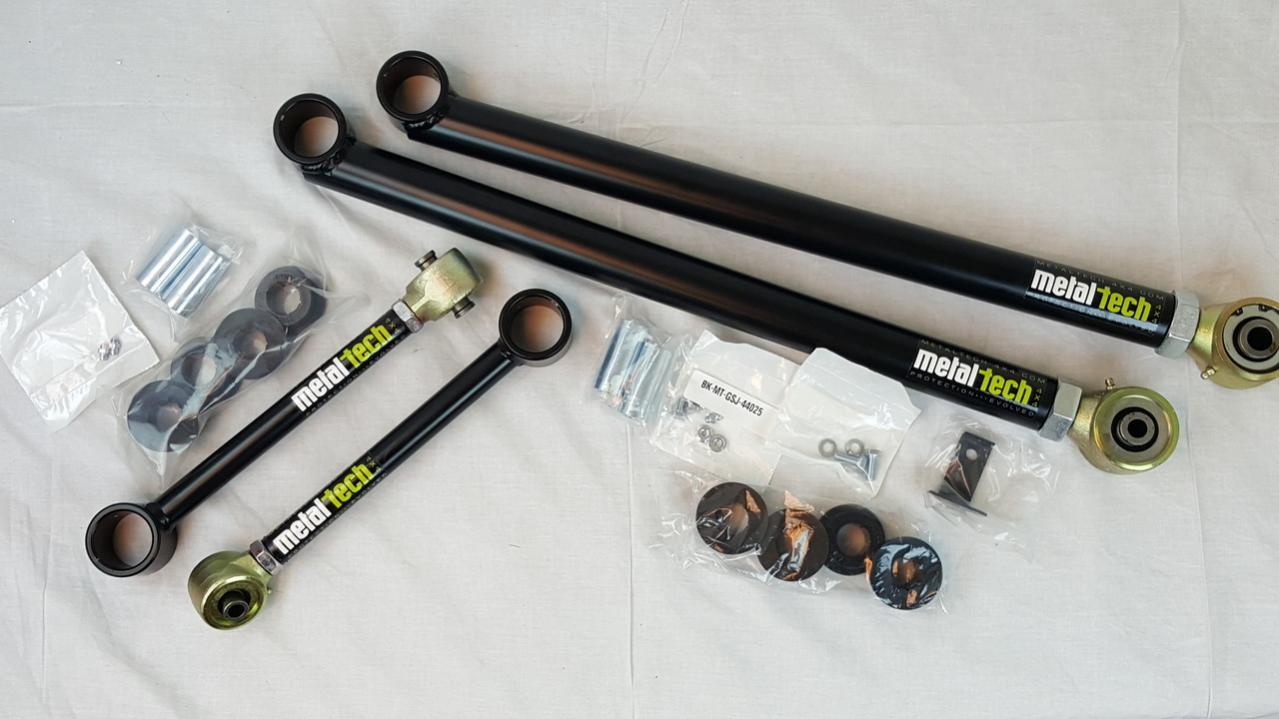

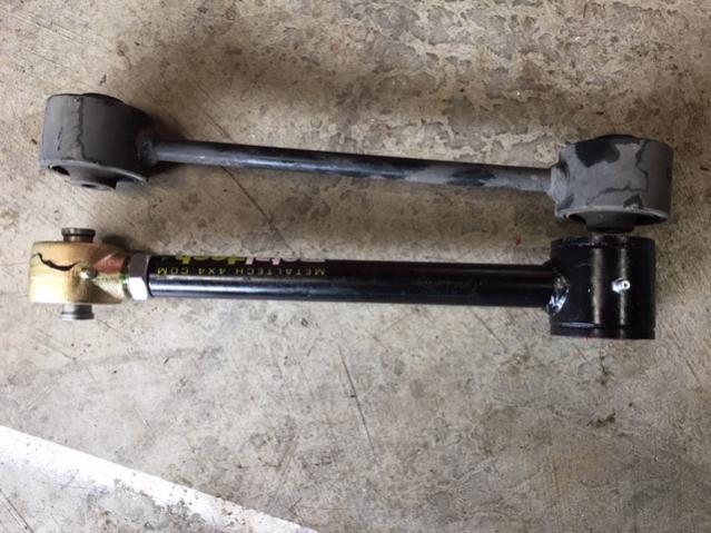

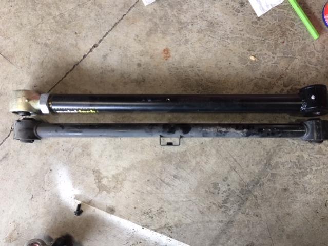

I got my Metaltech 4x4 rear links installed this week. he uppers you can see a huge difference in size the lowers I don't know how much stronger they are or not but feel heavier. The main point hough is just being able to adjust them slightly longer about 1/4" to compensate for the 3 inch lift and put the axle and pinion angle back where they should be.
Im also gonna order the panhard correction kit soon and get that welded in

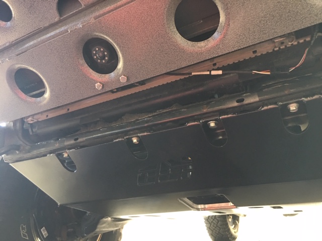

I am impatient, I hate waiting but I ordered an SSO roof rack with extra cross bars and my CBI skid plates in aluminum.

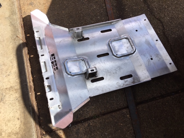

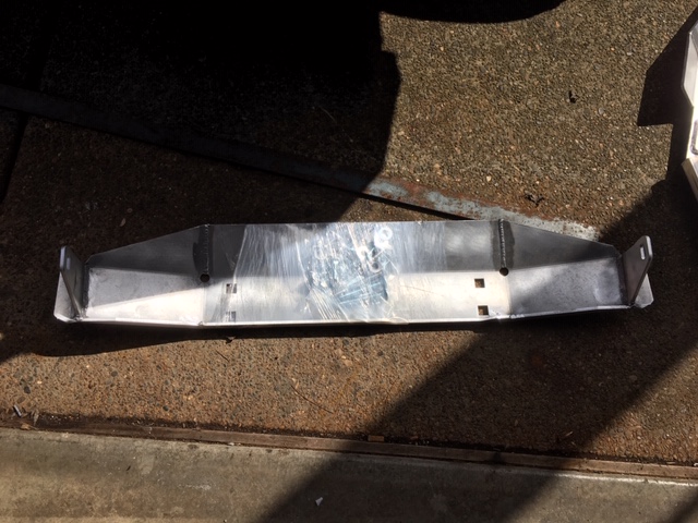

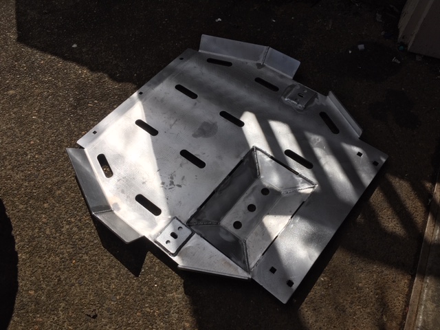

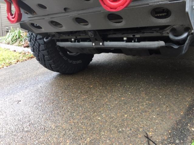

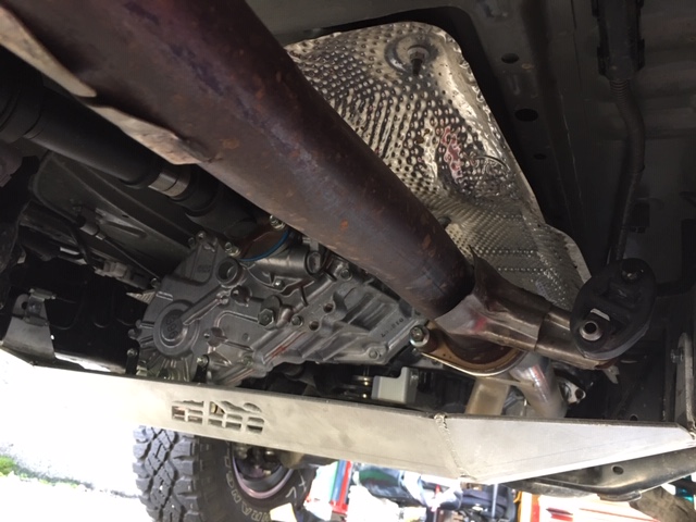

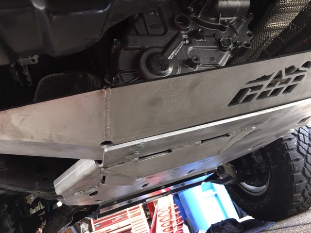

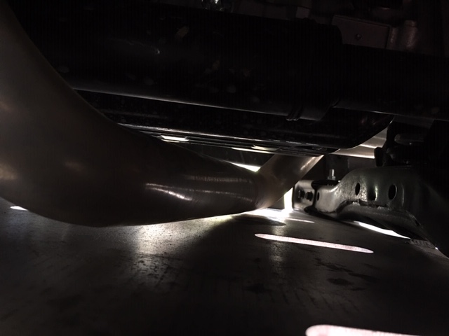

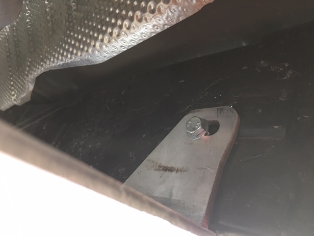

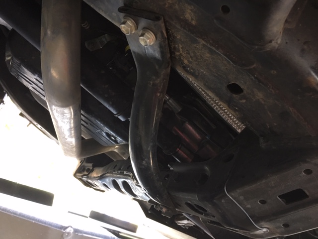

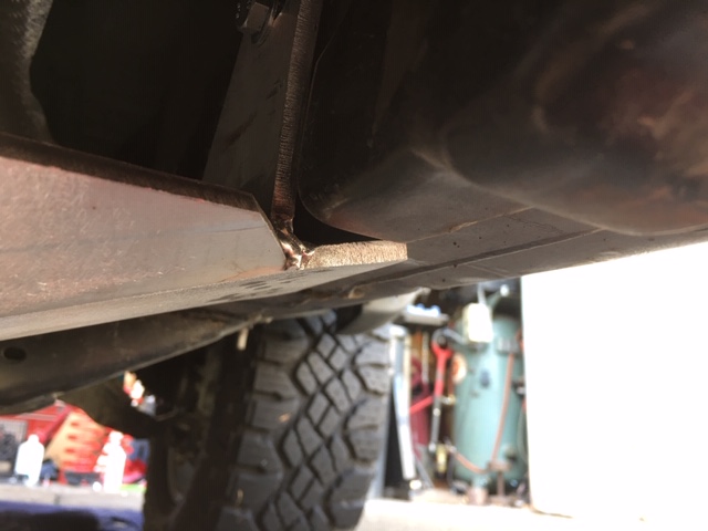

Ok so I just got my CBI front and rear skids today installed and this is my experience. These were the aluminum front and rear.
First, man the clearances for the holes are super tight so it took a lot of wrangling to get them all on and bolt holes lined up. Had to use the bolts themsleves and a ratchet to bring everything together.
You definitely need to run a M8x1.25 tap into the bolt hole for rear crossmember because the factory paint in the threads will not allow you to thread in the bolts.
The instructions need to be updated with a few things. I also found that I had to remove the factory braces ant the rear crossmember, that was not in the instructions at all.
Also, I was missing several of the 3/8-16 nuts so I had to run to the hardware store.
You can see in one pic below that my URD Y-pipe just barely clears by 1/4" I think the factory Y-pipe would hit it for sure!

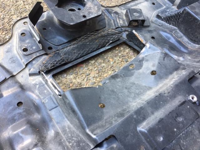

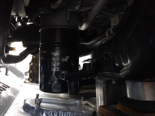

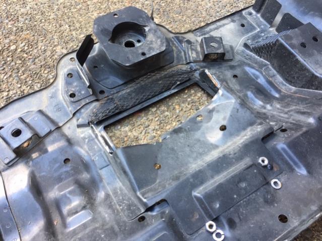

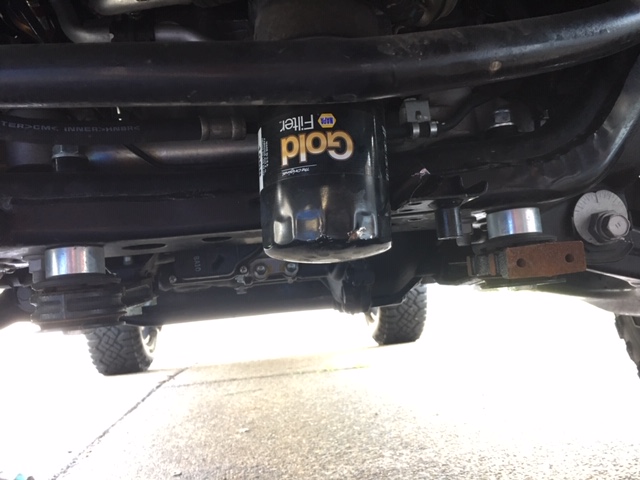

Also I had installed the Baxter Performance oil filter adapter a couple weeks ago so I could use a regular spin on oil filter.
I had to modify the factory skid to clear the filter I used because of the piece sticking up on factory skid I had to hammer that a bit and cut some out.
With the CBI skids it cleared great with 3 inches to spare so that was another plus and seems easy enough to replace filter without removing the skids now.

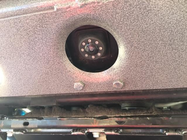

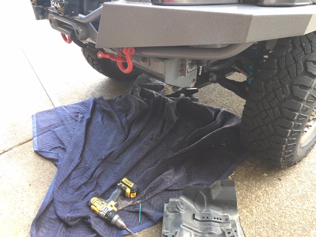

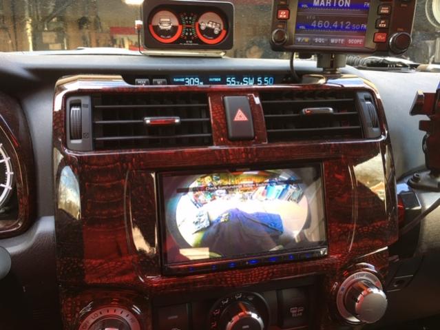

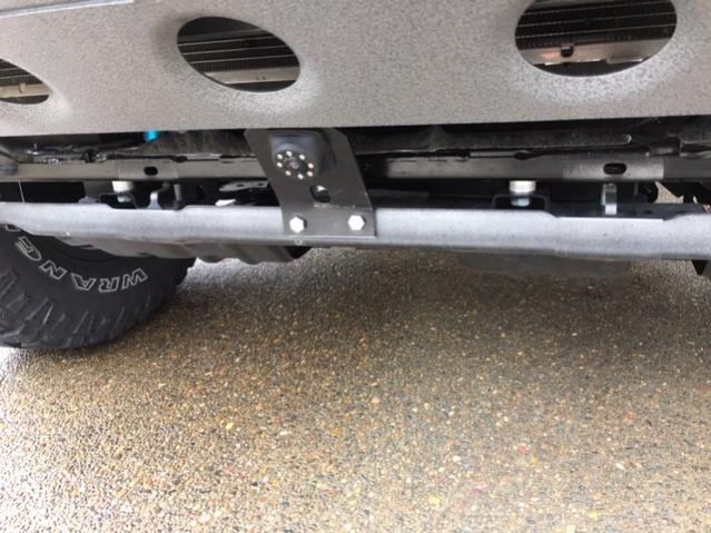

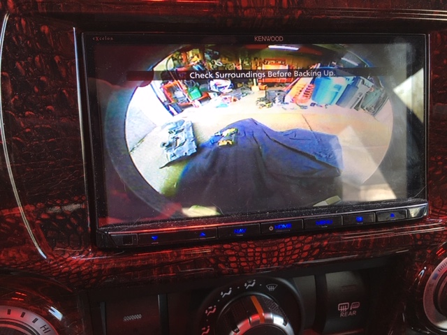

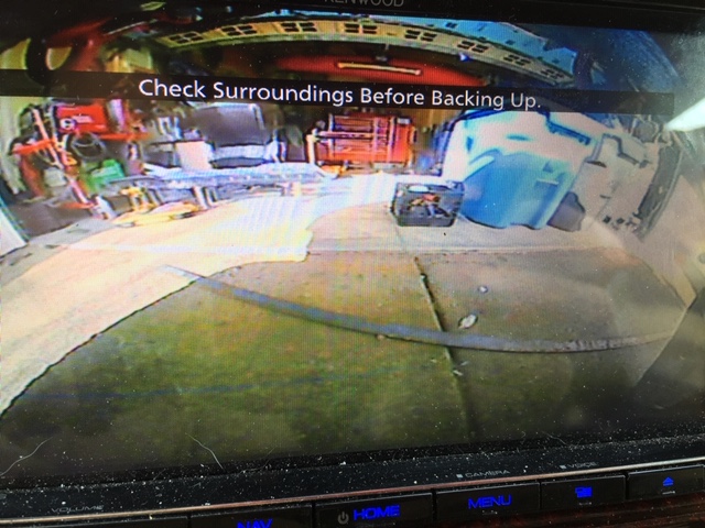

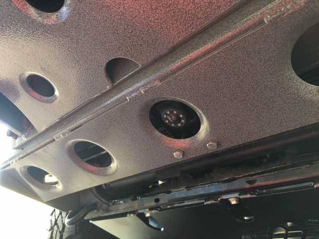

I had also temporarily mounted my rock camera on the factory skid before so after installing the CBI skids I finally got around to installing the rock camera up in a hole in bottom of bumper which protects the camera better anyway.
the pic of the work blanket under front of vehicle then seeing the front view on the screen gives you an idea how super wide of view this camera is lol
And you can see I painted the front skid with the matching toyota touch up paint, I know its gonna get scratched up but figured better blending in a bit than standing out
