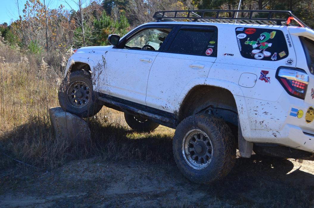

Mine is so bad my left rear tire isn't even on the ground most of the time. :jaw:
Or I guess it could be my driveway? That entry curb is a bear! :shrug:

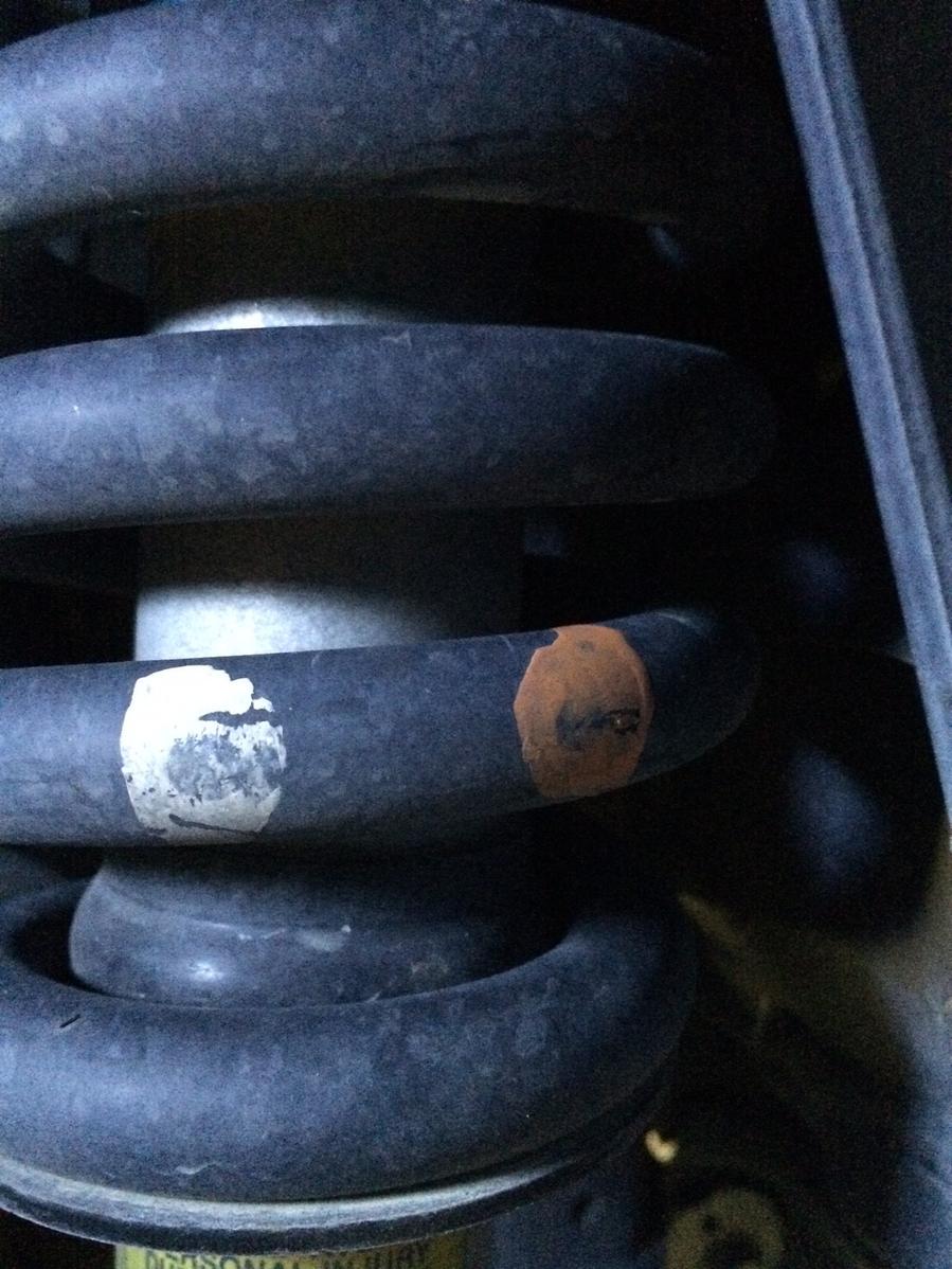

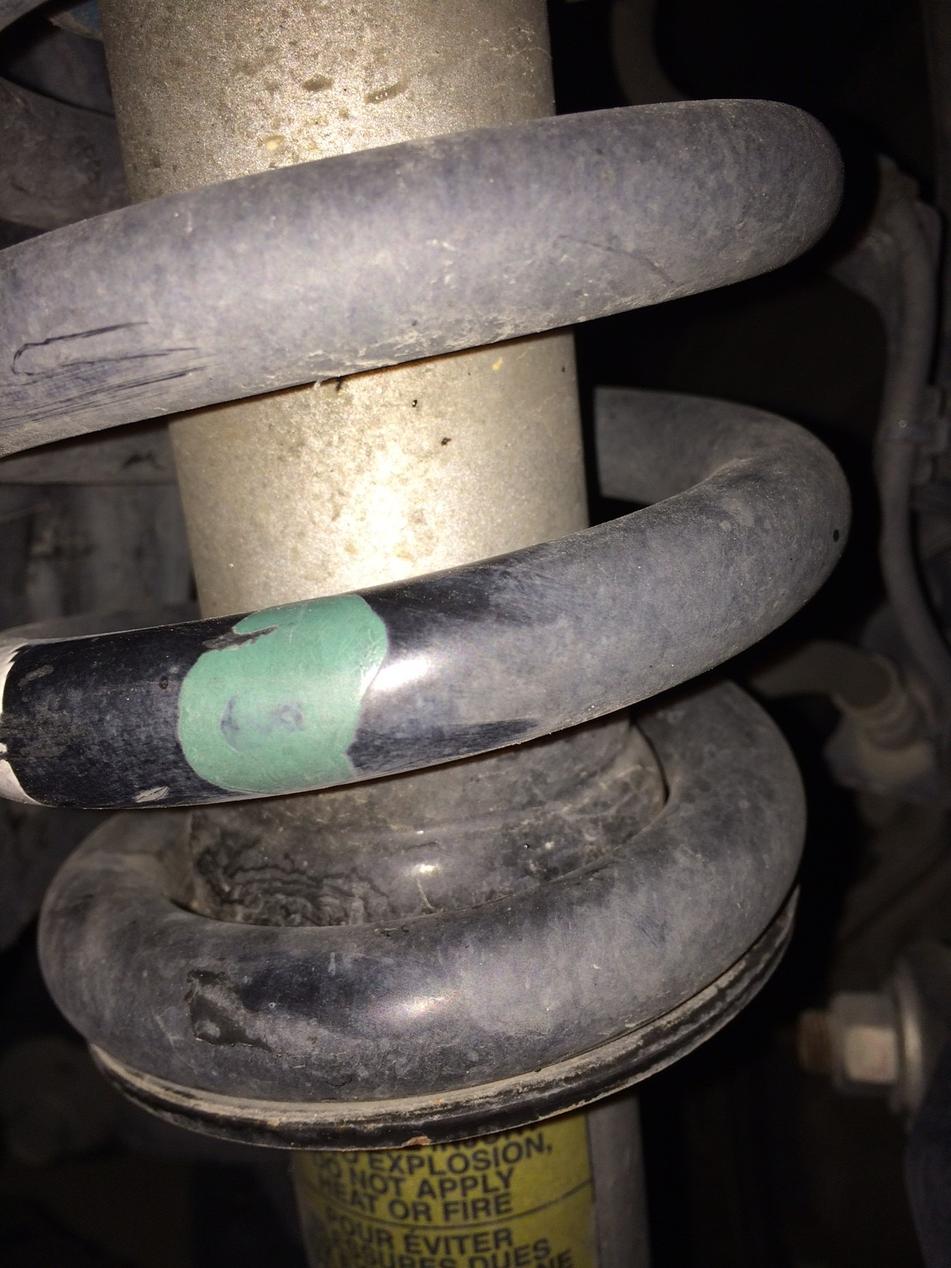

Really hoping someone can prove for me that the white/red should be on drivers side. Went underneath to take another look and snap a couple more shots. From what I counted, seems like the white/red spring has one more wrap on it.
Passenger
20150213_215035.jpg~original
Driver
20150213_214940.jpg~original

My shocks were replaced one at a time, so the springs never had the remote possibility of being swapped from one side to the other. More coils on pass side.
Drivers side: White / Green paint
Pass side: White / Orange paint
Hmmm, see, this goes against what everyone else is saying that more coils should be on drivers side.
