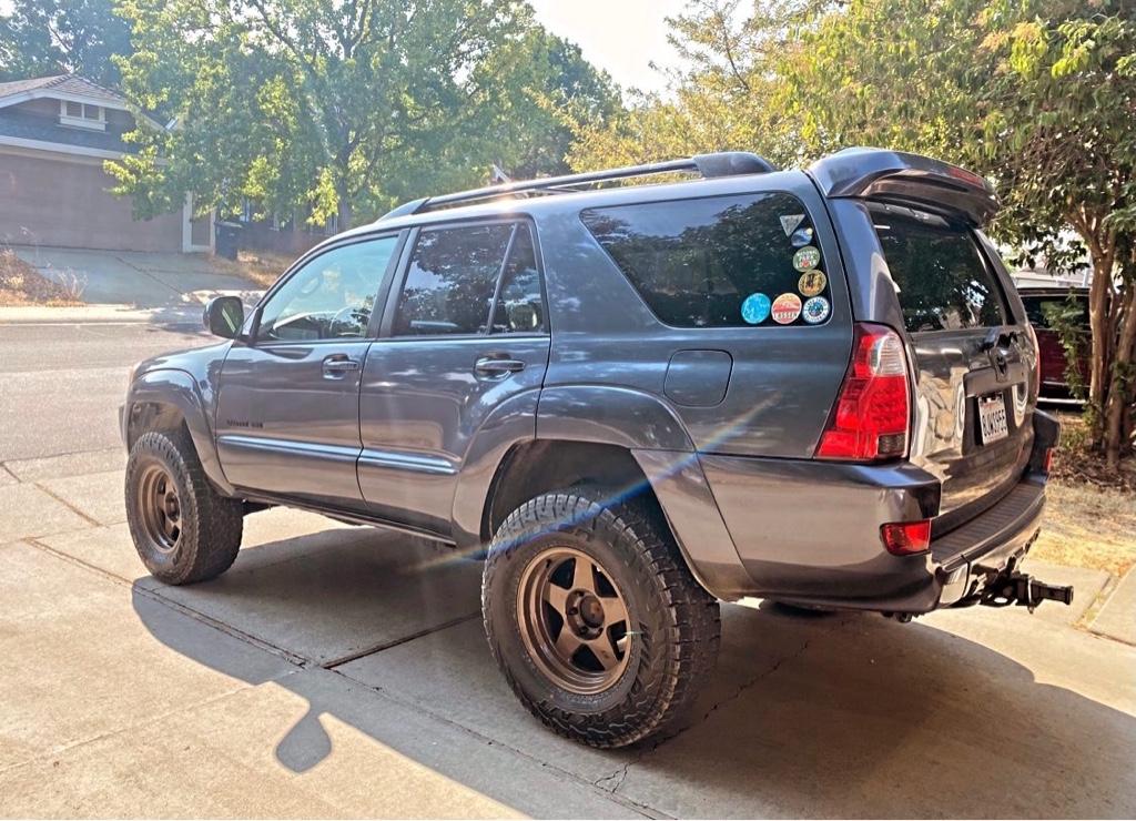

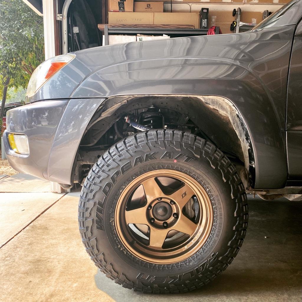

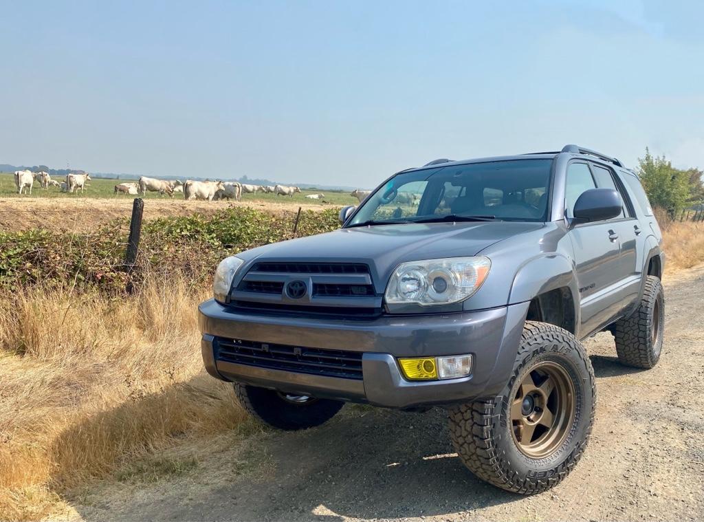

Will take better pictures soon but too excited to not share now.

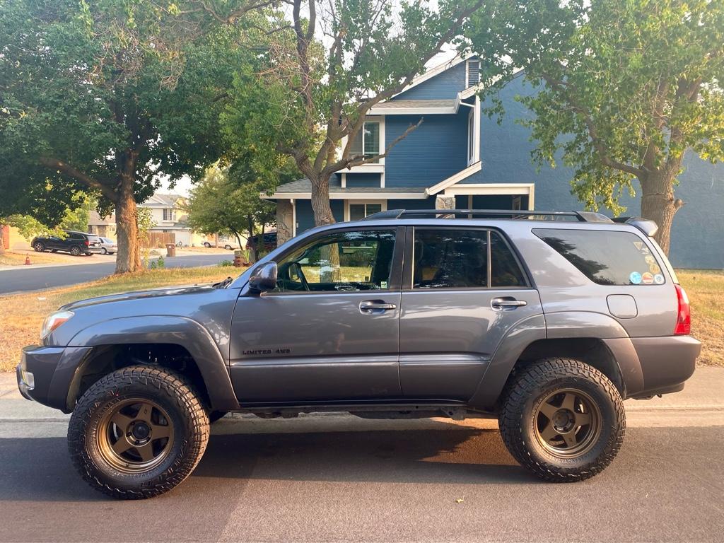

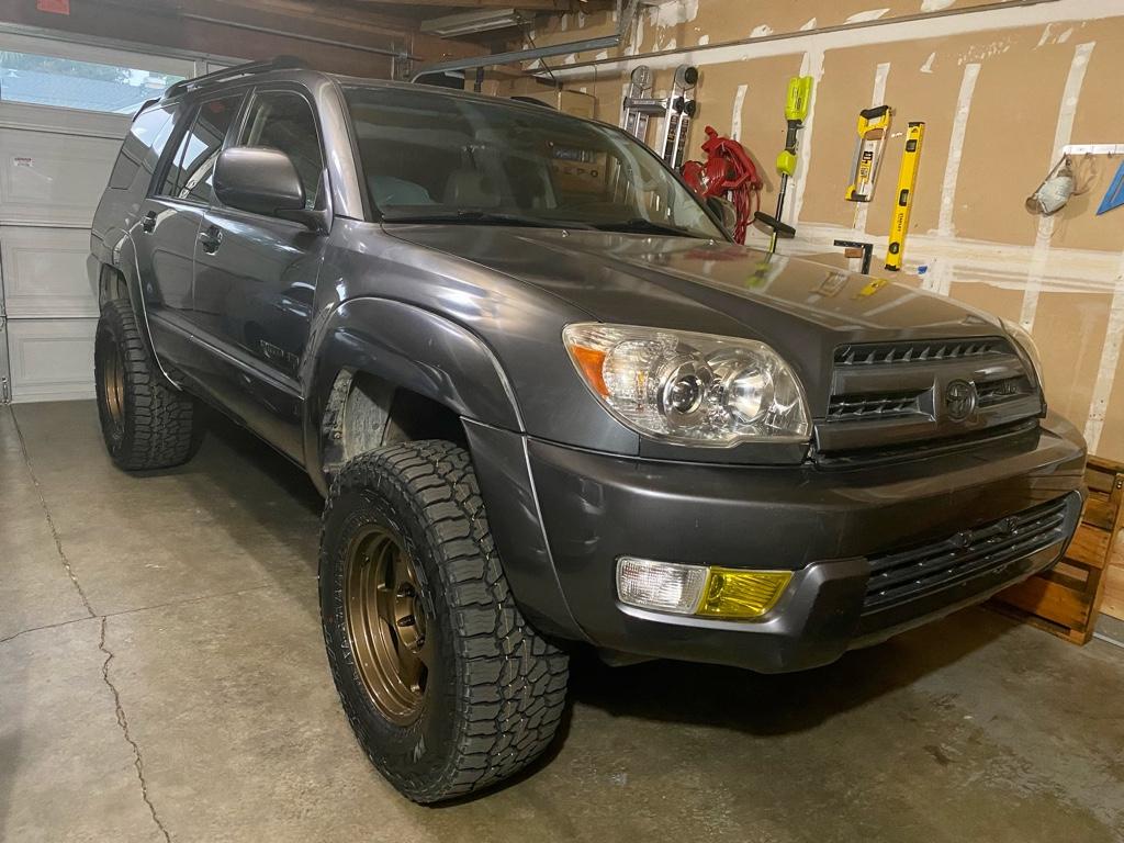

I pushed the fender liners way forward. I had to trim the front by where the mud flap was because it was rubbing. Not much, just a little corner on the inside. Now it rubs the body mount at full lock. It’ll be fine on road but not when flexing. BMC is already scheduled.
Also removed front mud flaps and trimmed the rears. I want the rear to cover the hole that’s left when removing the mud flaps.
Bilstein 6112 with 650lb coils
Total Chaos UCAs
Bilstein 5160 with Icon 2” coil
SCS GEN 5 | 17x8.5 -10 offset
Falken Wildpeak AT3W 285/70/17

Looks great! Makes my stock wheels look like pizza cutters lol.

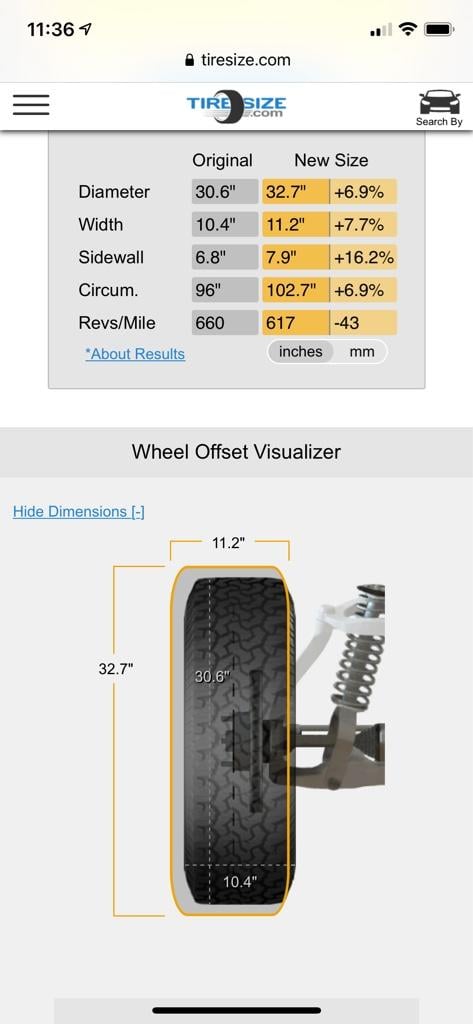

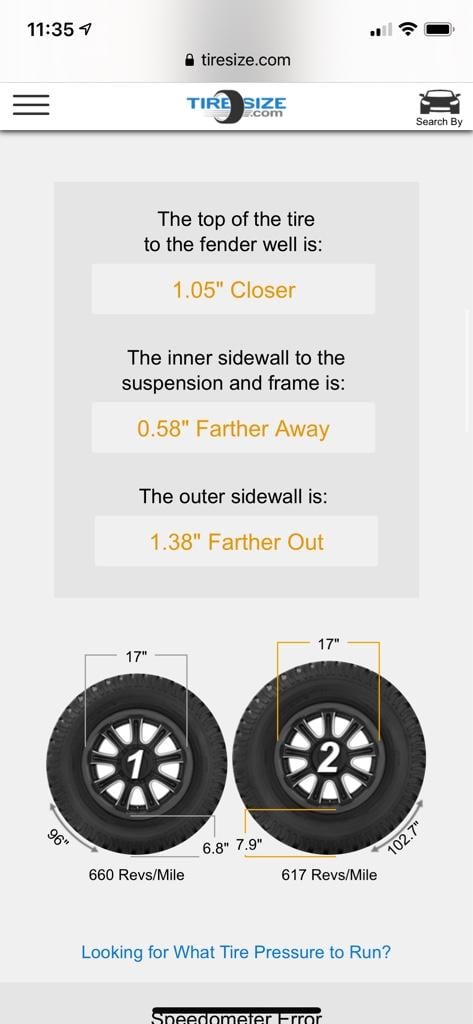

With the sizing and offset I take it your not running any spacers?
How close are they to the UCAs?
Rig looks great!
Rig looks great!
-10 offset and nowhere near the UCAs. According to the calculator this offset puts me 0.58” further away than my +15 offset Trail Wheels.

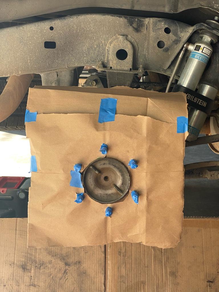

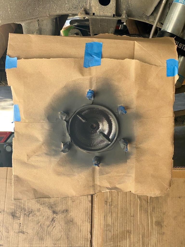

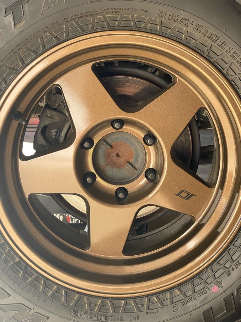

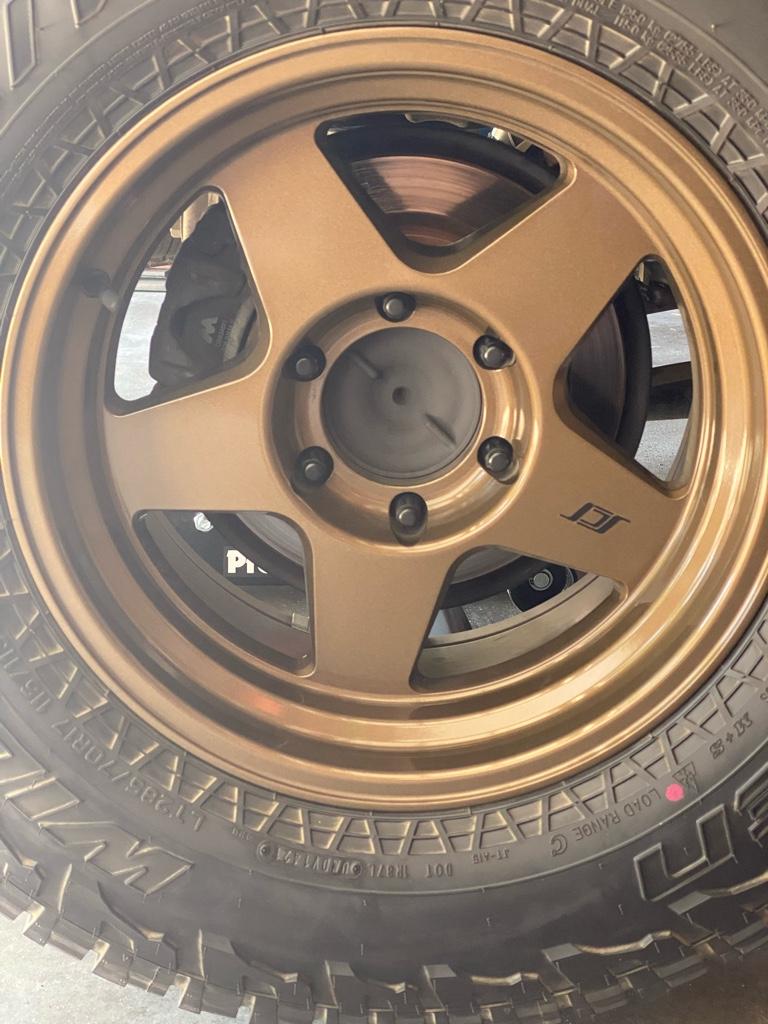

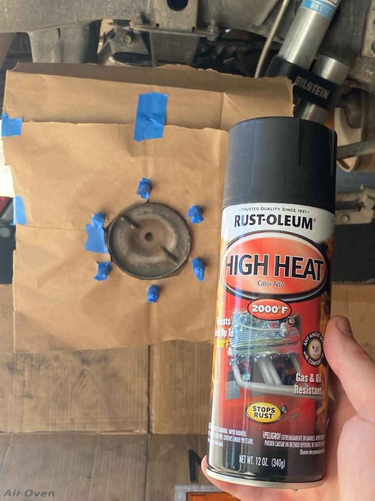

My Stealh Custom Series GEN5 wheels don’t have center caps. It’s one of the ways they keep the weight low I guess (under 23bs per wheel). I’m fine with that but had to address the rust on my wheel hubs on the rear.
It came out more matte than I wanted, but it’s definitely an improvement. I may try to find something with more gloss but it’s not a priority.

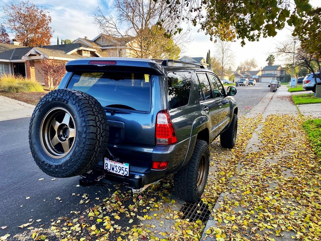

New Rear Springs
Switched out rear Icon 2” 52700 for OME 895 2” rear spring. Rear was beginning to sag with added weight of tire carrier and spare tire. Gained 7/8” restoring 3/8” of normal rake. With the Icons I had 1/2” of reverse rake.
