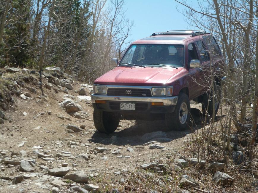

Alright, well I have been on here for a while now and have just now started to do some somewhat major mods to my 1994 4runner SR5 V6. I got it last year for 600 bucks from a guy that had taken it to my dad's shop to get fixed. There was something wrong with the transmission that would have cost him a pretty hefty amount of money to get fixed with labor and all so he decided it wasnt worth the hassle and he decided to part ways with it. Once we picked it up we tore apart the transmission and found it to be about a $50 part that was causing the problems! SCORE! So, we got her put back together and she has been running flawlessly ever since. When I first got her I also replaced the sagging springs and shocks in the rear with some new stock height ones to get her back to normal.
I don't have many pics of it when I first got it but this is the closest I can get:

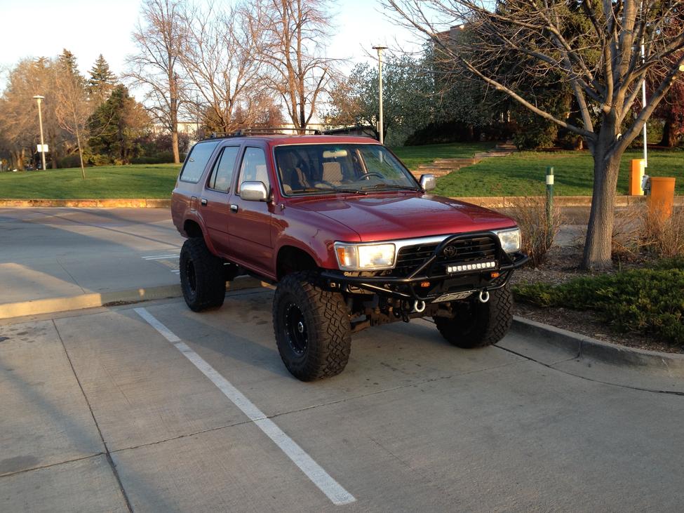

And here is how she currently sits:
