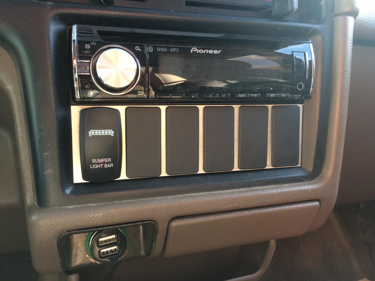

Well, I've kinda been slacking on building and been out playing instead for the past few months (when I get the chance to), but I finally have an update even though it really isn't much!
The switch that came with my light bar finally took a crap and stopped working, so I decided to upgrade and bought a rocker switch from OTRATTW. After getting that, I found another part that I guy on TW was making for first gen tacomas. It was a switch panel that replaces the storage compartment underneath the stereo deck. It fit awesome and was only 20 bucks! I highly recommend looking into getting one if you are looking for an easy way to organize switches.
Here is a link to the original thread on TW:
6 switch plate (under radio location) - Tacoma World Forums
And his actual website to purchase one:
Toyota Tacoma | Shop | Paranoid Fabrications

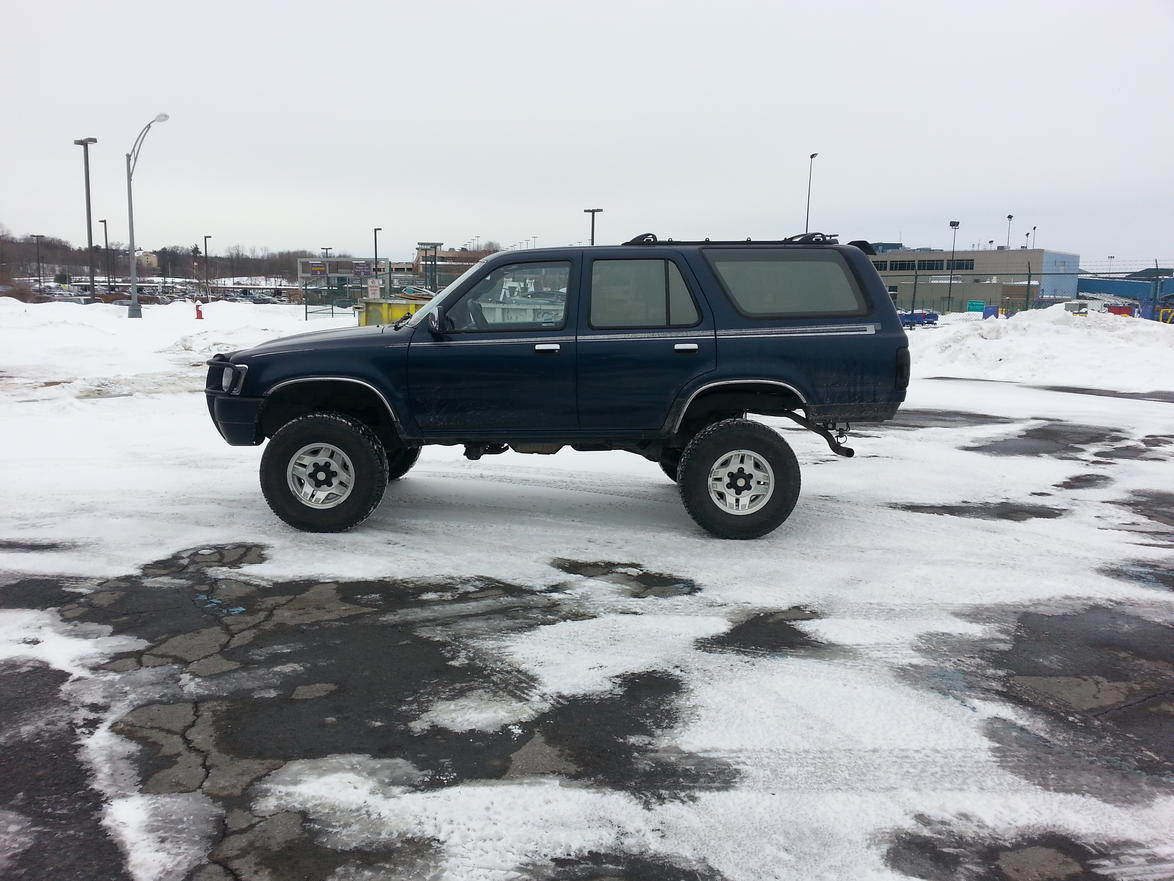

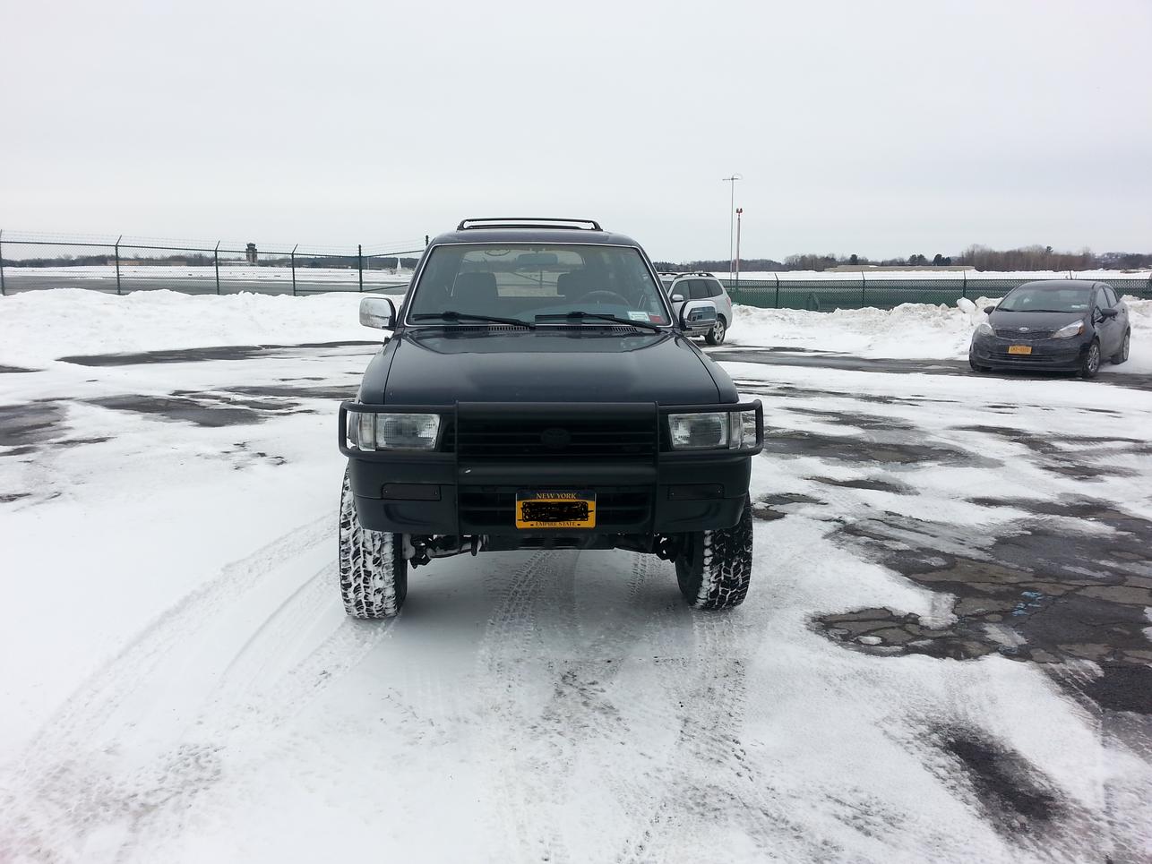

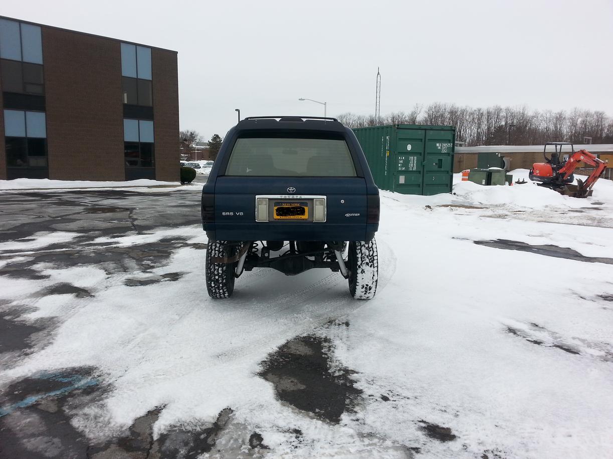

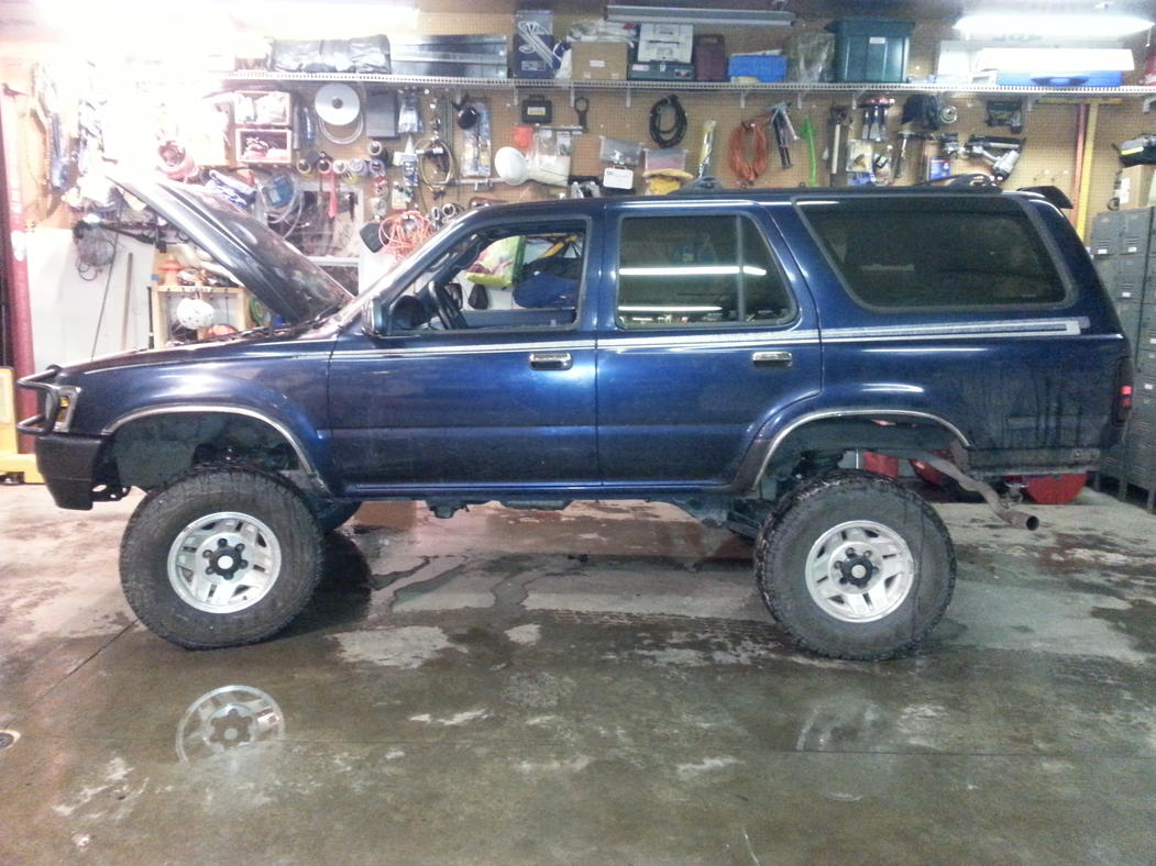

Do you happen to have the part number for the muffler and the high flow cat? I'm doing lift this weekend! I will post before and after's on here so you can check it out.
lifted!
Ok I got the coils, BJ spacers, and shocks in! still need the panhard drop bracket, the passenger side rear wheel sticks out about 1.5-2 inches. The exhaust looks weird with no rear bumper but Im going to get a magnaflow soon. Also blacked out the front end with bed liner to hold me over until I get a new front bumper.
