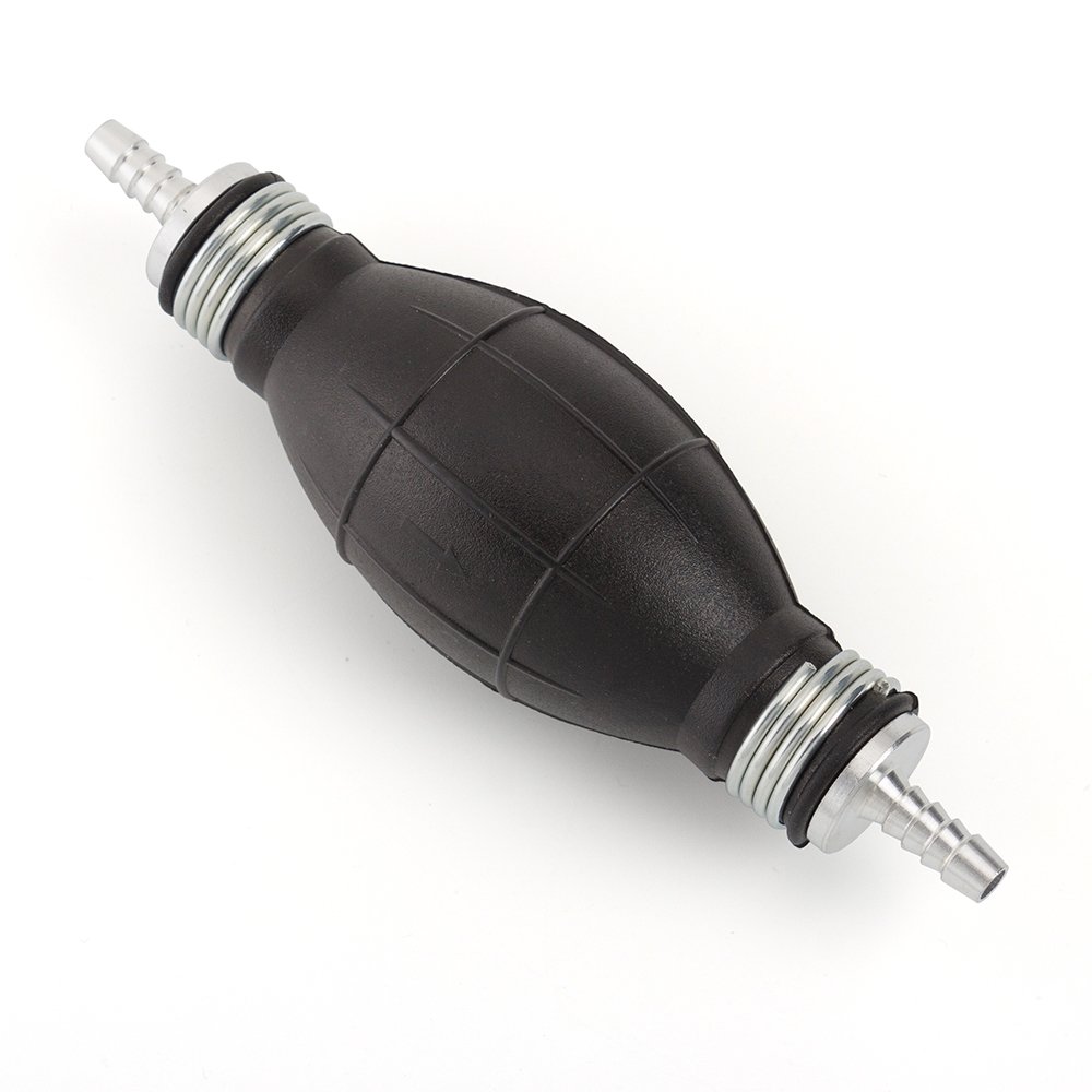

To actual use, there can be multiple ways, for now at least, all will entail that gas going into the main tank the way it always has - through the factory fill hole.
I'm curious if a syphon will work, direct, tank-to-tank. I hope so! This arrives today.
https://smile.amazon.com/gp/product/B07BDKMG3F/ref=ppx_yo_dt_b_asin_title_o02_s00?ie=UTF8&psc=1
10mm is basically 3/8". This comes tomorrow.
3/8" Fast Flow Fuel Line
– Fuel-Line.com
Looking forward to trying this combo. My guess, if it works, I'll need to back the rear end on an incline to raise storage tank even higher than the main. That will likely have to wait until I return from the biz trip... Fun stuff.
