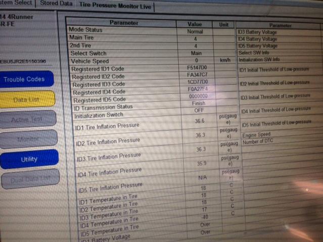

I scanned the car with the tis techstream it read only one code c2144. If all sensor were there, it should have the ID for each tpms on their correct.

I scanned the car with the tis techstream it read only one code c2144. If all sensor were there, it should have the ID for each tpms on there, correct?
Correct. I just installed my summer wheels with new monitors. Initially, the tire tool scanned all the codes, and the codes were programed in to the truck, but when hooked to the TIS, the codes for the removed winter wheels were still showing. (I also had the light come on right after the swap). As soon as the fresh codes for the summer wheels were input into TIS, light went out.

Had a shop scan it again and one is reading 78 psi. The rest are fine at 35psi. Would that be consider a bad tpms?
So you basically selected Registered ID1 Code and hit the erase button in the tech scream then add the code for the winter tire then his the record button? Is the order of the ID matter?
