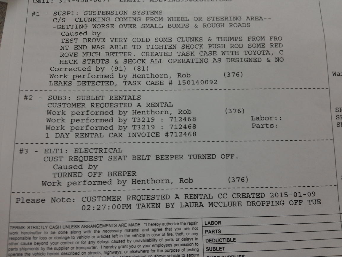

Techs acknowledged hearing the clunk but found no obvious cause. Retorqued everything underneath but still no improvement. They had no loaners available so i had to take my 4runner back. I plan on dropping it off again and leaving it until they fix it (when they have a loaner).
This helped, got rid of about 2/3rds of the sound. Shock push rod...really?

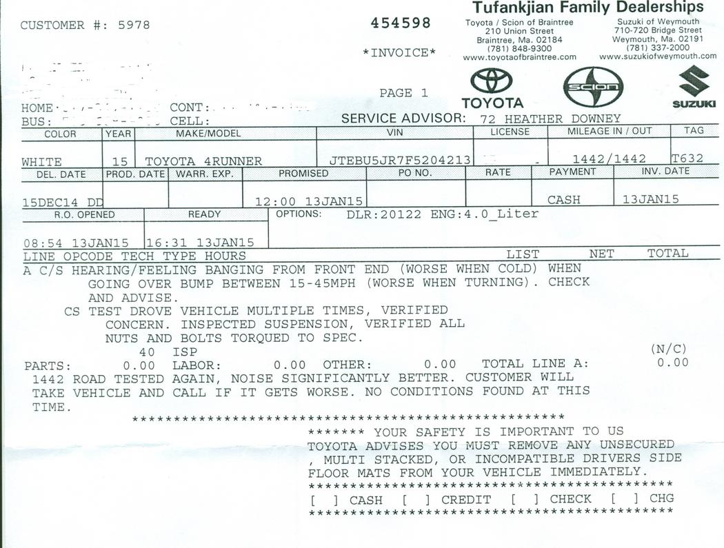

Trouble is that the techs CAN duplicate the sound. They just can't locate the cause!
Thanks for the update. I haven't had much time to mess with mine. Took it to the dealer 2 weeks back and the tech couldn't recreate the sound.
Drove it today for the first time in a while and definitely worse when cold.
However, before seeing your update I've concluded that it is suspension related as I can recreate it either on the left side or right side driving over the right type of road "irregularities"
Looks like its time to head back to the dealer.
I'll advise as to what my outcome is.
Thanks again!

I would put my money on something along these lines...
The first place I'd stick a GoPro would be the lower shock pushrod connection bolt/mount on the LCA.
