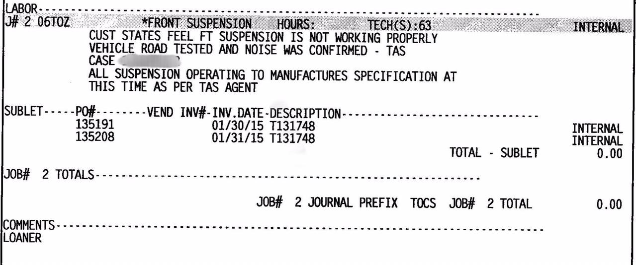

Still in for Service (Day 5) they also contacted Toyota for a resolution with opening a task case.
Toyota response is that this is a "Normal" condition.
I have expressed that I am not satisfied with this lack of a resolution and the Service manager has been very helpful and is siding with me on this and believes that there will be a resolution in the future as more TRDPs hit the road. I am going to pick up the truck now as the Prius they gave me is not doing well with the snow and Ice and I will post my service notes so that folks can print it out and include when they take theirs in for service. It helped me by bringing in some of your notes.
Here is the service report after picking it back up. The clunk is still there.

Note: The service manager did say that they didn't see any signs of anything making contact to something else.
