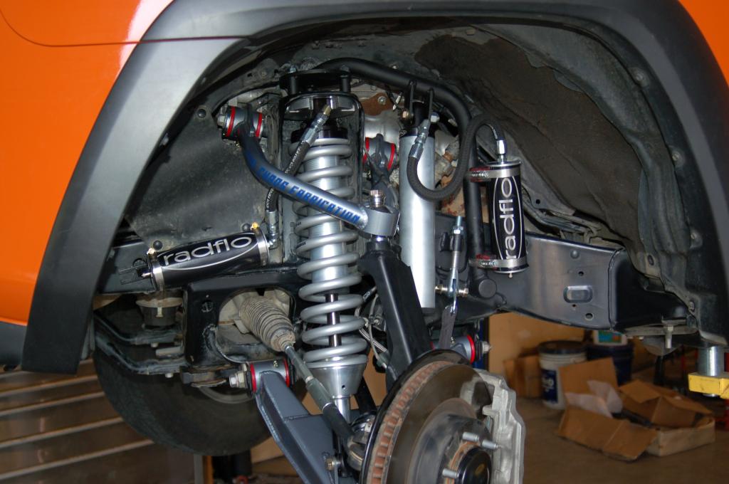

I had a loud clunk from my Radflo/Total Chaos/Johnny Joint suspension. Mostly during start/stops and turns. It was the big nut securing the Johnny joint that worked loose. Now... no clunking:attention::attention:

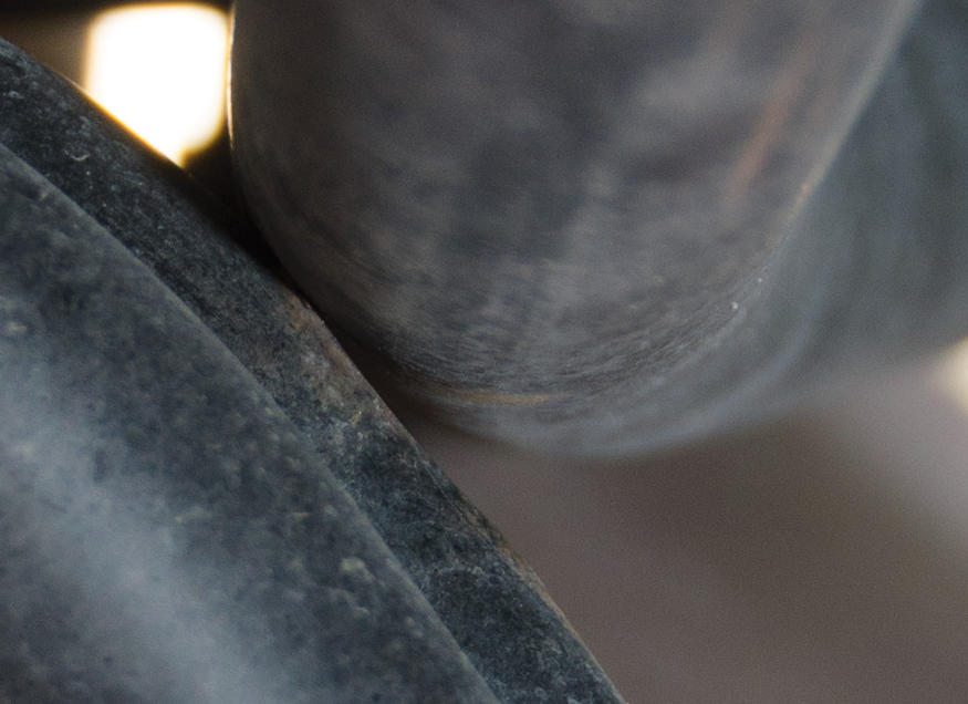

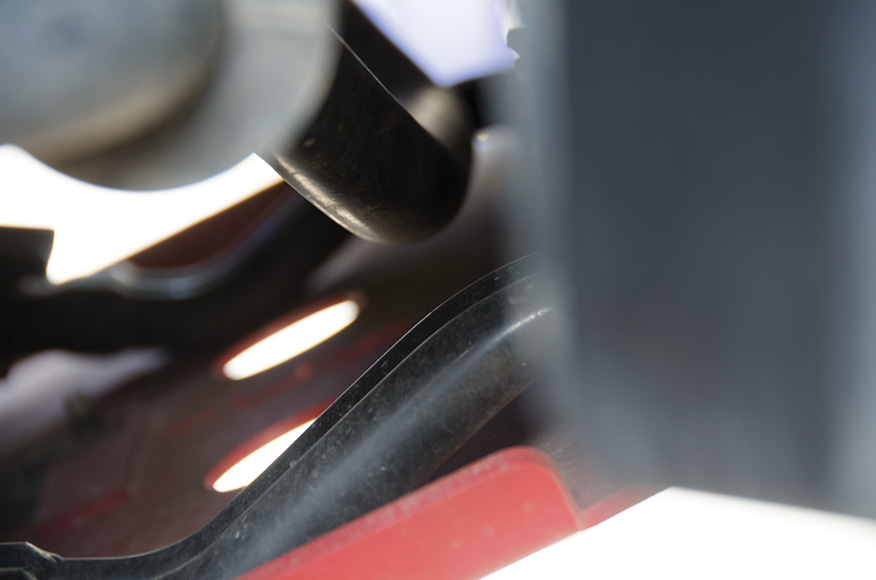

I believe I may have found the cause of the clunk on my rig. It may be somewhat specific to Icon installs on 14+ though, may not apply to the pro. And it would explain why I think I remember it happened when I got the lift installed as well.

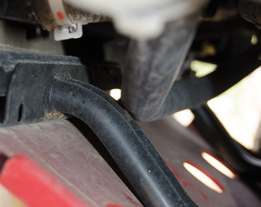

I had my driver side wheel off to weld up a crack on the inner fender well and took a good look at everything under there. When I hit the sway bar with my hand I could hear a slight metal on metal clack. Looking at the sway bar as it passes under the body, between the sway bar mounts, I see this:
The Sway bar is hitting a forward mount to the radiator cross bar. Here is a close-up:
You can see it's scraping and even flattening the support bar some. Weirdly this is only on the driver side, here is what the passenger side looks like:
So the bend in the sway bar is asymmetrical with the bend WAY over on the driver side...
Now the cause of this in my case is the icon sway bar relocation bracket. It moves the bar down about 1/2 inch and forward about 3/4 inch. Basically pressing it right up against the forward crossbar mount on the driver side.
Good news is it's fixable in this case. Bad news is not easily :/ I'll have to fab up some custom brackets that don't move it forward so much. Or possibly some longer links might move the bend up high enough to not hit.
A project for another day I fear... but at least I feel comfortable that I found an extremely likely explanation for the clunking in my case.
As far as the TRD Pro goes, did they actually install a sway bar bracket relocate? That is really only needed if a 2.5+ inch lift is installed or larger coils as at full droop the bar will hit the coils in the stock location.

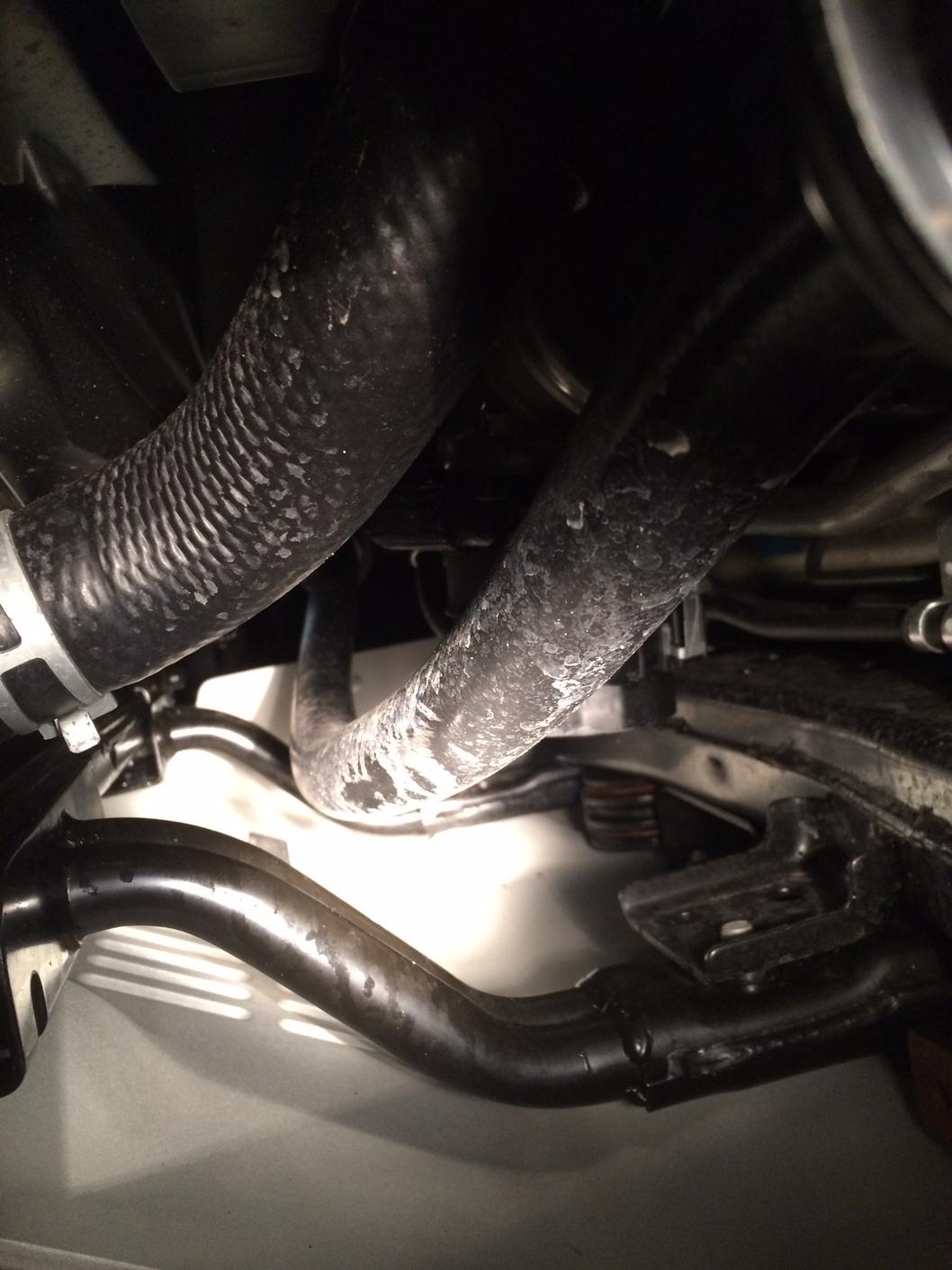

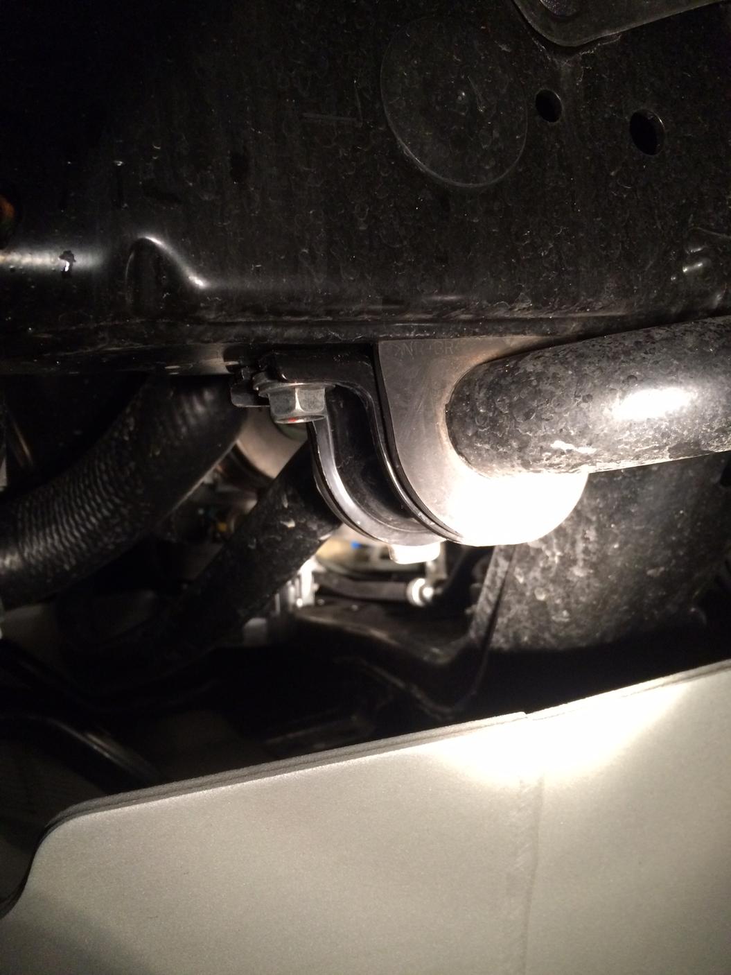

Someone needs to look and see if there is a spacer between the bushing mount and the frame or not. If not, then I doubt the sway bar is contacting the mount as shown in those pics and it may be something else...

but it looks like it doesn't specifically apply in the TRDP as delivered from dealer. There appears to be considerable clearance from the sway bar hitting the posts supporting the bottom of the radiator support crossbeam. Also there is not a sway bar relocate, on mine at least. These photos are from the driver side but having compared with the passenger side it was the same.
Still a work in progress here but all thoughts and ideas will help with the ultimate discovery!
I just sold that very suspension off of my FJ used a different shock though, man made one heck of a difference.
