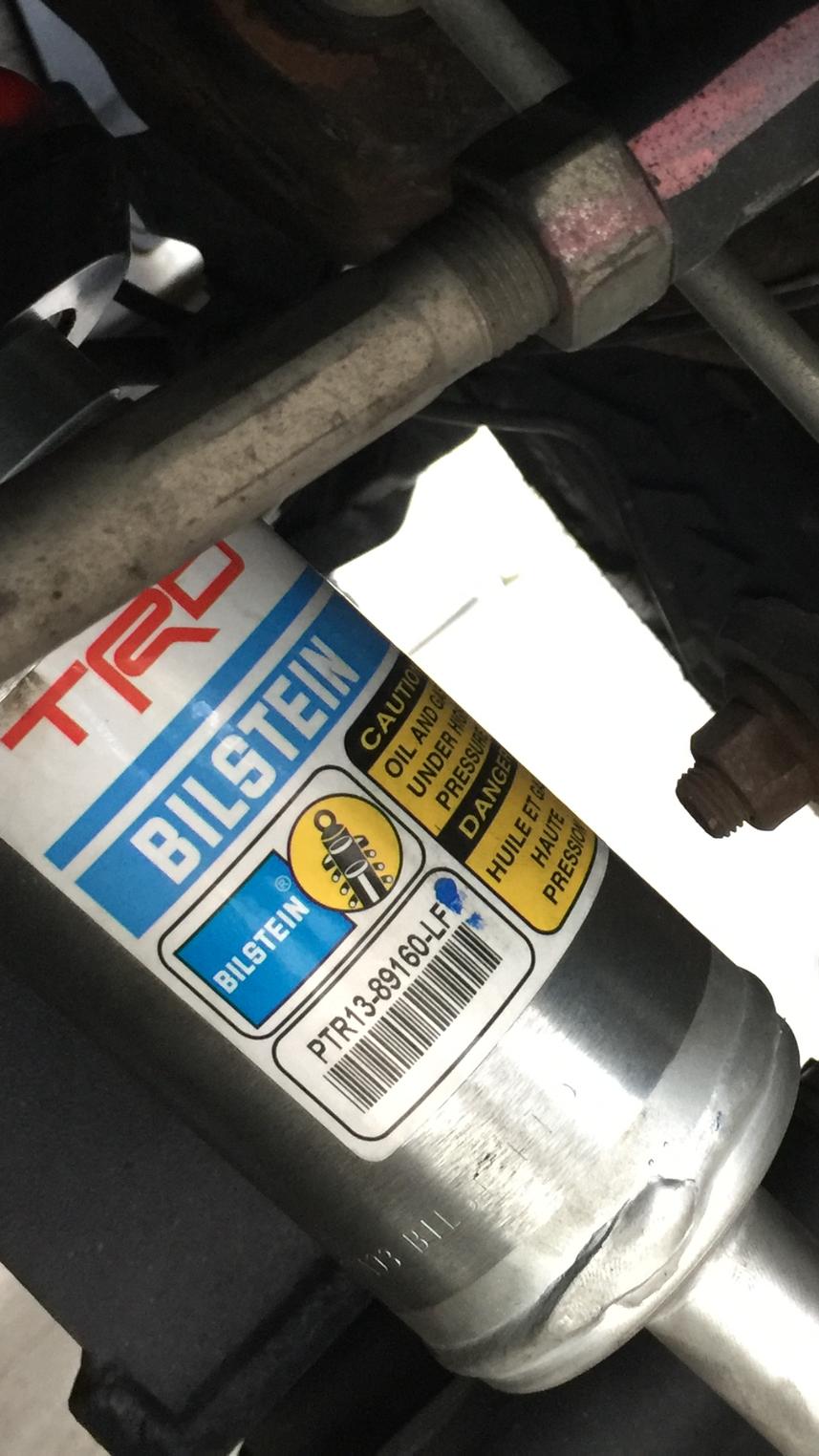

Figured I would update this with my own experience.
Bought a 15 TRD Pro around this same time last year. Did not say a word about the issue to my dealer until this fix was actually available. I emailed my sales guy the pic 4RunnerPro posted (thanks!) as well as just forwarded him this whole thread.
Did not have a single issue, they ordered the new Bilsteins, came in, scheduled repair, done in 4 hours, picked up and all set.
I just looked underneath and it almost looks like they used the same springs? Not sure if that is normal but I will check it out more in-depth tonight.
Only drove it a few miles so far, seems the same. Can't hear the clunk now, its too hot.
Hopefully this helps someone.
Springs
The springs will be your old ones. Only the shock itself will be replaced. You have a good dealer like I do. Wish everyone did...
