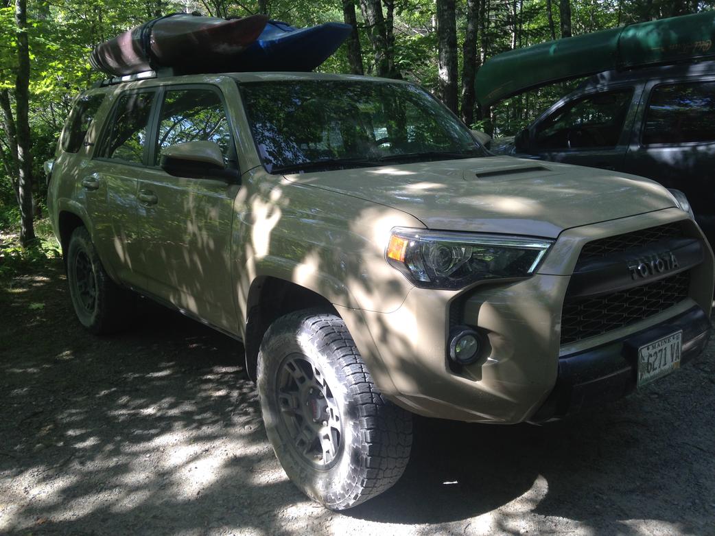

TRD Pro Clunk
Gone!!! Finally!!!
Yup. Toyota nailed the problem. Just put 200 miles on dirt roads in northern Maine. No more clunk after the updated shocks.
I also just wanted to say that this truck is a god damn Cadillac on the dirt.
In love all over again.
