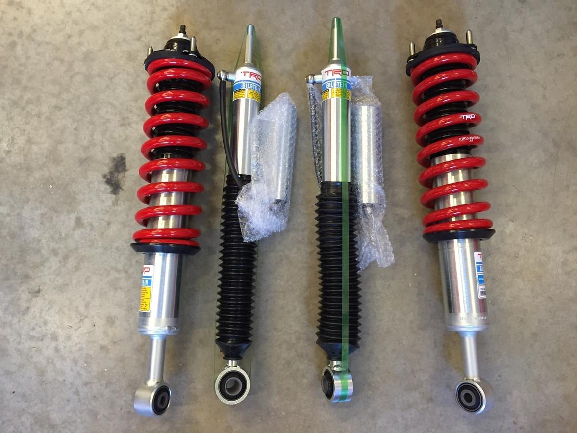

For reference, here is a pic of the shocks/springs that are used. I have tried moving things around with the truck on the ground and it all feels tight.
It has to be something within the shock/spring assembly itself. That is the only difference between a Pro front end and the other models. I guess it is possible that the slight lift has caused some new geometry issue, but it seems unlikely.

Silly question but could it be that when the coil unloads and loads back on to the bottom ring plate the thunk is the noise as the force sounds through the shock body that the ring-plate is mounted on?
