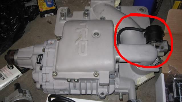

RE the bypass valve:
I don't think you're looking at the right part. The bypass valve is not electronic, so it cannot be "wired" to stay open or closed. It is a vacuum actuated part that responds to intake manifold pressure/vacuum.
Also, on the bypass valve... full shut = full boost, full open = zero boost.
Bypass valve:
Bypass valve:
lol yes i know what the bypass valve is. i didnt mean "wired electronicly" i ment wired the pushrod on the actuator so it was either fully opeb or fully closed.

Here's the thing.... There is the potential that the sealing surface on that bypass valve either has wear, or machining irregularities, that prevent it from completely sealing. This will create a boost leak and will bleed off your boost pressure.
Your "wiring" test does not exclude that as a possible cause of your issue.
