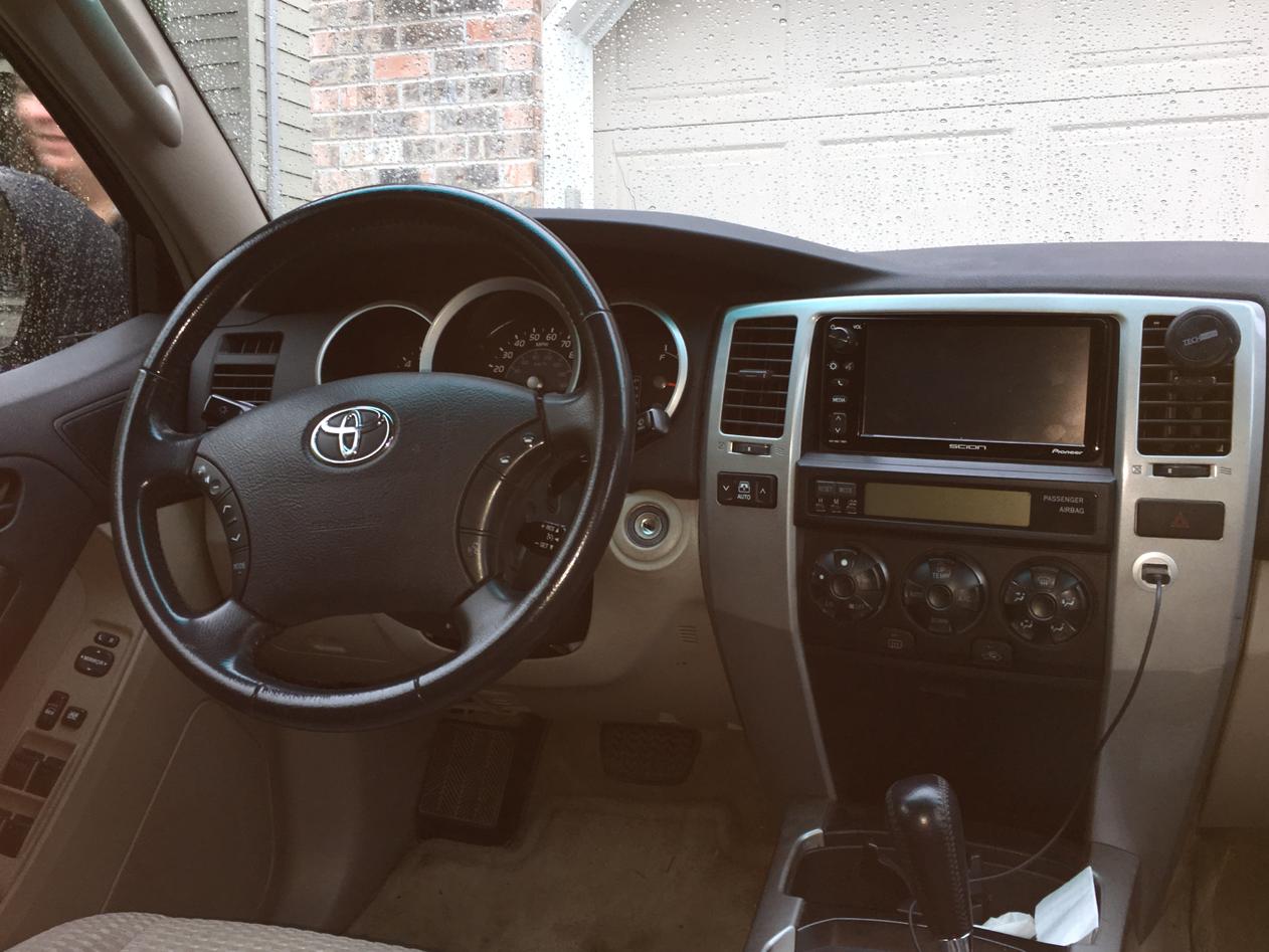

It is just visible in the pic attached to post 176 in the bottom righthand corner, it has a white USB cord plugged into it. If you would like a better pic let me know and I will take one this weekend.

Here is a pic of the USB connector, also note I added the phone switches to the steering wheel. Another cool plug and play :-)

Wow, Simon, I basically want your setup exactly in my '08 Sport, including the heated seats! lol. I'm pretty sure I don't have JBL; will check again. My in-dash 6-cd changer is totally unnecessary, but I have been going through my old collection since I don't have an AUX input, but that needs to change soon!
Your install with the back-up camera is perfect. Where are you located? I would love to order every part you did and come over with a case of beers (or cash) and work on the car under your watchful eye/guidance.
Nevertheless, your write-ups probably saved me some $$$ if I get a professional install so I can be more specific abt parts and target time estimates.
[MENTION=145714]Simonw[/MENTION] Could you tell me the part number and the source you obtained the steering wheel phone controls from?
The phone controls were on the leather wheel when I bought it on eBay along with the audio controls. My car (2006 SR5) had the basic wheel with no buttons, adding the wheel with the controls is plug and play. No idea what the p/n's are. Simon
Gotcha! Thanks for the reply
