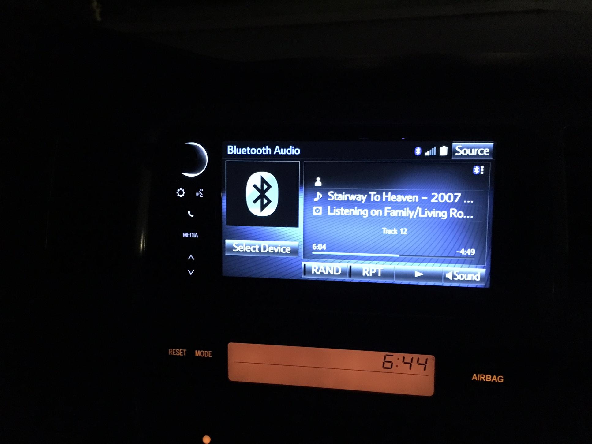

The colour of the back lighting on the PT546-00160 is a light white-ish colour, not orange like the rest of the dash lights. I think it looks nice as it is very subtle, glad it is not orange to be honest.
If you modify your grey USB cable to add on a regular USB end, the wires are soldered as follows:
USB: solder the red to red, black to black, puple to white, green to brown
Use a good quality USB cable as a donor that has the metal shielding inside, so you don't get noise on your USB input from the car.
Si
This is what the back lighting looks like, fresh :-)
[MENTION=145714]Simonw[/MENTION] - you're awesome! That image makes me excited to receive my T10071!
