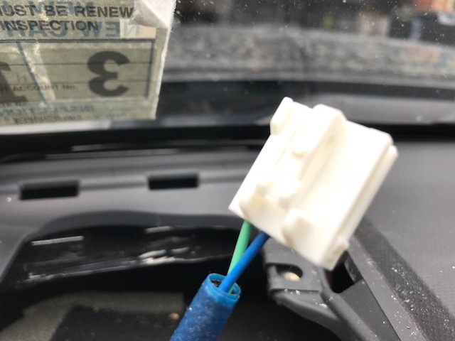

I am looking to replace my dash speakers to improve the sound quality. I removed the factory dash speakers and I see only two wires on the plug.
Most of the folks here mention there are four wires.
Can you please suggest how should I be wiring up my 3.5" speakers for the dash?

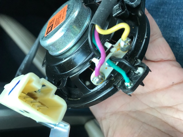

Even though the speaker connector is a 4-pin, I suppose they're only using two of the pins although I'd really like to see a photo where the wires go into the speaker side connector to be sure (they could've jumpered the pins in the connector or something). When you look at the harness attached to the speaker, is there a lump under the shrink tubing that looks like there could be a capacitor there? Seems to me that they wired the tweeter and woofer separately in parallel so that they could limit the frequencies to the tweeter with a capacitor.
If you put a multimeter on the 2 pins of the speaker connector that are being used (on the speaker itself) , what do you get for resistance? Now do the same test across the 2 pins that aren't being used. I would imagine you'll see a resistance of somewhere around 3.x ohms (if it's a 4 ohm speaker) for the first test, and no reading on the second test (no continuity).
If this is the case, your wiring job will be much easier that those of us with the standard speakers!

Just gonna answer my own question here in case anybody is wondering. As far as I can tell, there are only 2 options to buy these harnesses new: Taco Tunes which would be about $30 shipped, or Seicane which is quite a bit cheaper but you've just got to wait on shipping. Here are the ones I ordered: https://www.ebay.com/itm/112673474469
Even though I already installed my new speakers using the adapter off the stock speakers (which also required me to de-solder the stock 5800 Hz high pass filter), I still didn't like bulkiness of it, so that's why I was looking for harnesses. I also used 400 Hz filters, but I think I'm going get the capacitors and bump that up to about 800-1000 Hz.

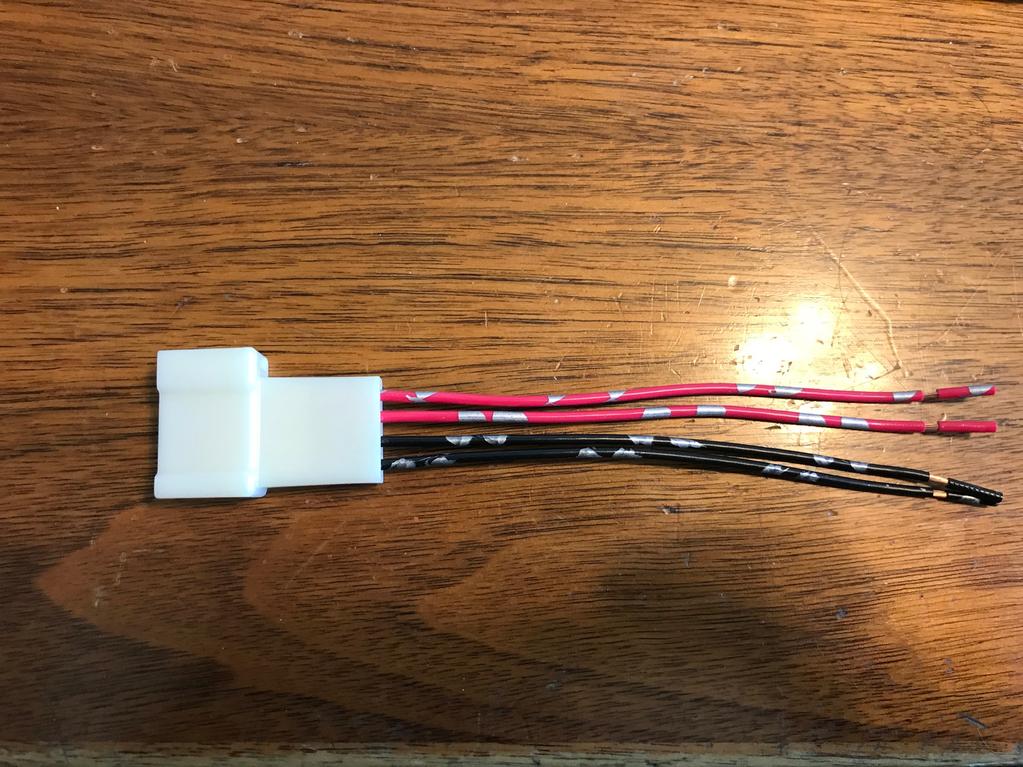

Finally got my front harnesses in from Seicane on Ebay, and it looks like they'll work just fine. Total cost for both was $12 shipped, so quite a bit less than Tacotunes. Only drawback is waiting a week or two for shipping.

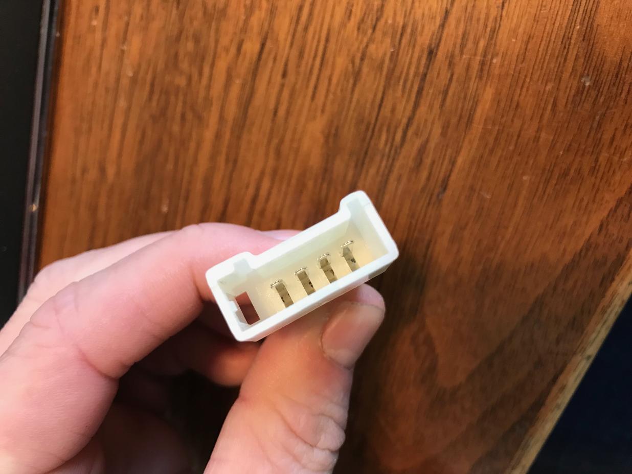

I found another option for wiring, without hacking the original wiring or speaker, or waiting on a harness.. and it was extremely inexpensive.
I was shopping around trying to find the flat pins used in the harness and instead found that a spade terminal fit in there perfectly. The ones that I used had the prongs spaced to where one spade will plug into two spots. So I attached one to the positive and one to the negative side of a speaker cable. Then inserted one of the spades into the factory harness for pins 1 & 2, and the other spade went into the harness for pins 3 & 4. So basically each spade terminal is making the bridge connection to the door speaker, and the wire coming out of that spade terminal goes to the new dash speaker.
Some brands may be shaped slightly different than others. The ones I used were Gardner Bender brand (home Depot), 16-14 gauge, 4-6 stud.
