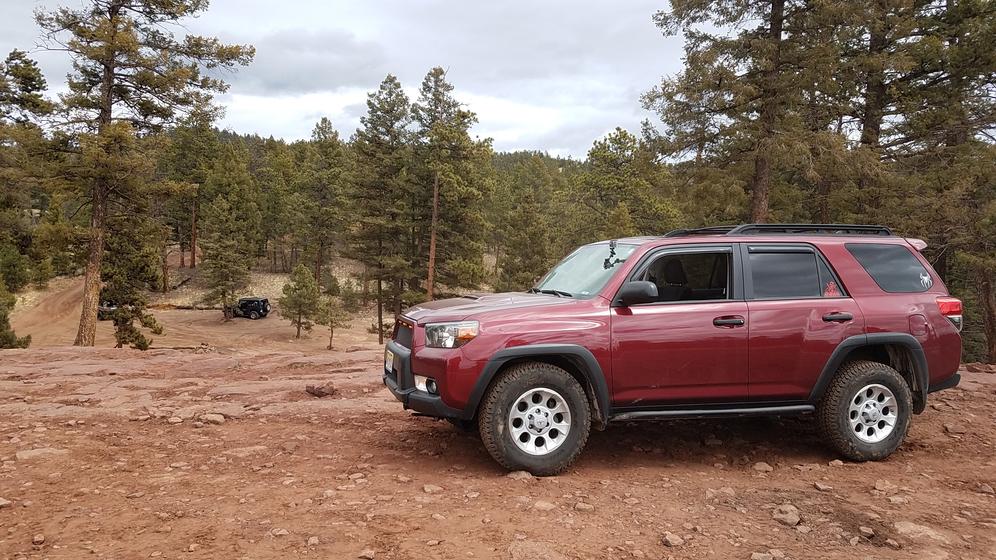

Same Kit. PTR13-35140. I just followed the instructions with the no spring compressor install.
I used KYB SM5640 - Mount Kit for the front. For the rear shocks I used the cushion and washer from the original shock.
It gave me about 1" lift at front. I still need to get an alignment, but It rides really nice. Firm but not harsh. No more nose dive and lean on turn. I do have E-rated tires set on 40psi.

Your saying that you got about 1" in the front, which means it should be relatively level on toyota quality parts. Has it settled any since you installed?
