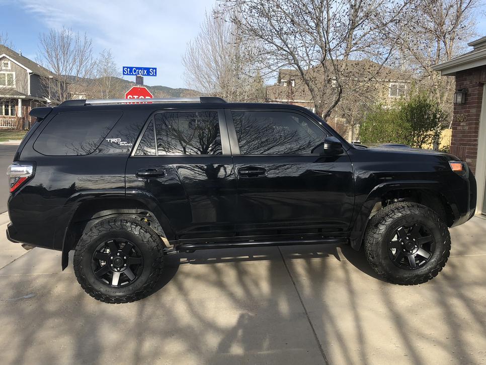

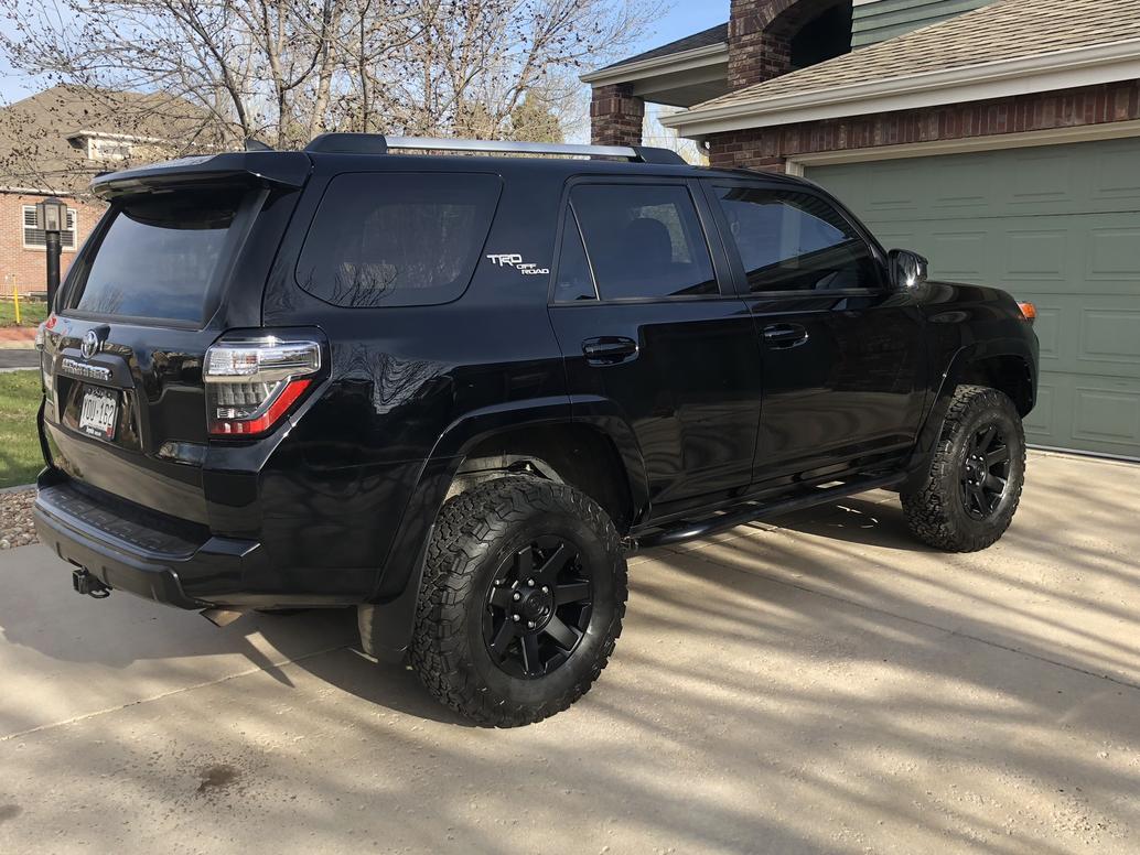

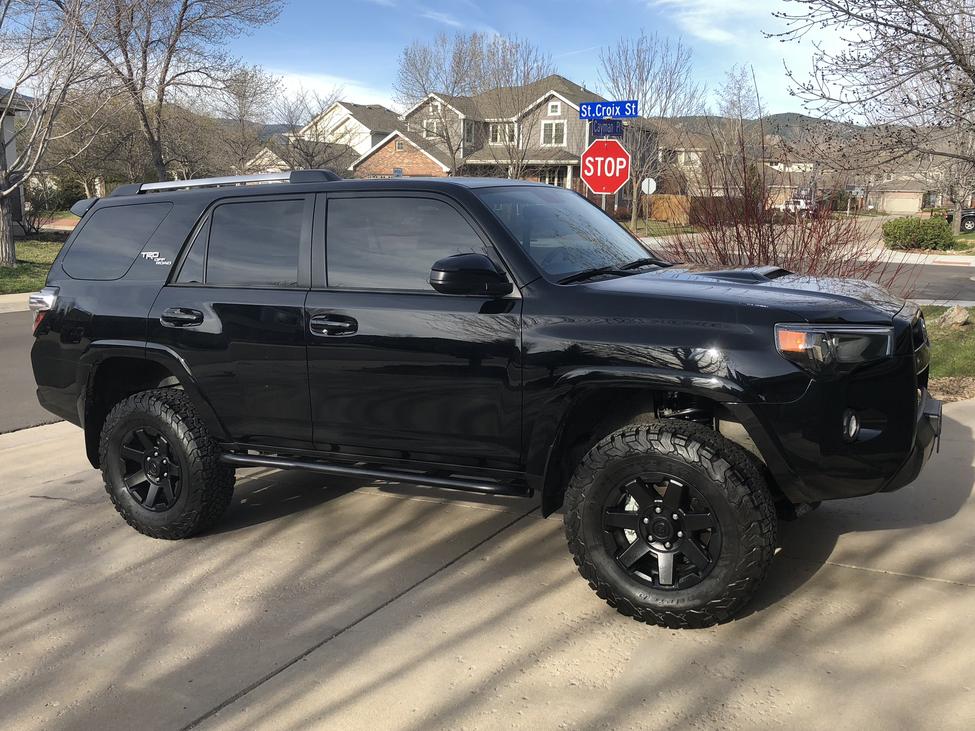

With the help of my friend, installed OME 3” Suspension Kit and SPC Upper Control Arms. Ride is definitely a little stiff with mostly stock weight but that will change over time as I add more armor and bumpers. It looks incredible with 3” of lift on all four corners.
Also painted and installed my angled RSG sliders, got a fresh alignment at RSG, and painted my stock wheels satin black. Major aesthetic upgrade in my opinion for $20 worth of Duplicolor spray paint. I sanded them with 320 grit and cleaned them with their prep spray and did about 3-4 coats of black primer and 3-4 coats of paint.
Considering a set of Spidertrax spacers for my 275/70/17 KO2s, as well as an ARB compressor and some recovery gear...then I’ll likely move on to installing a full length roof rack and rooftop tent, but that may be a while as I’m not keen on losing my garage parking!

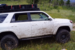

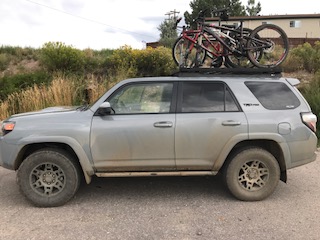

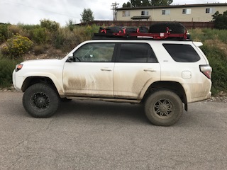

I’m 99% set on this rack. Just don’t know if I should go 3/4 or full length. You have pics of both? And pros and cons to either? What made you guys decide to go 3/4 on one and full on the other? If you could do it again would you do 3/4 or full on both? Thanks!
Here are some shots of both from our trip to CO. I got the 3/4 because I was a little tentative about drilling the roof on the TRD. After the drilling process went well on the SR5, I would be less hesitant now to drill the TRD, but I had already put on the 3/4. Both have their advantages - space on the full length is awesome, ease of install on the 3/4 was great. Doing it again I like the flexibility of having both so I might have made the same decision. If I had to only pick one I would go full length for the utility.
Siiiiiiick. Definitely add the wheel spacers for Trail wheels.

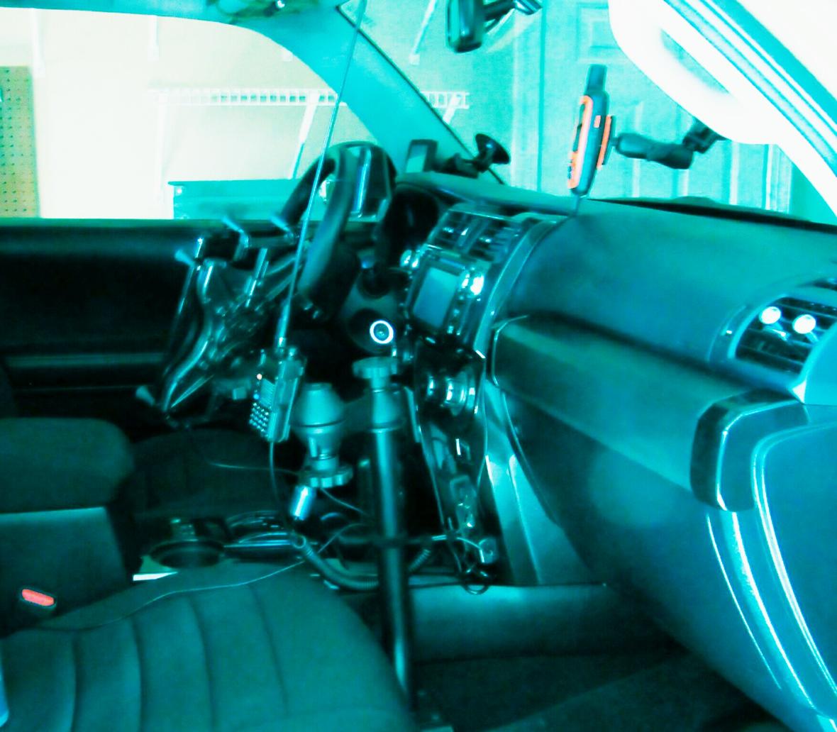

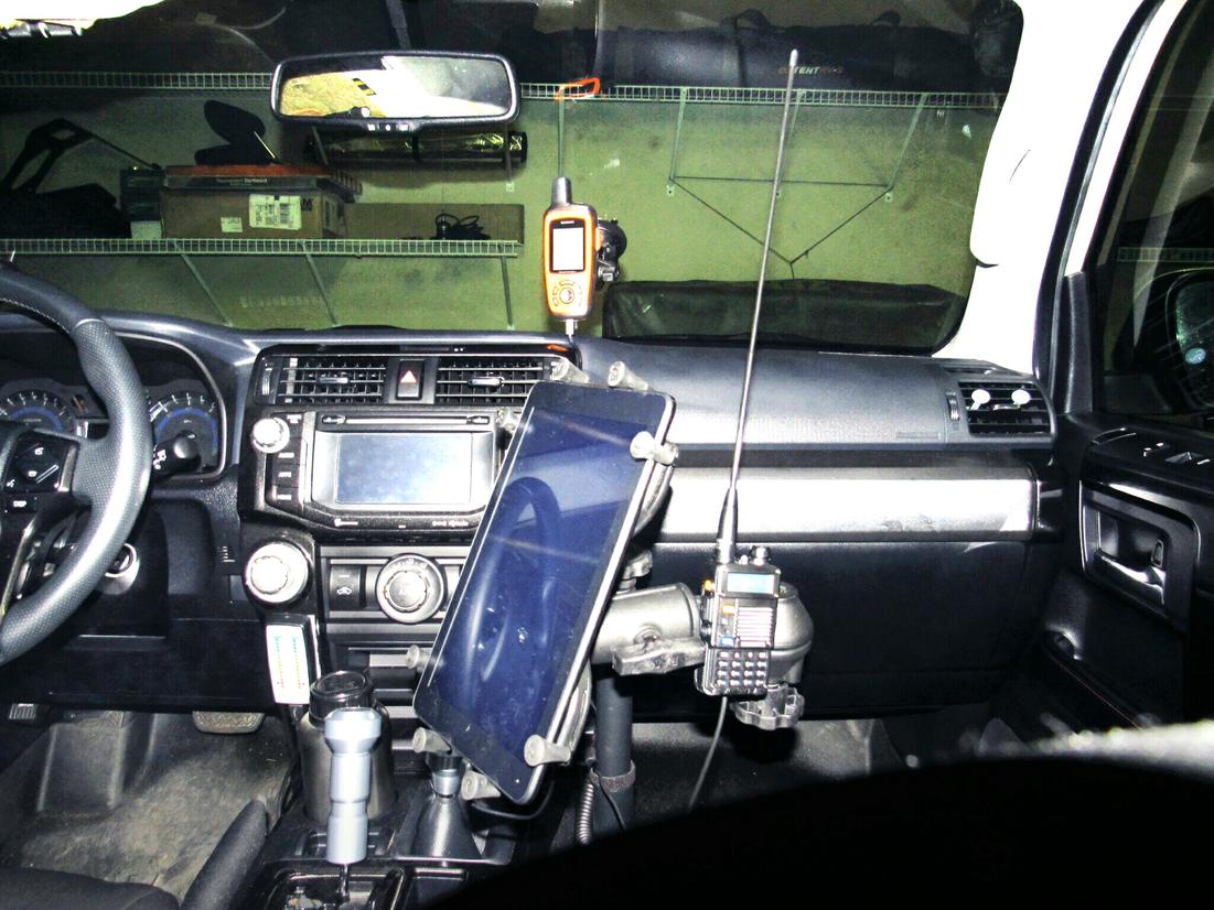

Inreach expoler + tested for a week or so... really impressed with the Earthmate app and capes...ran a lot of nav setups and this one circles the herd...
Running that ham with the antenna inside the cab is doing you no good. The cab essentially acts like a faraday cage and absorbs most of the incoming/outgoing radiation. Mag mount an external antenna or use it as a good excuse to buy a mobile radio.
Does the seat screw mount attach firmly? I wanted a very solid mount and will be kind of overbuilding the armature to ensure stability while on trail. Ill post up some pics and part numbers when they arrive.
It’s pretty solid. I torqued it down pretty well. Took a few tries to get it right. With my iPad mini I get a little play on big bumps. I’ll post a pic tomorrow.
Damn Isaac!...lolll... don't don't go off all premature on us...the party's just getting started...we all know what a handheld is best suited for...stay tuned...skeet skeet skeet...
Thanks for all the feedback! The full length looks a lot better and I love having the ability to carry much more up there... just wish there was a no drill option. Decisions decisions...
