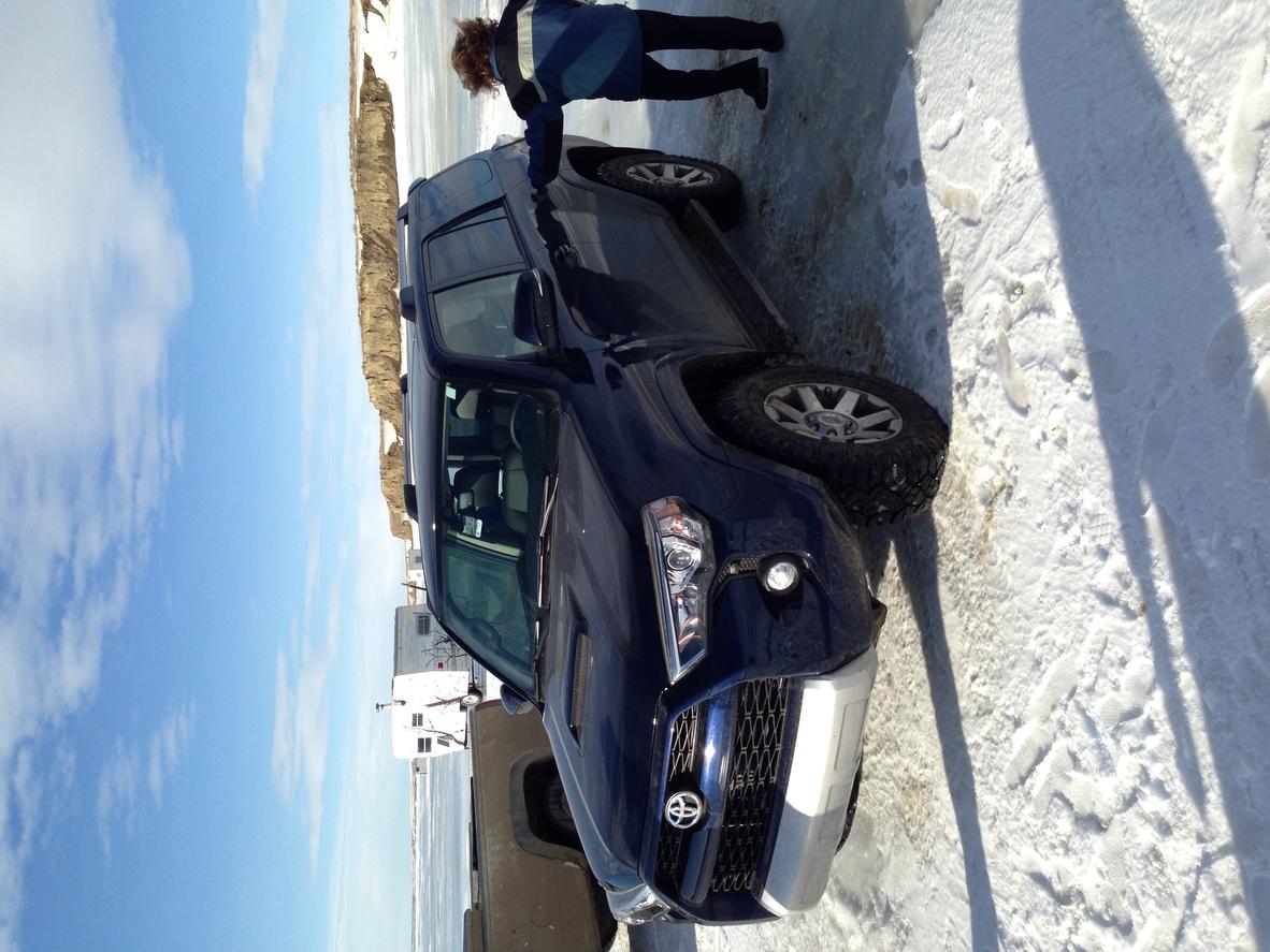

Crossed the south Saskatchewan river today near my in-laws farm. Felt good to use the truck as it was intended to be. Both going down and coming back up the banks were a lot of fun for an off-road newb like me.

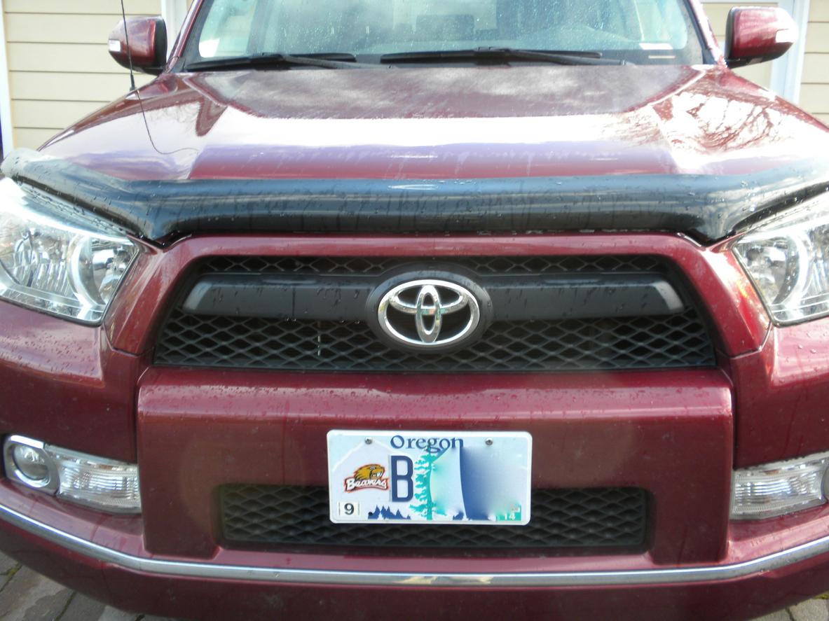

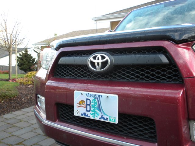

Replaced Chrome Grill Bezel
Thanks to [MENTION=54404]jbstrd[/MENTION] for giving me a black replacement bezel. Finally got it installed. Anyone want a chrome one?
