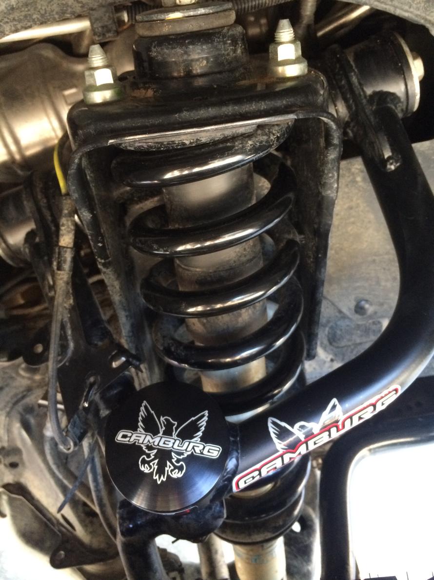

1st I installed these UCA caps on my Camburg BJ arms, should have done this from the start but I was too cheap after spending thousands on lift and wheels :frusty: They look way better than an open ball joint, but boy were they a PIA to install. I spent a good 20mins pounding them in with a mallet.

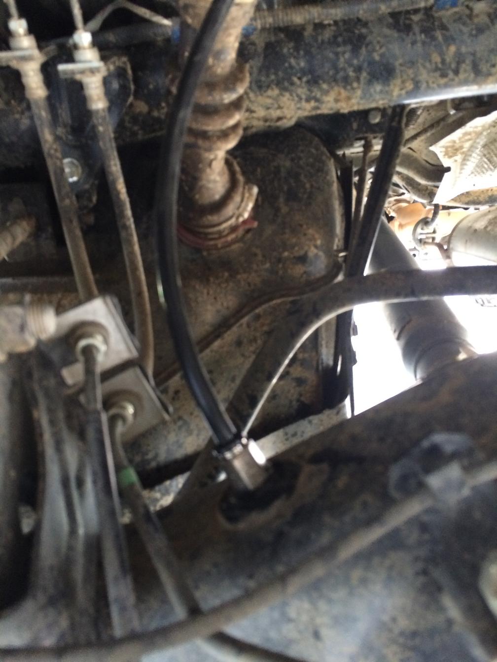

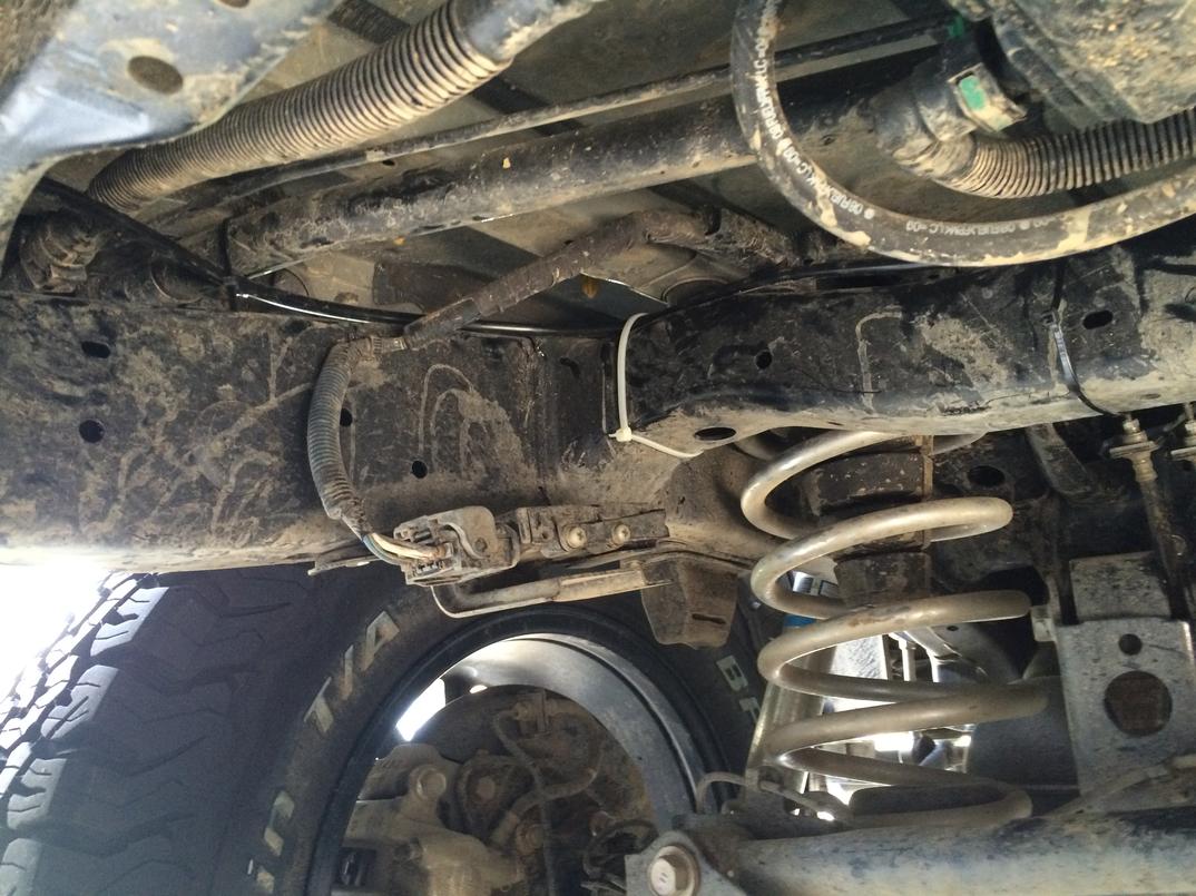

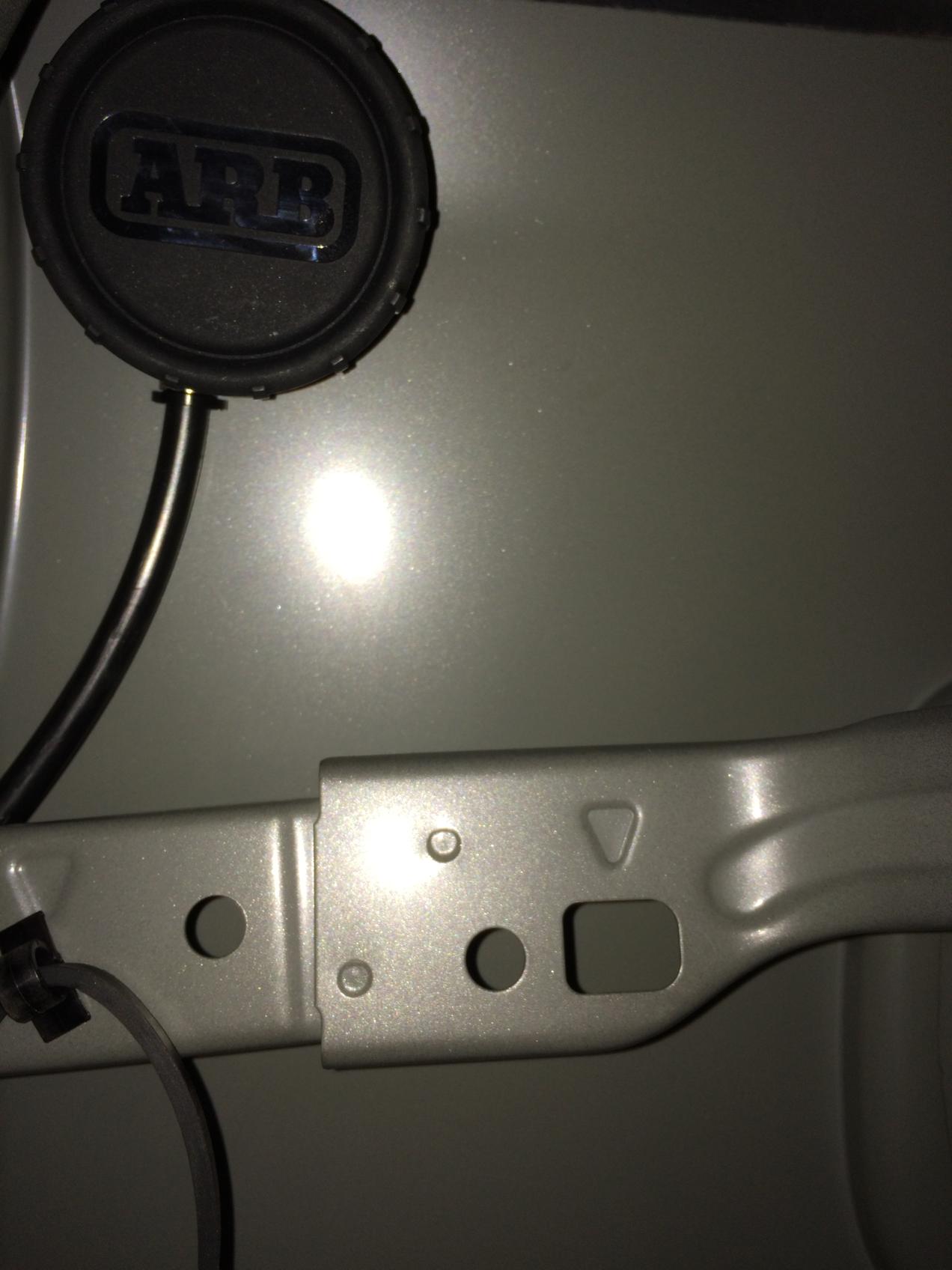

Then my ARB diff breather kit arrived on Sunday so I didn't waste any time getting it installed. Thanks to [MENTION=1913]hoeftm2002[/MENTION] for his thread!:cheers:
Install was very simple, except that I dropped the rubber gasket inside the body panel and spent almost an hour trying to fish it out :bash:, but I finally did!

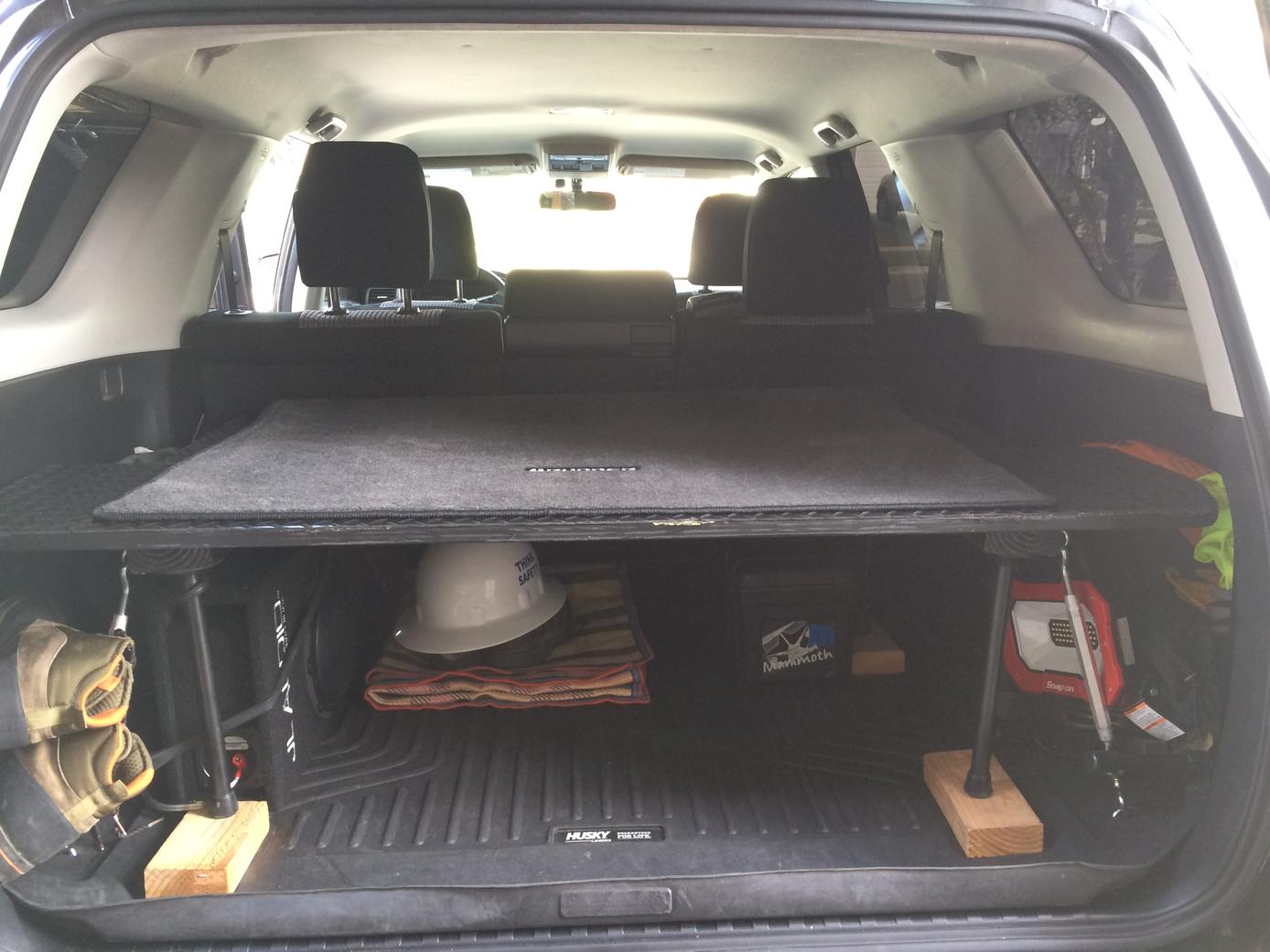

Then I got my cargo area all cleaned out and organized and called it a day.

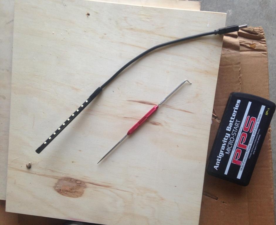

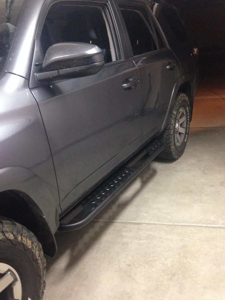

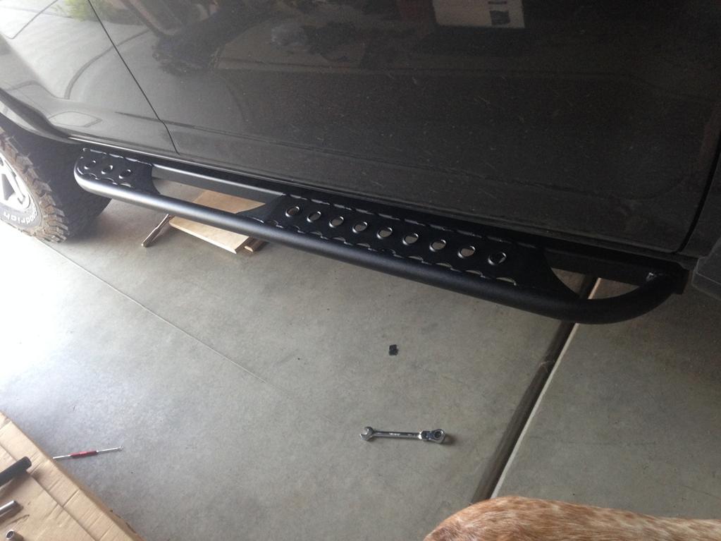

Finally able to install the Shrockwork slider after it been sitting in the room since Dec. I tried to install the passenger side a few weeks ago but gave up after an hour of trying to play around with the stick nut. (don't attempt it after a long day out on the water fishing and expect to have any patience to deal with the stick nut tired, haha)
then [MENTION=53960]itsdchz[/MENTION] gave me some pointers and it has helped out a ton!!
First tip was to extend the stick nut using another stick nut. This helped so you don't accidentally drop it in the frame and then spend another hour trying to fish it out of a tiny hole. haha.
2nd tip was to buy longer bolts. Went to home depot and picked up 3/8 1.5 inch bolt instead of the 1 inch they give you.
Those two tip helped out a great deal but still a bit frustrating with the top and bottom stick nut on the driver rear side!!
Anyways another helpful tool was a tiny skinny flashlight that I stuck in one of the holes so I can see what the heck I was doing. Instead of going into it blind, I had some light in there to line it up.
Anyways finish the driver side last night since I had to waste some gas before doing it. Both are now on and looks awesome. I'm ready to tackle the Lower Link Skids from RCI next. I just need to paint it or powercoat it first since its bare metal.
Thanks again itsdchz!!

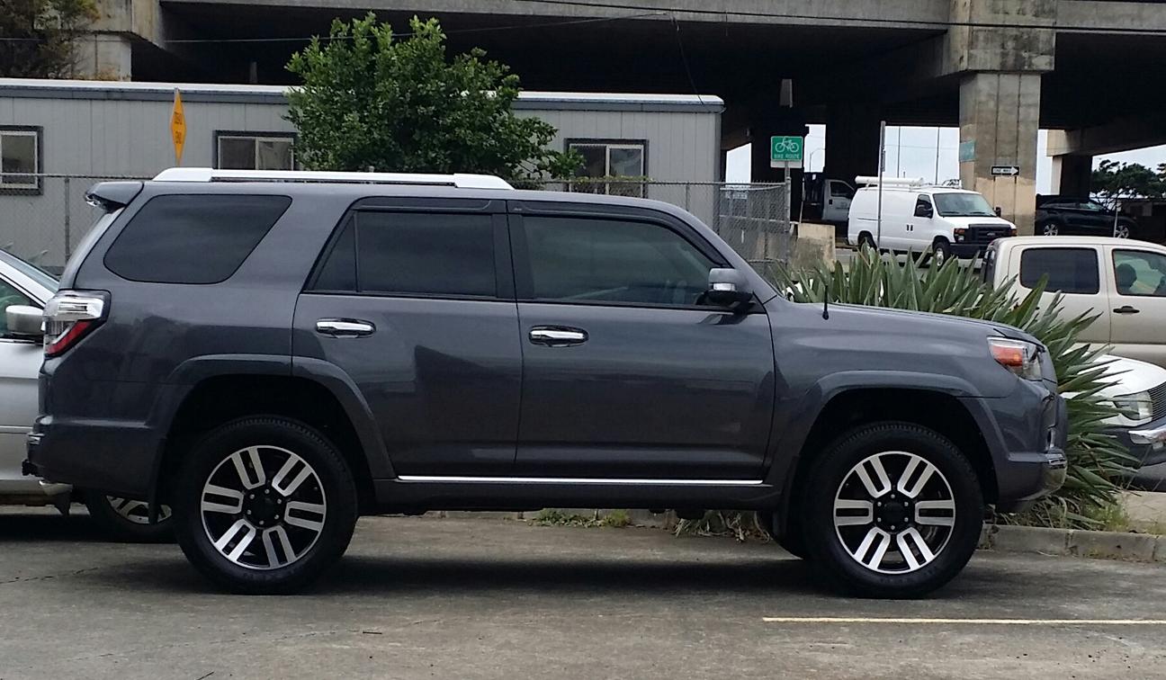

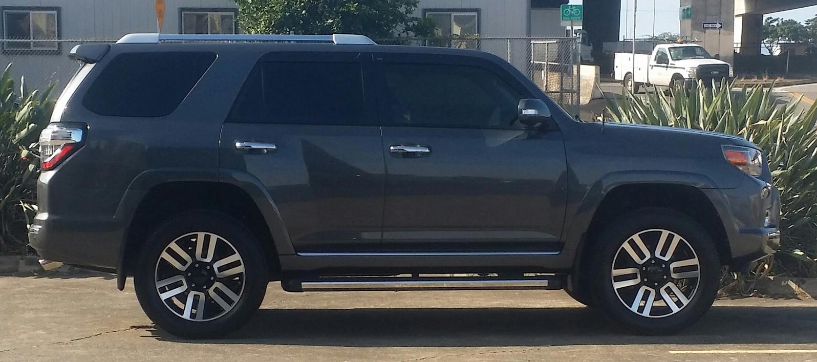

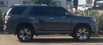

Removed OEM running boards. Before and after:

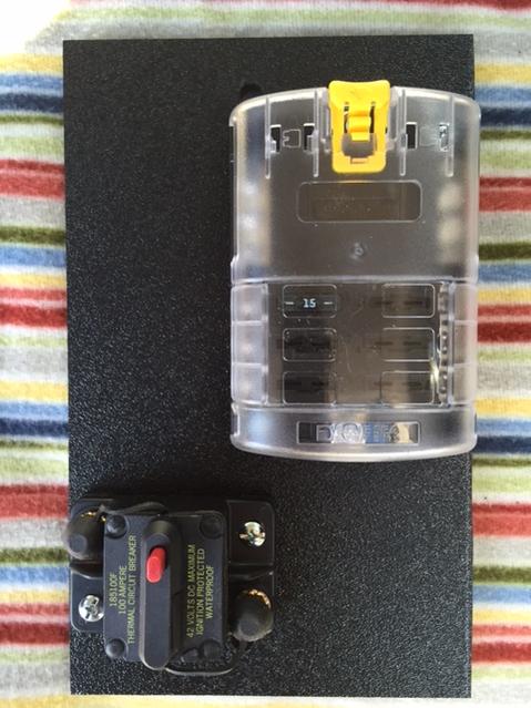

Made up a fuse box and 100A breaker to install over the factory battery stud mounts. Will mount this up and wire to the OEM battery for now and run 8ga back to a 12V outlet in the cargo area for my fridge. Plan to do a dual battery installation and will flip this to the 2nd battery once that is done.

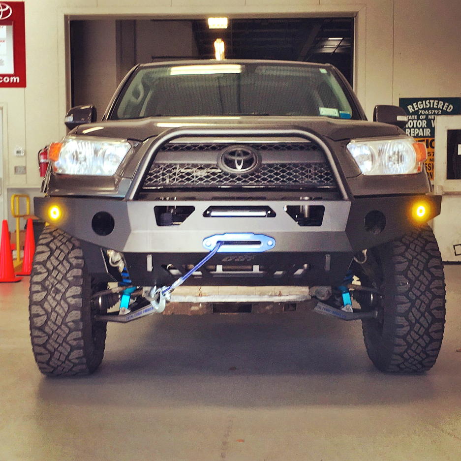

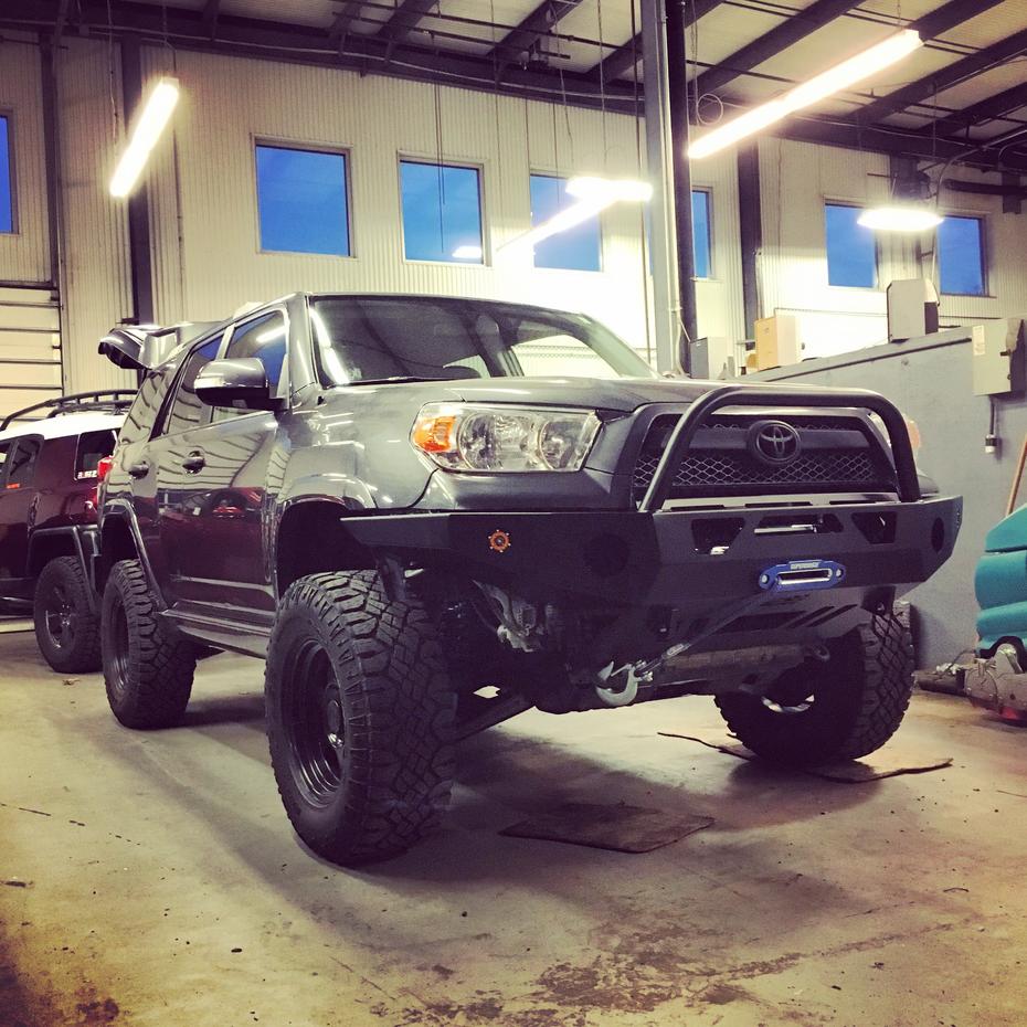

Installed my winch and bumper. Few things to tidy up.
After seeing a few other people do this... I'm curious why Toyota didn't provide a better feed from the factory? Seems like the most logical (powered) accessory would be a fridge back there, right? I might need to consider this as I mount my cooler. We'll see...
